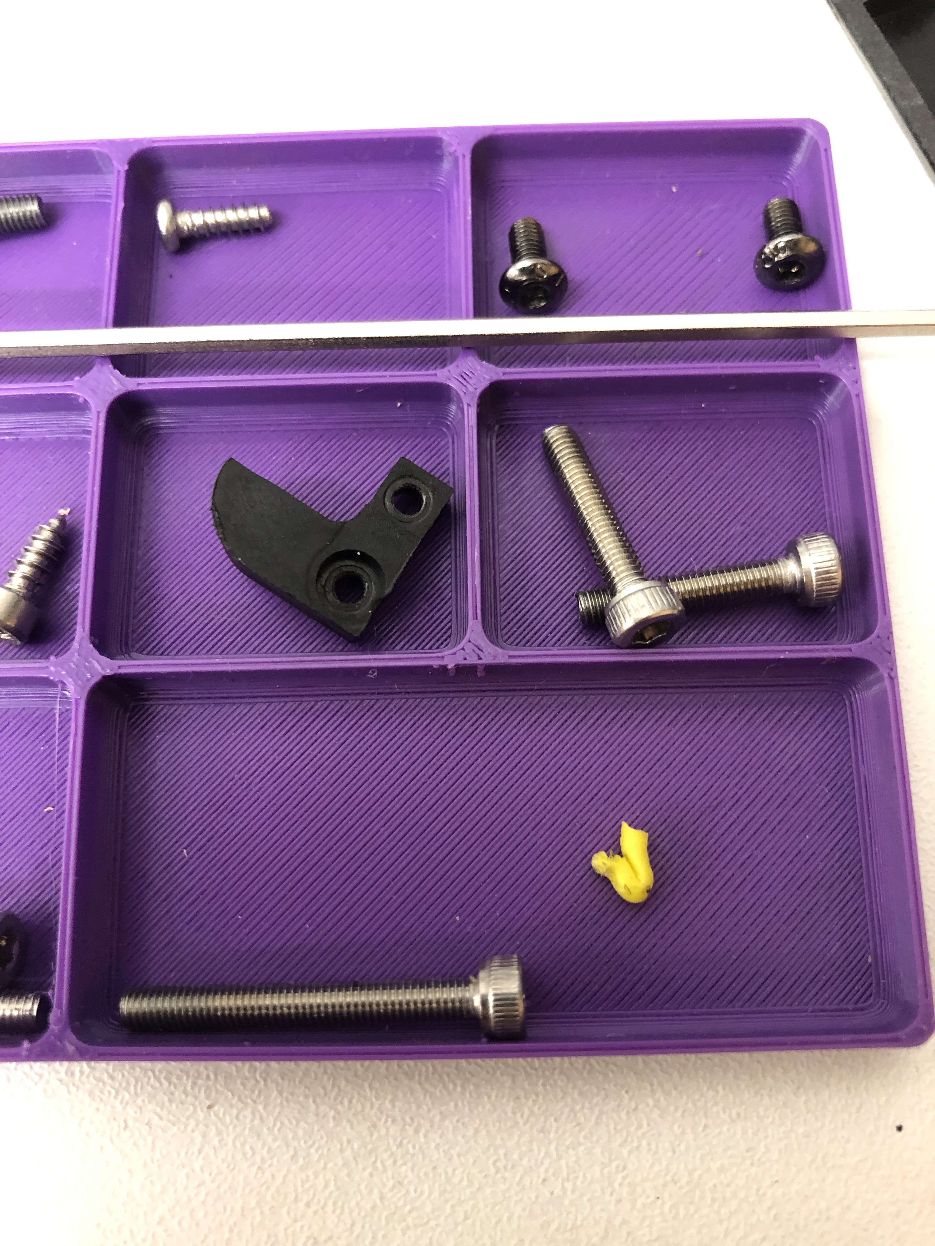

@3dtechs do you know if anyone’s successfully used this since August?
I tried it today and unless I’m doing something really wrong it seems to be struggling to load any filament, sometimes it makes a clicking sound but it still feels stuck.
Maybe something’s clogged inside but I don’t know how to check it (let alone fix it).
Clicking is an extruder issue normally blocked or jammed. I’ll be down to morrow and have a look.

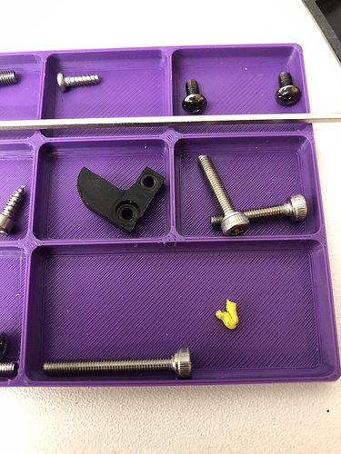

Found the issue. Should be fixed soon. Always the downside of direct drive I’ve had to disassemble the whole tool head
It was all thanks to this little bit
Thanks Sam, it wasn’t really urgent from my side but it’s helpful to have multiple printers available to do things in parallel, so I appreciate having it fixed :slight_smile:
All ok printing fine. Replaced the Bowden tube as well.
