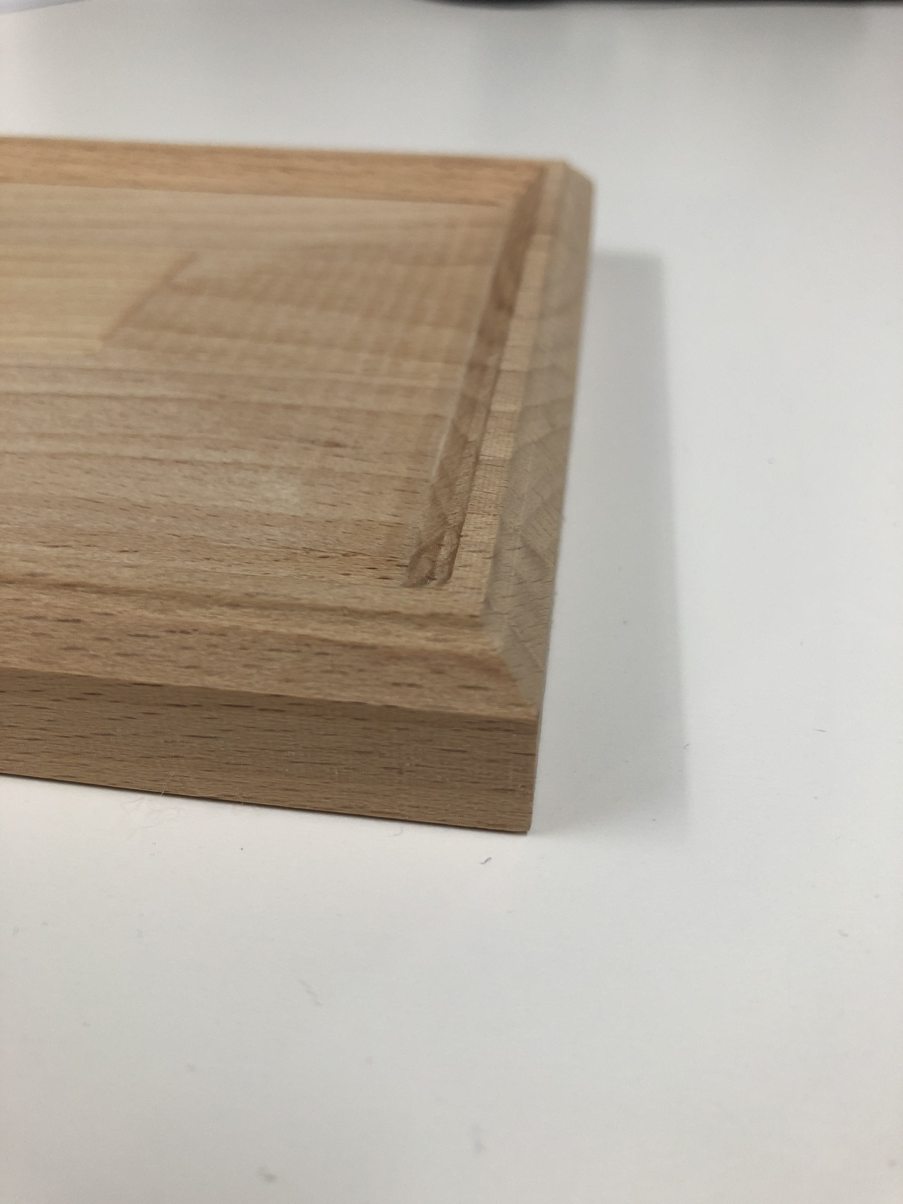

The start of the process was doing some test cuts with @Archie on the Big CNC to work out the best way to cut the custom mouldings. We weren’t initially sure which contour we would use for the moulding so we were testing curved and square corners.
We Initially looed at using a 3D carving tool path but we explored the use of the moulding specific tool path settings on V carve. This gave really nice quality results and allows you to make complex moulding shapes perpendicular to a guide rail. I tested a natural curve shape for the moulding as well as a more geometric concave shaping. These also gave great results around corners opening up some interesting opportunities for making some organically shaped mouldings. Once these tests were done I was ready to move onto the final wood stock.
