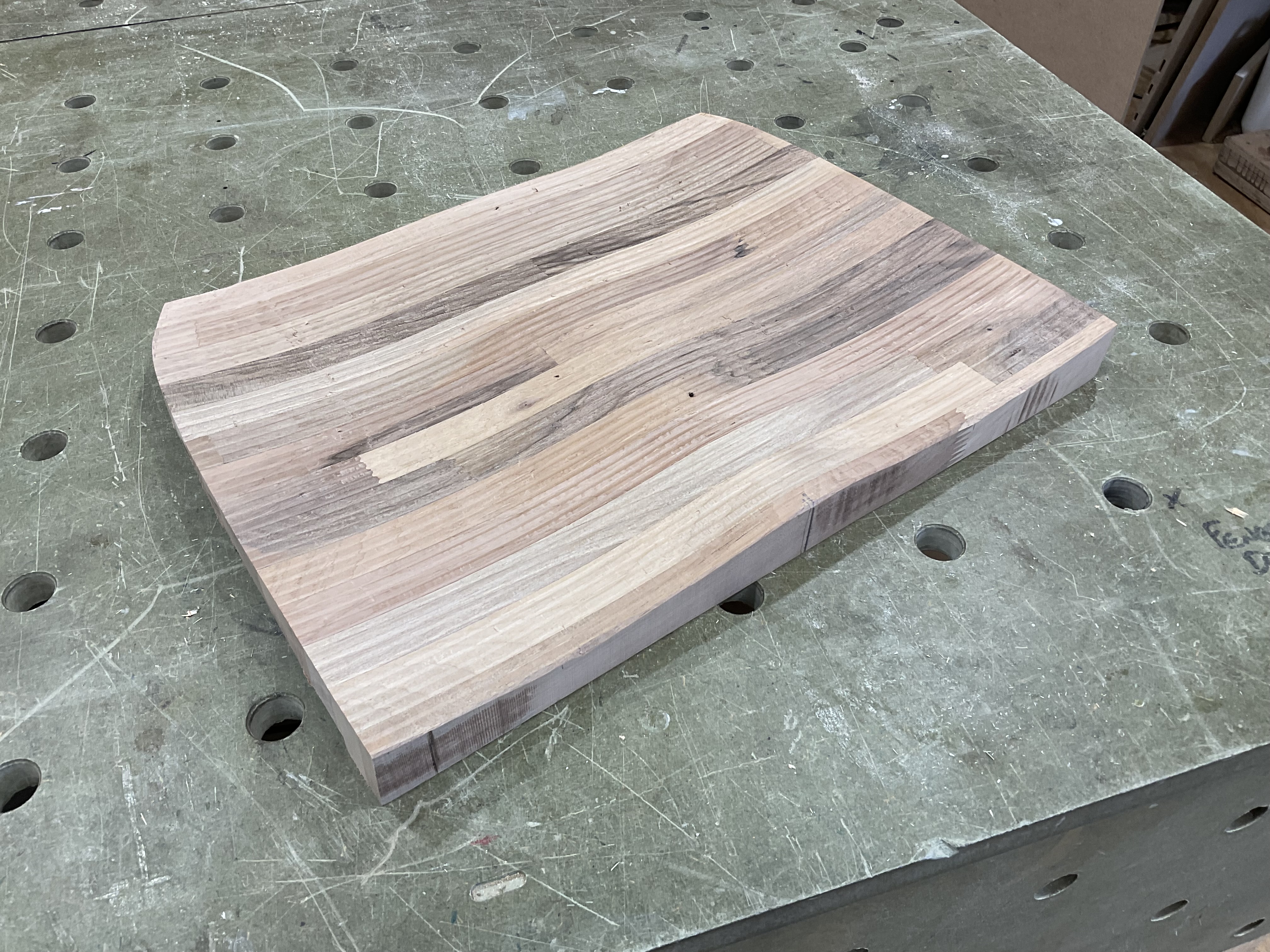

Just did a test for dishing out a seat using the big CNC. There are free stl files online that can use. Machine time is approx 1:20 for roughing and same for a finishing pass using the 8mm endmill. Results are good. It will still need some hand sanding, but the power carving gets taken care of.
Oh great! Still need to get an induction on the desktop CNC and the big one but good to know for future projects. If you have a pic of the seat would love to see how yours went!
Back in on Thursday. I’ll post pics of the test we did then - just did the roughing toolpath (clearing bulk of material, but leaving rough ridges which get smoothed out in the finishing toolpath). We decided that taking the bit of extra time to do the finishing toolpath would be better than sanding down, especially if it’s a hardwood. The test block is back in community woodpile if you are in before then.
This has had a bit of sanding/smoothing by hand, but not finishing pass on the CNC. It’s just a test using some scrap from the community bin. The 3d file is easy to adjust - can scale it in any direction, make it deeper or shallower etc.
Looks great, definitely inspired to give it a shot when inducted!
