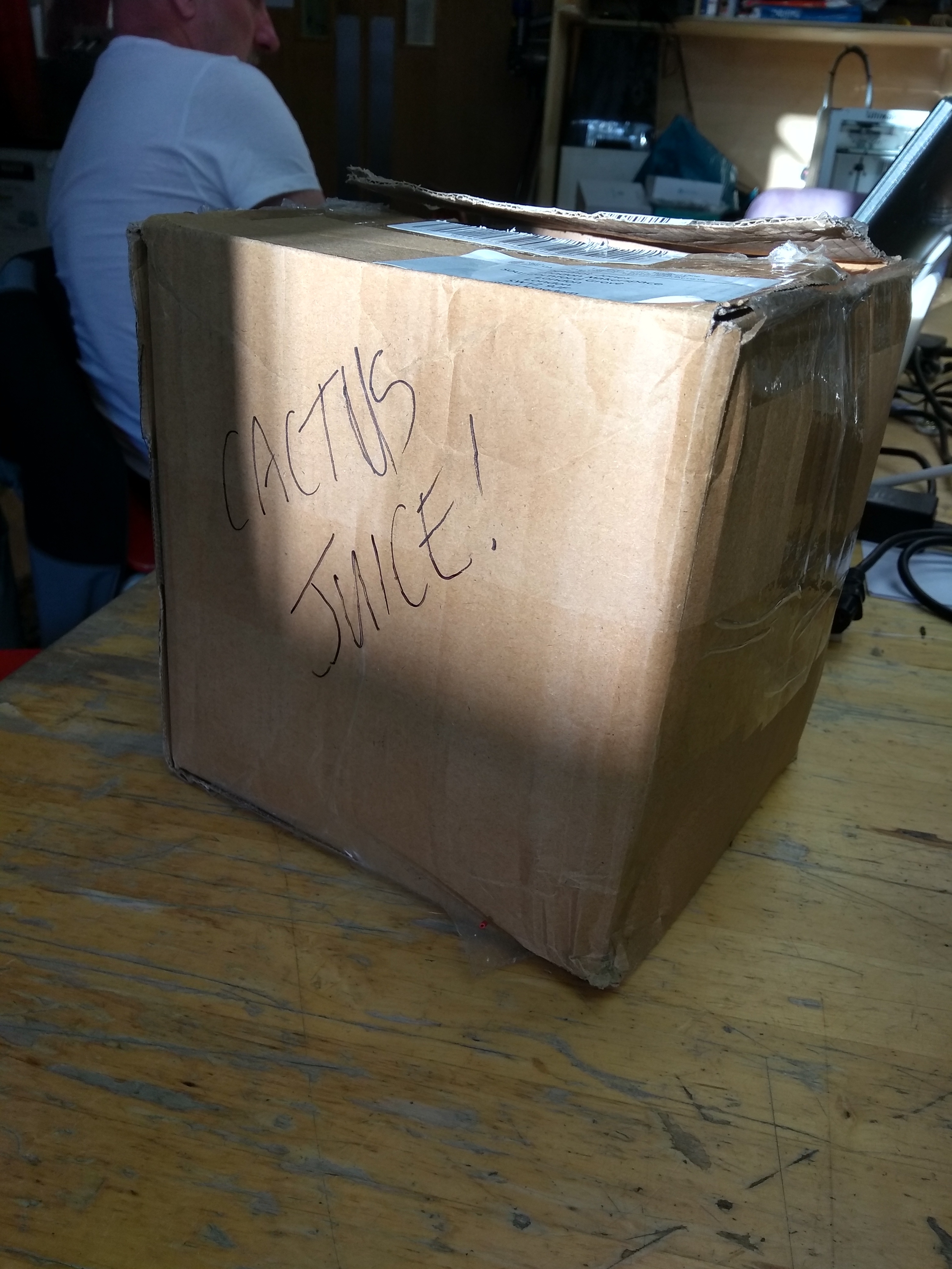

We have a working vacuum pump, so what we’ll need to get going is the resin (and perhaps some dyes depending how much we can raise), a toaster oven to dry the wood and cure the resin, a load of zip topped freezer bags for the dried wood, and a bunch of mason jars or similar to store various activated dyed resin mixed.
The resin should last us a while, given that the only resin used in the process is that which is drawn into the wood, the rest can be stored for 8-12 months and used over and over again.
So, a run down of what we need cash wise:
Cactus Juice resin 2l - £73 inc delivery.
Cactus Juice Stabilizing Dye - Various colours 59ml - £10.95 ea.
