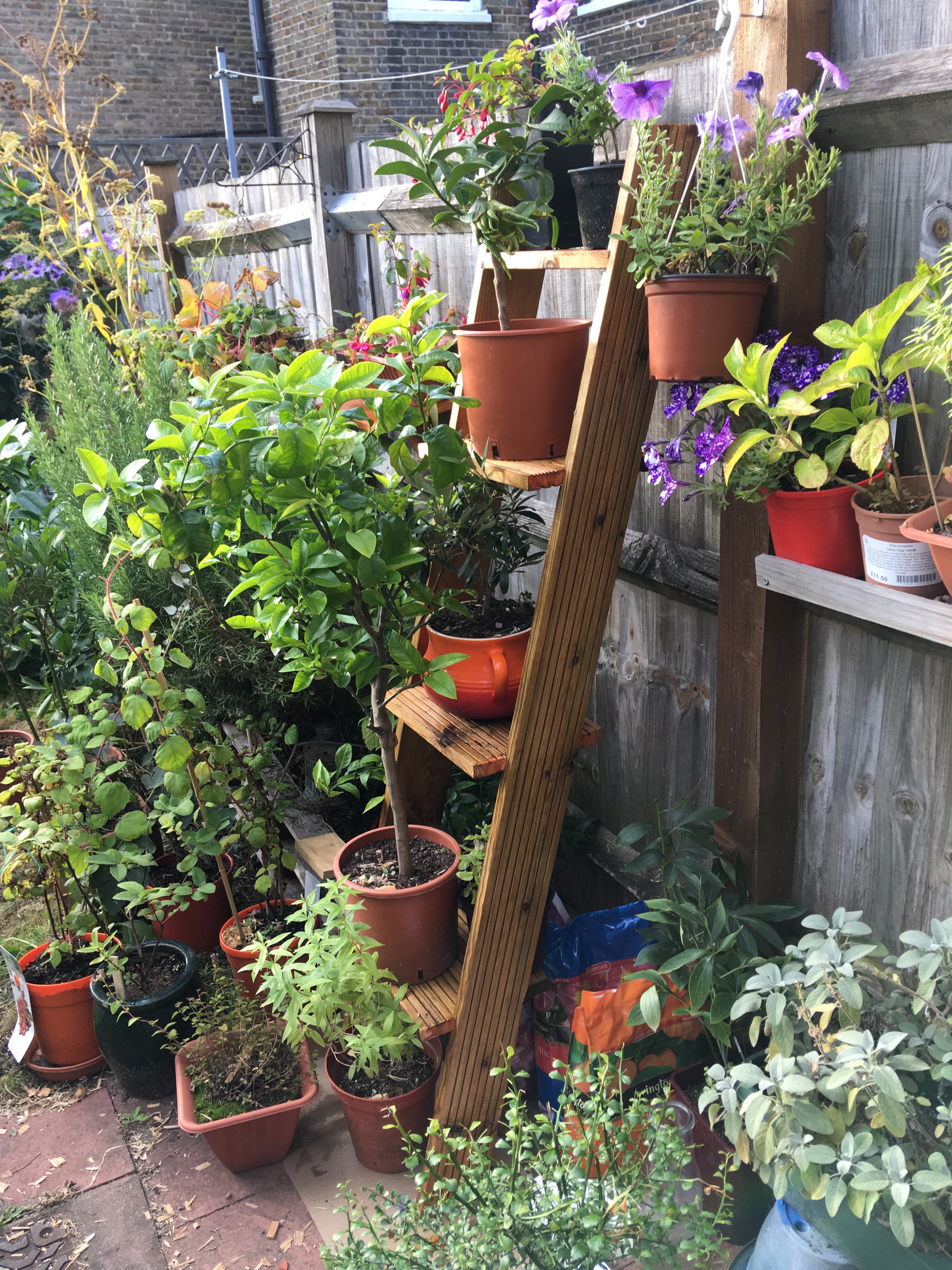

I’ve got too many plants so need to be getting vertical.

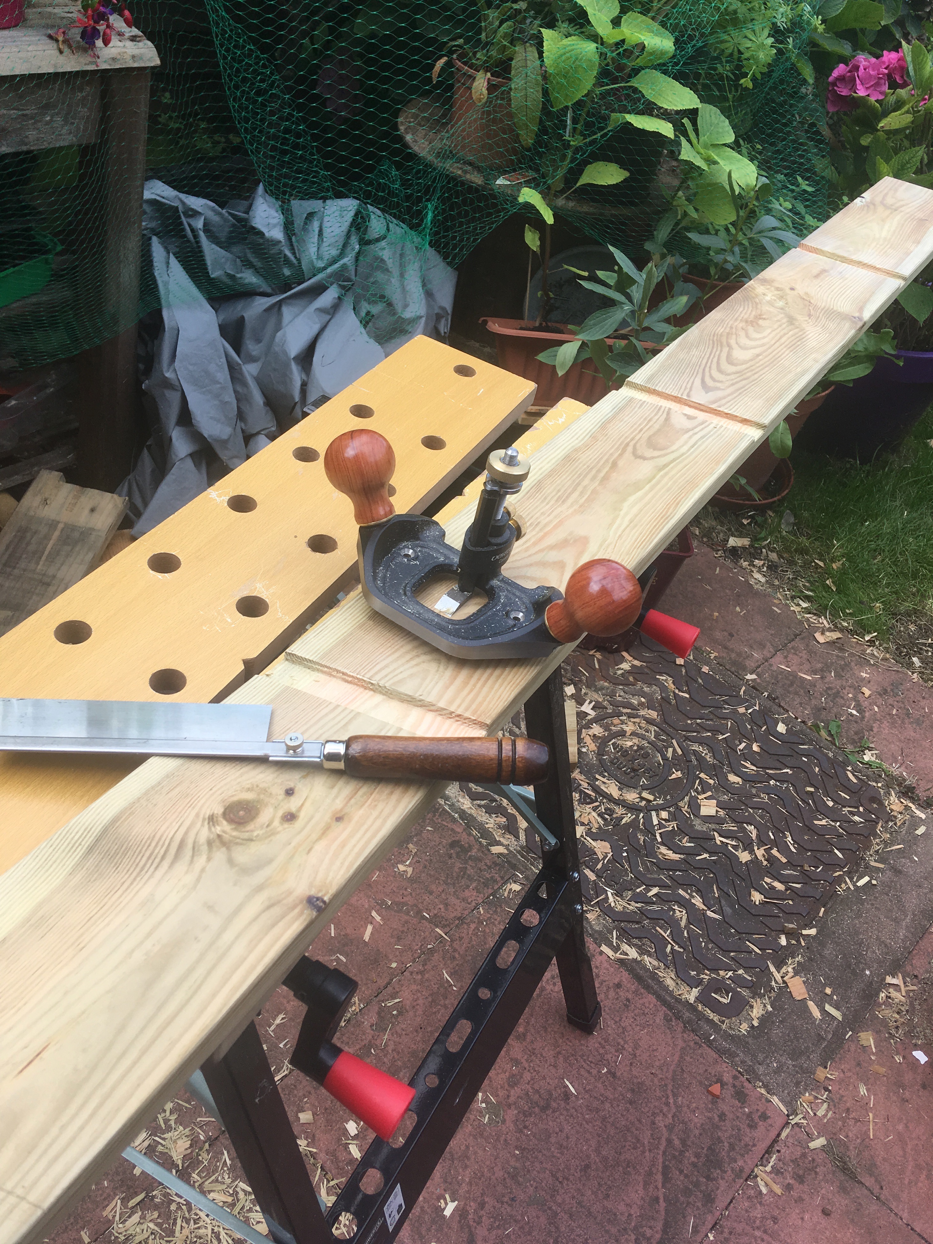

Dados cut using a saw for the sides, most of the the waste chiselled and finalised using hand router plane.

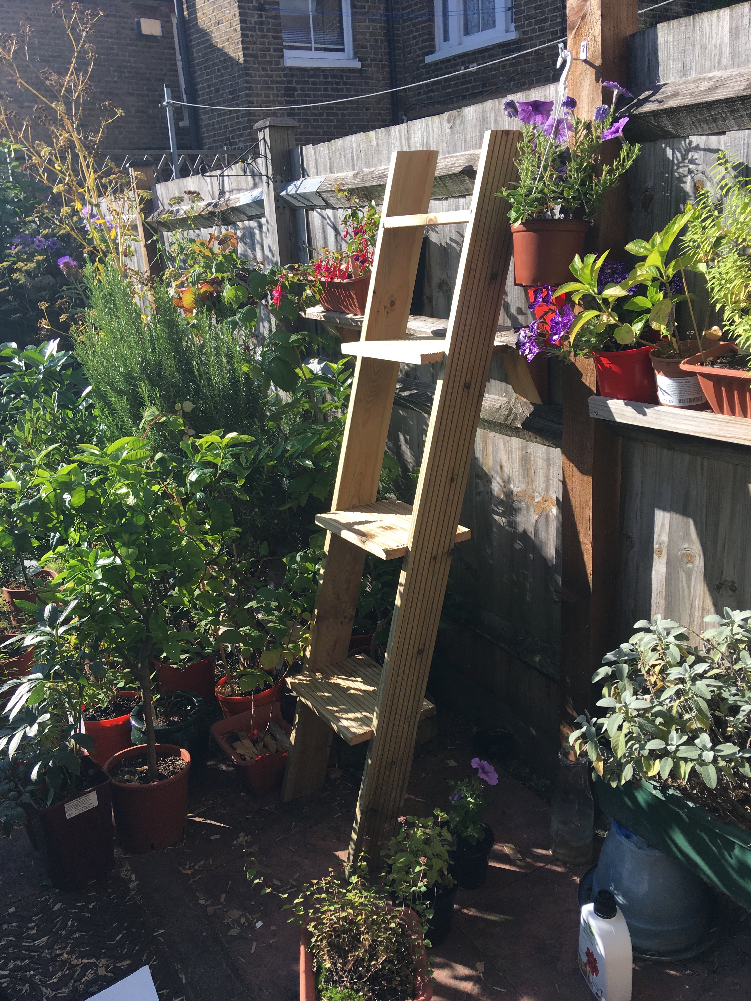

All but the top shelf are made wide by putting two pieces of decking side by side.
I sawed to length and then used a shooting board to square them off and the fine tune the length. It all slotted together for a dry fit.

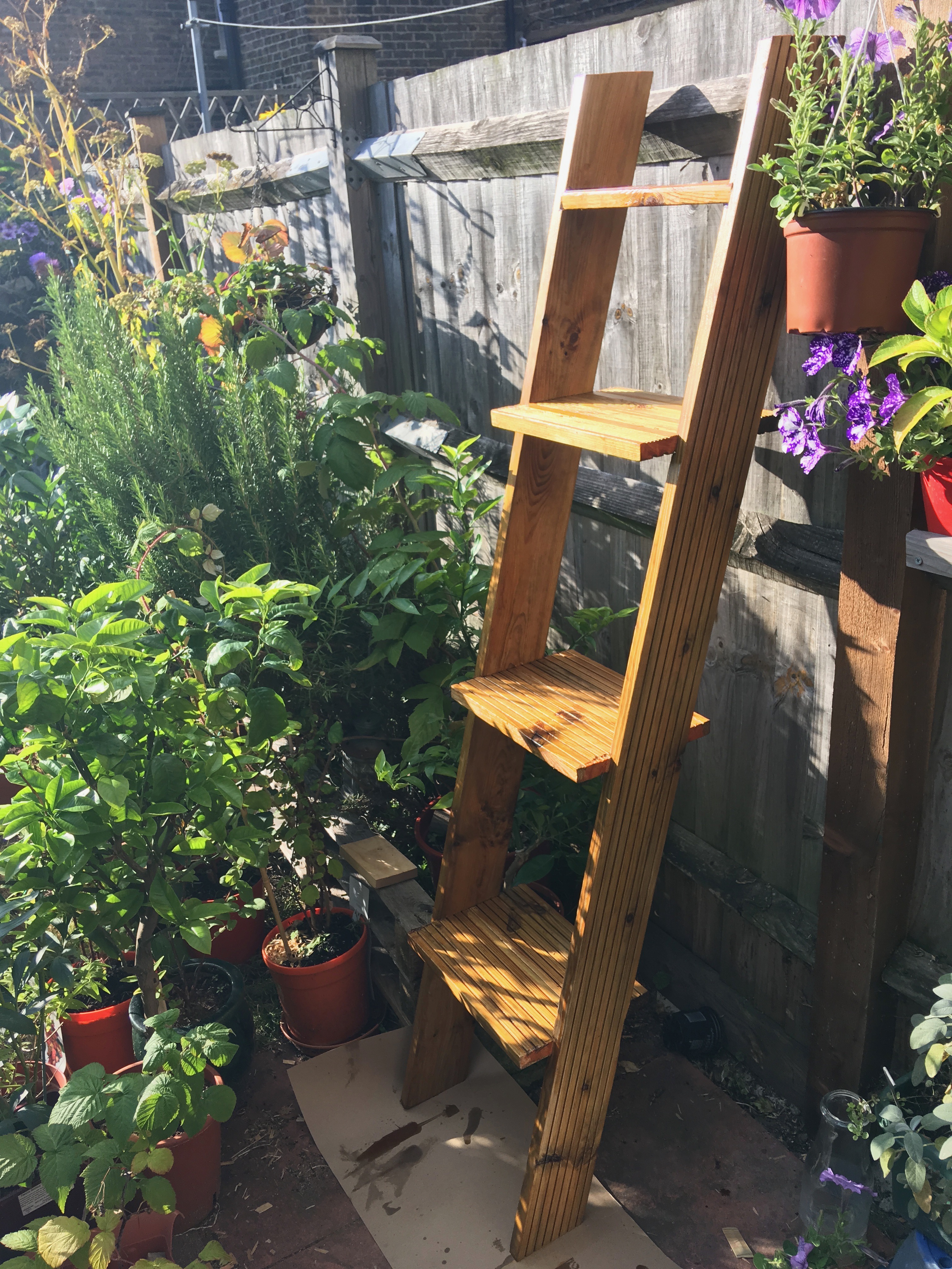

Main problem is keeping it all square while I glued it. I’ve only got one clamp long enough to clamp across, so did one shelf at a time and went blackberry picking in between.
A few coats of outdoor wood stain and voila.
