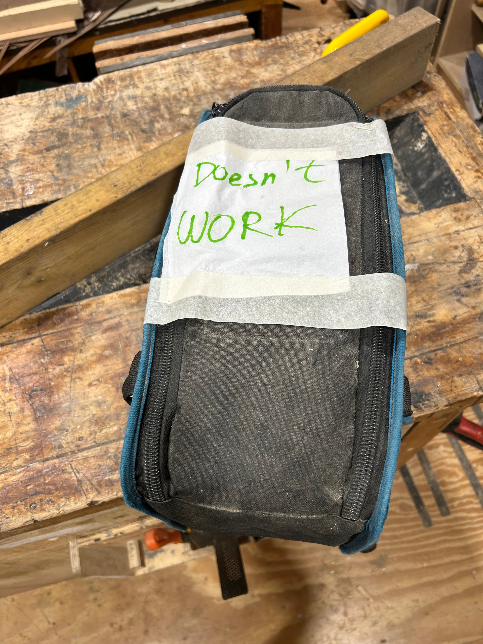

I found the orbital sander today with this sign on it.
Not sure how long it has been out of service.
Please if you find anything not working in the woodshop please post on discourse and tag the @woodtechs
Things will
Not get repaired/ replaced if we don’t know about it

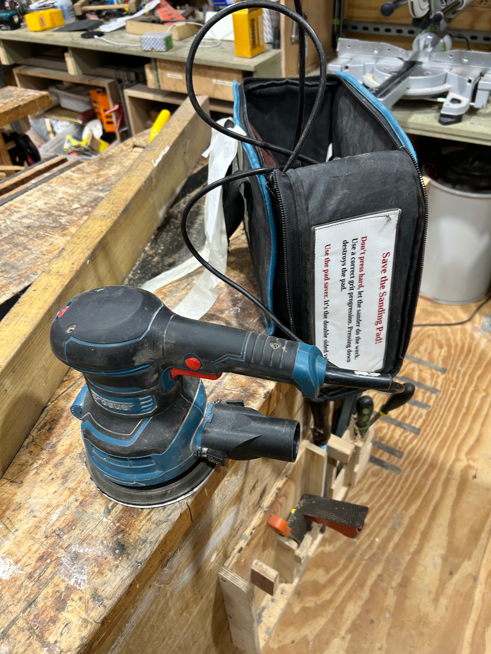

Hi, :smiley: Me and Daniel saw this earlier in the week , plugged it in and it worked fine so the only question me and Daniel have is what is not working on it ???
It is intermittent, I suspect the brushes have gone, but I didn’t have time to look at it
Does anyone know if this has been fixed yet?
I just checked it now and not working. @woodtechs — how do we get this fixed? Happy to help if I can.
I’ve just been reading up - mark reckoned it was the brushes (annoyingly they claim those aren’t user serviceable so it’s not something we can pop open and check easily).
I’m ordering a batch of spares for the hand tools this week, I’ll include some aftermarket brushes for that sander and faultfind it properly this weekend.
