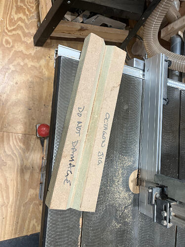

We have a jig to hold the piece at a 45 degree angle while you plane it. The jig might be too short for you but it is trivial to make a longer one.
