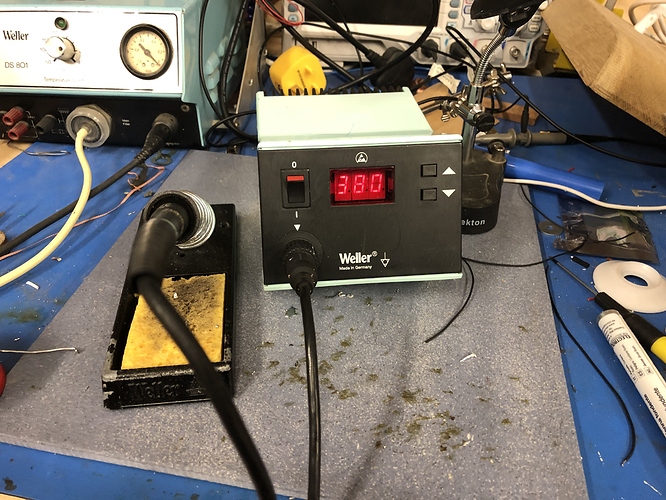

Given the last few months of conversations about the soldering irons, I do believe the Hakki’s are not really up for the constant use and the Antex lasted a couple of weeks. I am hoping it’s not that we are abusing them too much !!
Either way I took the decision to invest in a commercial quality iron (albeit second hand) to see how we go.
The Weller is a professional level setup and the iron is the WSP-80 which is the professional pencil iron with a hugely powerful element.
Please don’t wind the temperature up too high, give the iron a go at the 380c ish mark and I think you will be happy.
The iron also has a power down feature if it’s left alone for 90 minutes. To reset, cycle the power.
