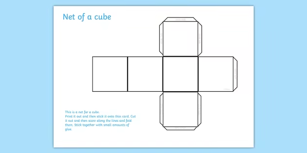

Net as in the net of a geometric 3D shape eg a cube or square based pyramid folded out into a 2D plane
I think she means like this, you could likely do this manually on something like sketchup, by making the finished shape you want, then “unfolding” the various faces by rotating them around the edges where they join eachother image
The issue I have is I need the 3D shape as my final product and I already have the 2D net. For things like cubes or pyramids this is easy but I have more complicated shapes to create as well
