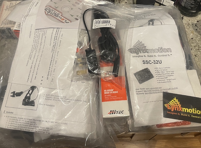

Funny you should mentioned this, I’ve just bought a https://uk.robotshop.com/products/lynxmotion-al5d-4-degrees-of-freedom-robotic-arm-combo-kit-no-software
This arrived today from the robot shop
