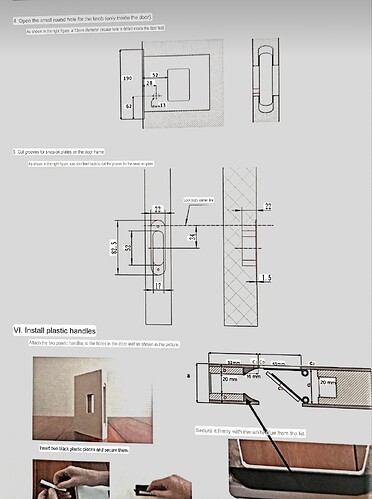

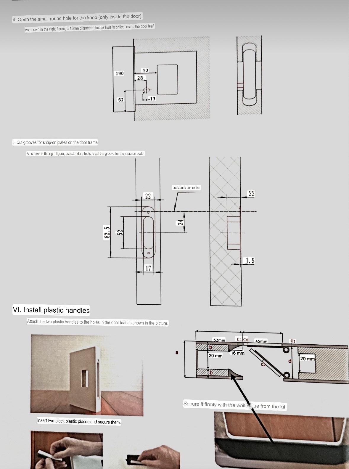

The manual requires:
  • a long mortise (~130mm) in the door edge
  • a front cut-out (approx. 45x87mm)
  • a T-shaped internal cavity that apparently needs a “special tool” according to the manual
The issue is that there’s no jig or template provided, and the manufacturer just mentions a “special tool” without any details.
My carpenter is comfortable doing standard mortises with a router/jig, but this specific internal shape is the tricky part. He mentioned that this could be done with a CNC machine though.
My questions are:
  • Has anyone installed this type of invisible handle & lock before?
  • Is there a universal jig or tool that works for these?
  • How would you approach the T-shaped cavity ?
