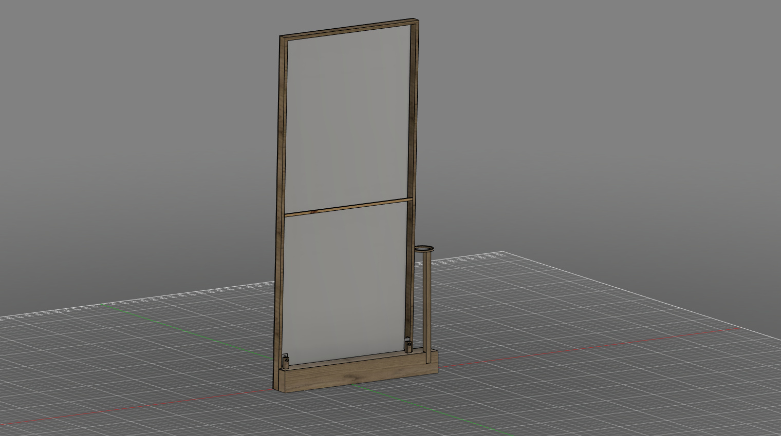

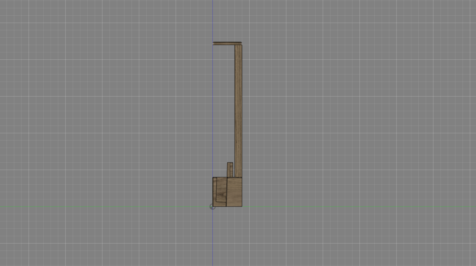

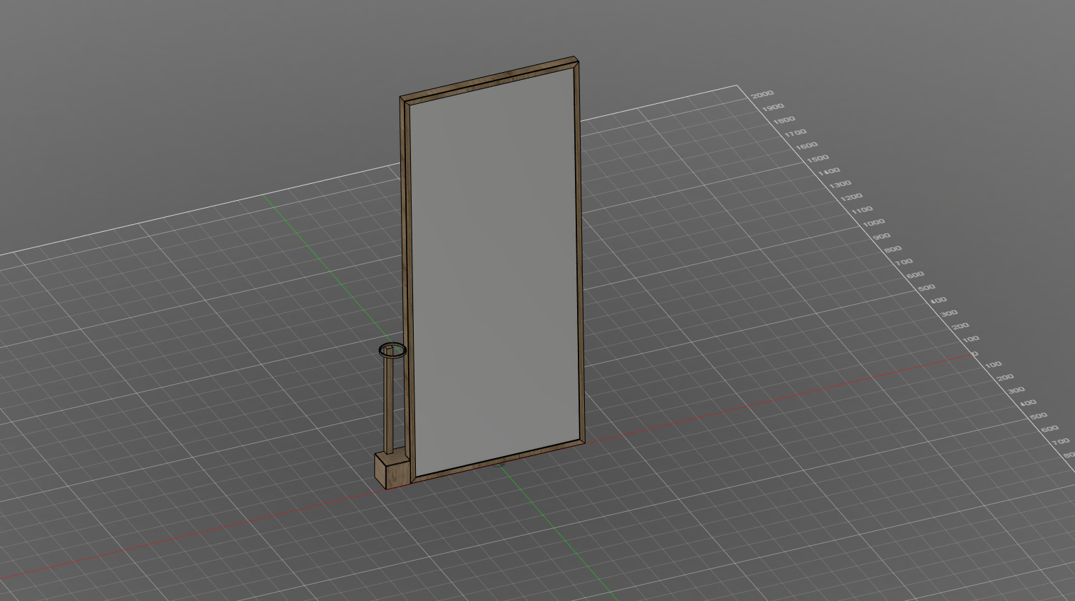

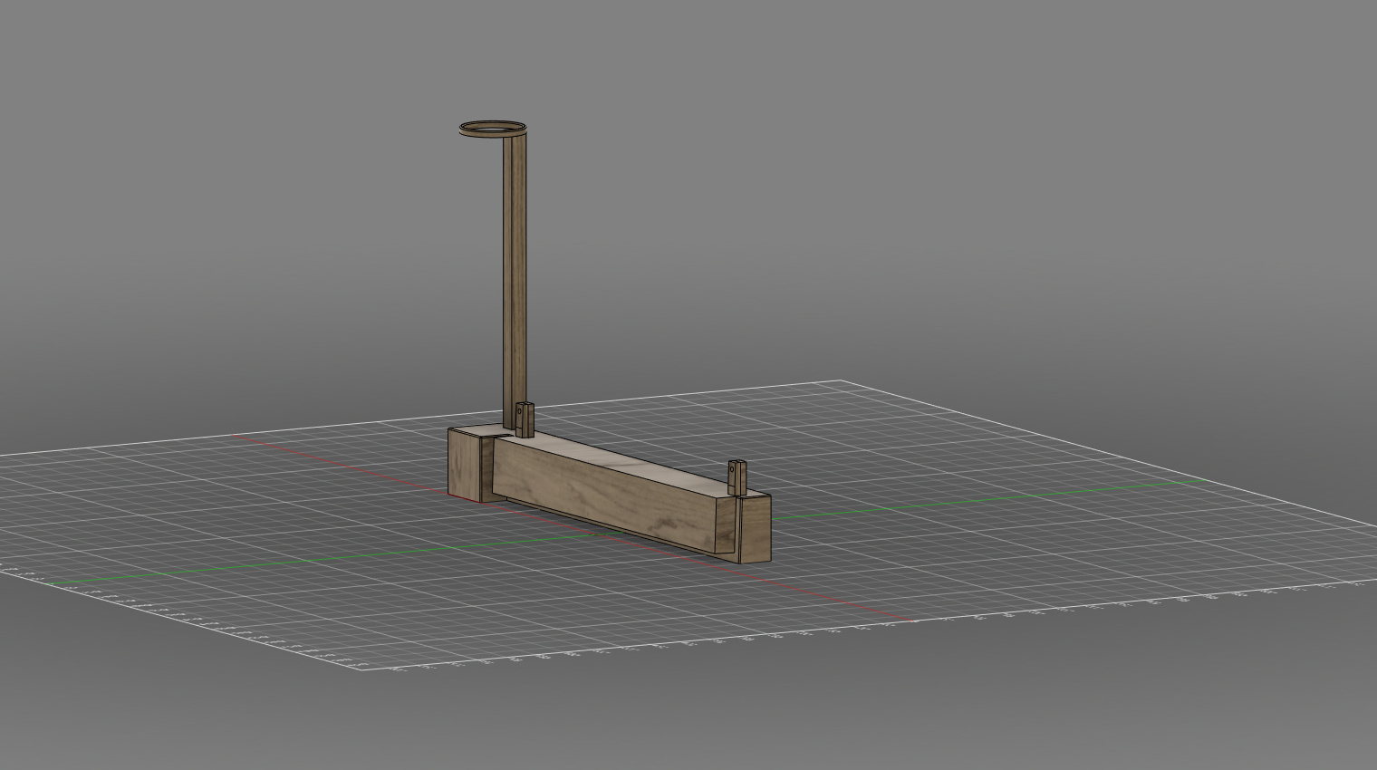

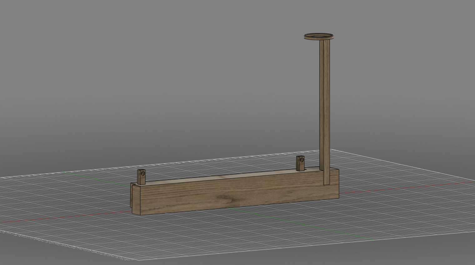

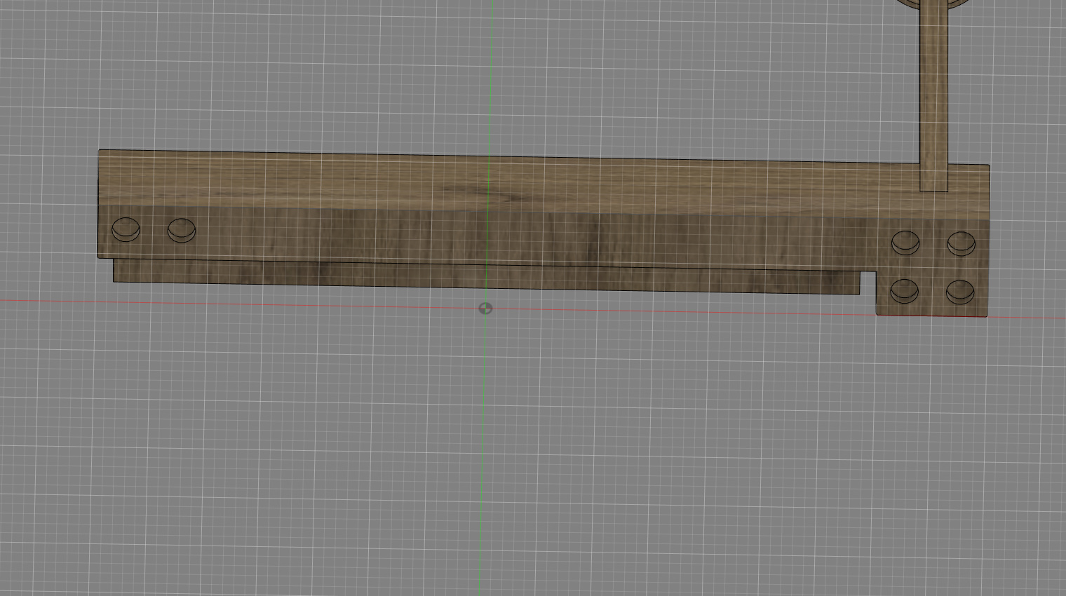

First time using Fusion 360, but here are some pictures of the design:
I have a few questions:
1 - I was hoping to use a single solid (and heavy) piece for the base. It’s designed at 100mmx100mm but not sure this is easily available from places like SLHardwoods? It’s basically the size of a fencepost, but not sure construction-grade timber is what I want to use. Any suggestions? Both for where to buy and which wood might work best?
2 - For the holes in the base I want to place some sort of rubbery cylinders to act as grip, but can’t seem to find anything like what I want online, googling for anti-slip rubber feet inserts just returns cheap looking screw-in feet (rather than “inserts”). Any thoughts?
3 - the stand is designed to have the mirror leaning backwards (so the top of the mirror will touch the wall, as will the back of the base of the stand. Therefore the cutouts will need to be at a tiny bit of an angle (1.9 degrees ish). Any tips on creating these to a reasonable level of precision?
Any other feedback is welcome - this is my first time using CAD.
