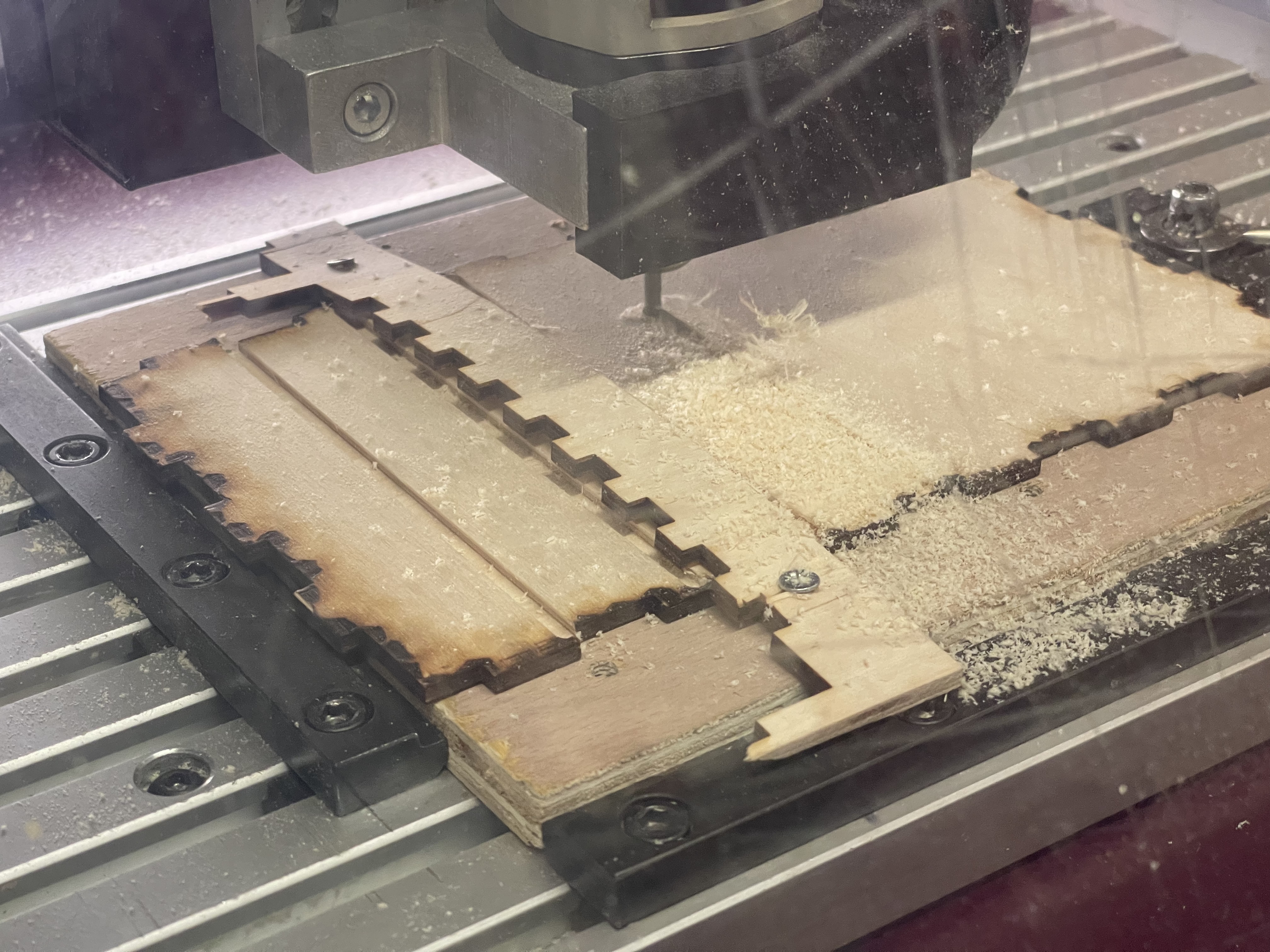

Success!
lol! Did u screw in?!

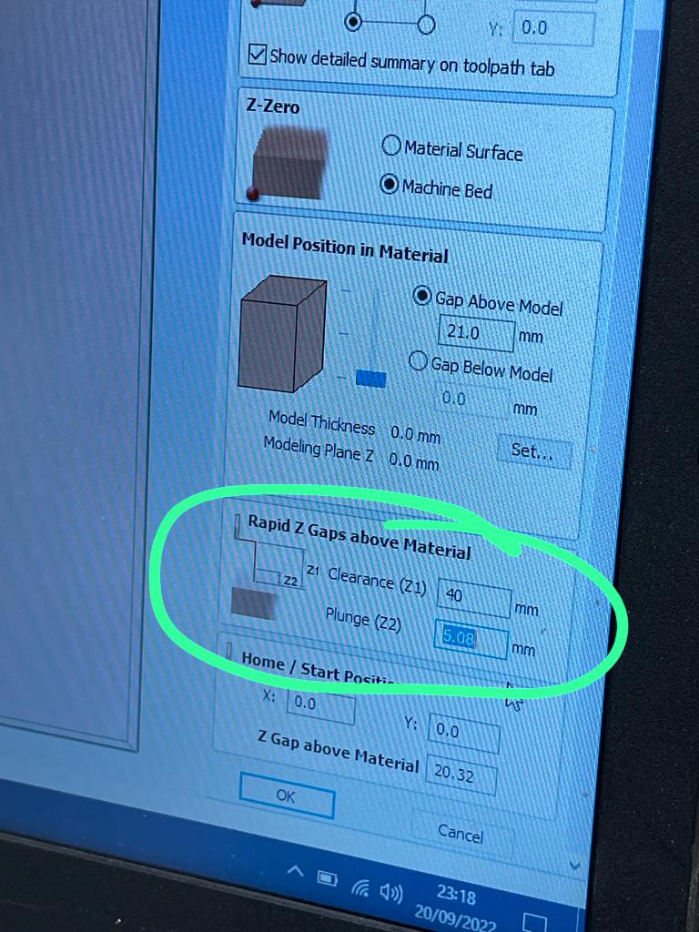

I don’t think I’ve ever seen that before! I guess that top brace thingie is thinner than the clearance? How do u set that in VCarve actually?
Its basically strapped down with a scrap of laser ply… so the screws are just in that, not the actual project stock…
Worked great! The default clearance was enough… but you can change it…
You can set the clearance in VCarve using “Rapid Z Gaps above Material” in the material settings, this is 100% needed on the Big CNC because the clamps are so high…
