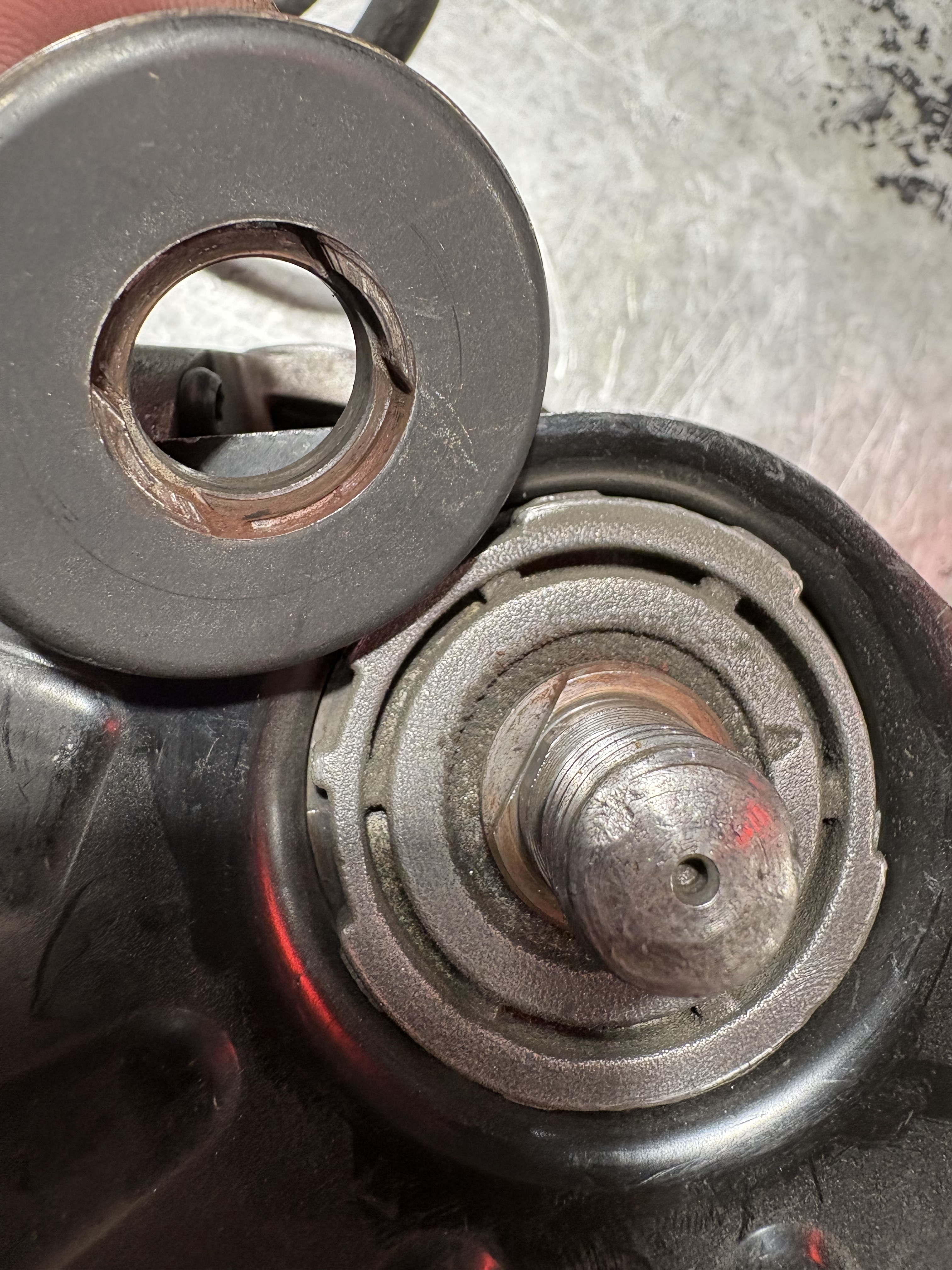

In addition I have a request; could we replace the inner ring in my picture? It’s undersize and this lets grinding discs vibrate and wobble in a mildly terrifying manner.
I’ll have a look at that as well this evening and get back to you Ben. Odd. That washer (ring) is made for that grinder. It has flats and goes on in one particular orientation. If it’s not fitted correctly it will wobble and makes the grinder very dangerous. Thanks for doing the right thing and mentioning it. :+1:

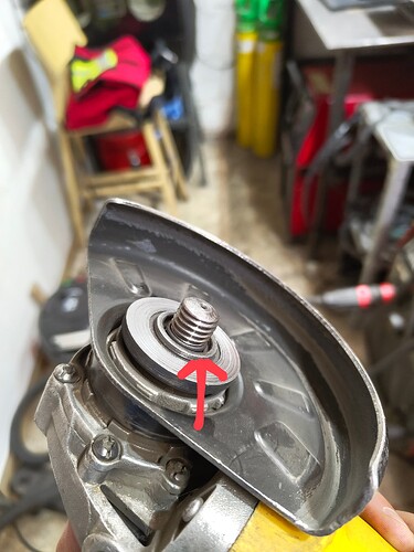

Have checked the grinder and its washer @Afro_ben . That is the correct part. See the picture. There are two flats on the washer that locate on the spindle. They need to be properly seated. I think this is why you might have struggled. Don’t hesitate to reach out should you have further difficulties.
Or maybe put the locking nut on upside down?
