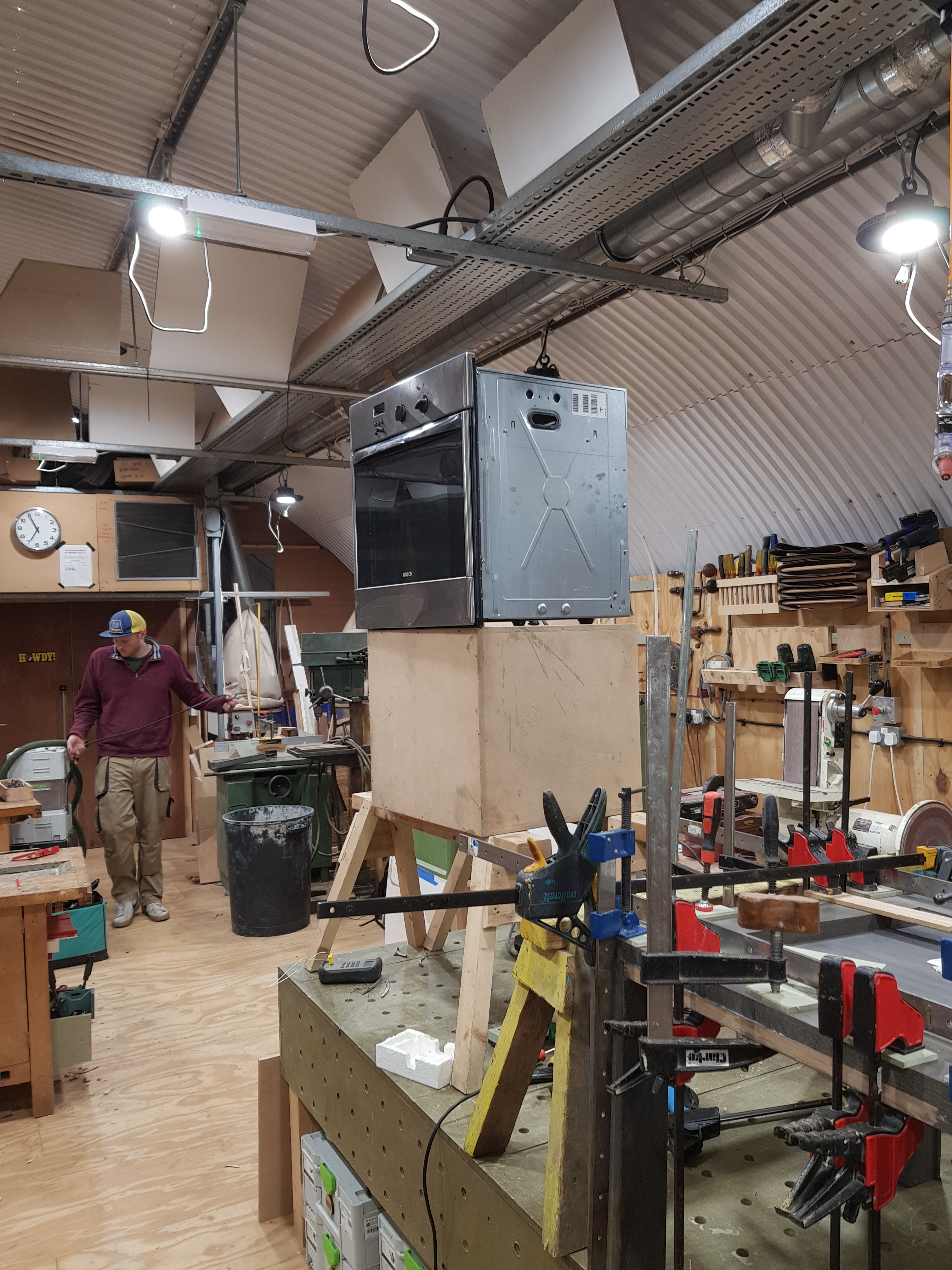

315mm duct set at a height that allows it to pass over the top of the table saw extraction with a five millimeter clearance.

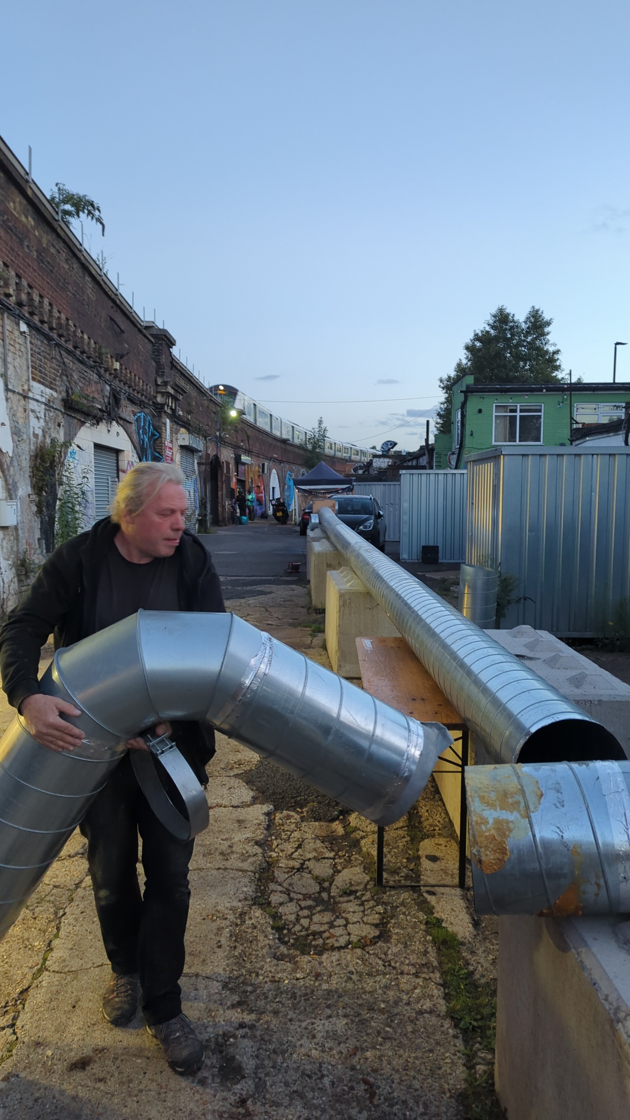

PXL_20231015_140830374_exported_stabilized_1697387785392
This is how it happened. Haha.
Is Joe picking up a knife?!!
Am I smiling?

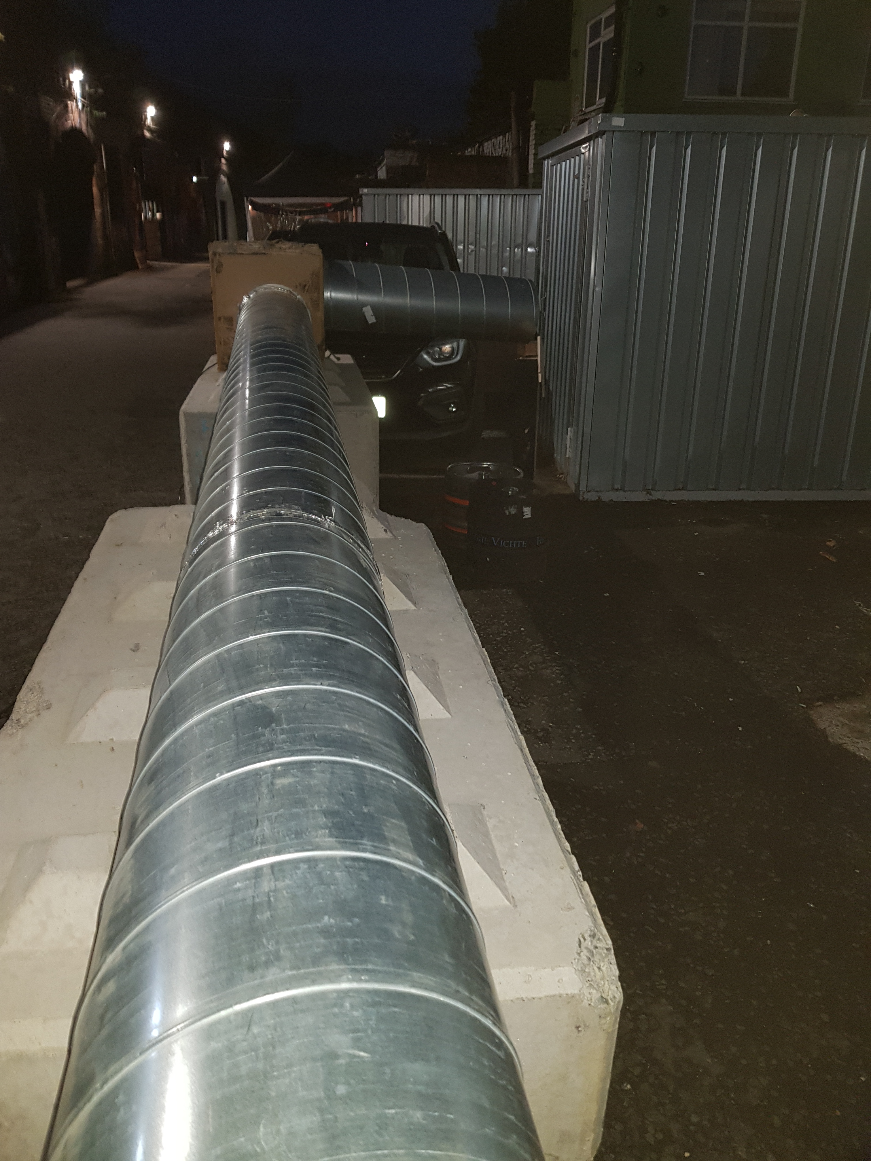

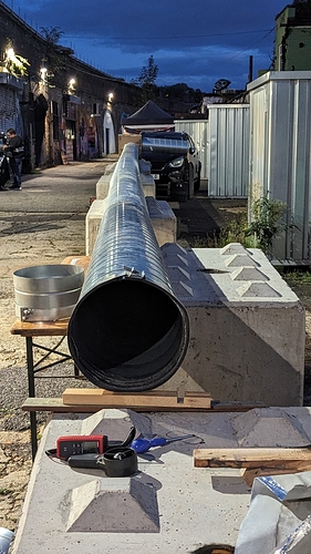

Done
Very nice, I’ll be in with the acoustic vinyl today ~6

Those outdoor shots of the extraction trunking are putting me in mind of Gerald Bull’s infamous ‘Iraqi Supergun’, (a small part of which was, for a time, on show in Woolwich…).
I guess I’m just odd like that.
(Oh, and it appears to be aimed at the Houses of Parliament…)

Yes! Thanks @metaltechs and @directors for coming together - and extra thanks to @joeatkin2, @Kyle and @scythian for the installation!
