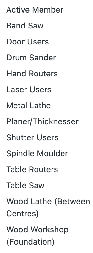

Hi @metaltechs, had an issue with tagging into the general TC in the metal shop yesterday. Someone was tagged into the top left fob, I scanned mine to tag them out and got permission denied (with my name flashing up). I have my basic lathe induction, I think this means I should have basic permissions? My fob worked as usual on other TC nodes.

Basic metalshop has been added as an induction recently. If the metaltechs have seen you practicing the key skills in the past you should be good to be marked as allowed without an induction. That’s up to the grown ups through
Yep, so as @Destom said you need to have the general metal workshop access to operate it, but also theres a bug which means even if you do, you can’t log out someone else at the moment.
Your current permissions:
Cheers both, I’ll leave it to the grown ups and take whatever inductions they suggest :+1:
