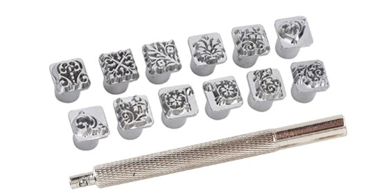

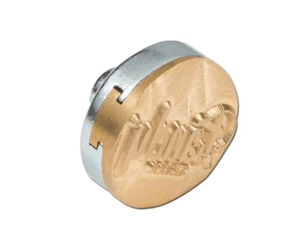

Head of stamp example 2 metal head
Body and alternative head of stamp example

The stamp body needs to be made of steel as the hammering the leather needs a significant amount of hammering force, @federico says the cnc can handle steel but takes a long time. The first example is a 2 metal head with a T interlocking shape @stefanoromano can any of the metal shop machines help in creating that interlocking mechanism so we could just make the face of the stamp on the cnc machine

Regarding the interlocking mechanism, i went for a threaded end of the stamp.
I’ve also used a tool for an undercut ( a t-slot) on a brass holder, be aware this is an advanced cut so make sure you are comfortable in every step of the process or ask for tech assistance.
