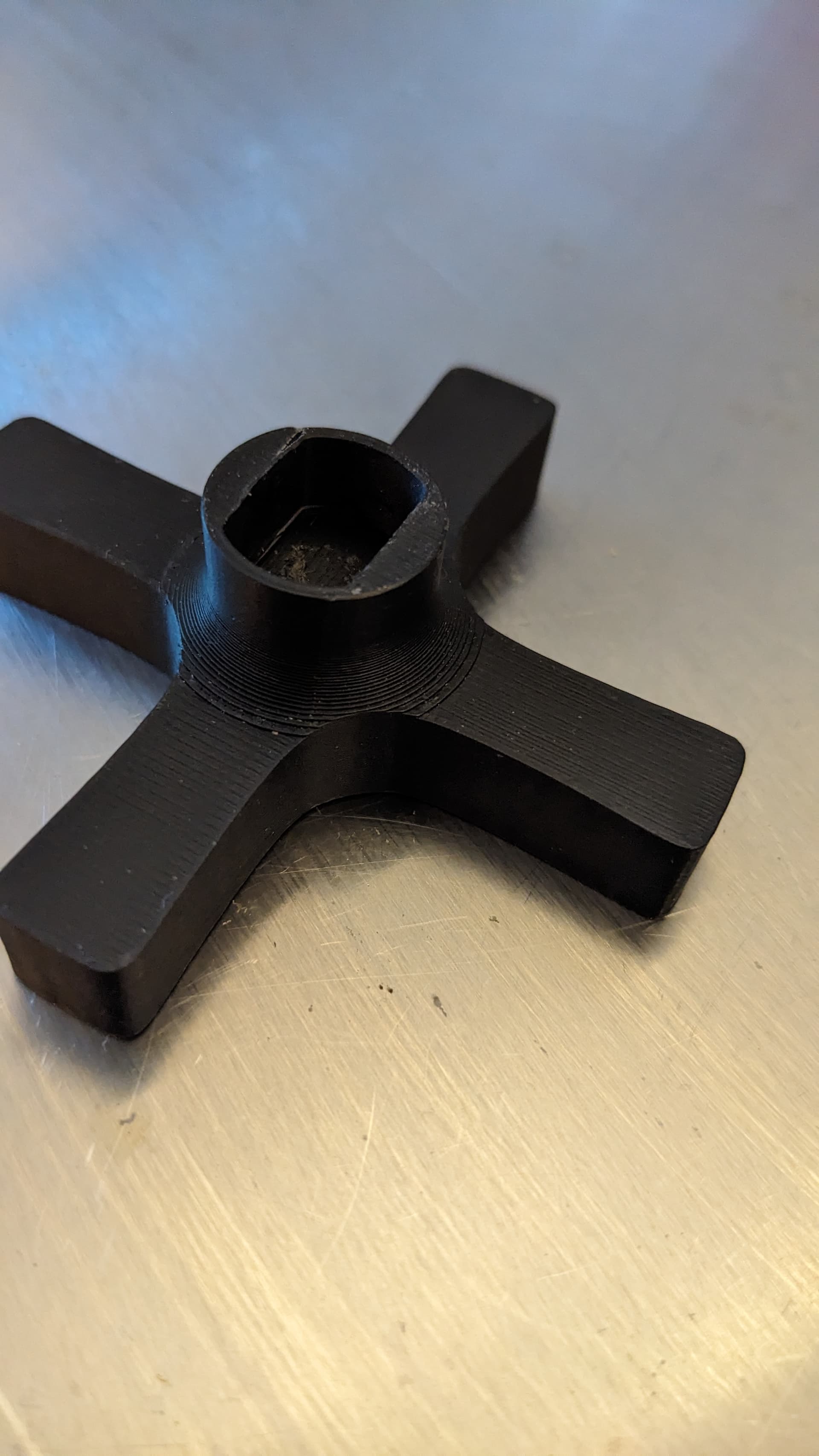

This is the very not complicated piece I printed. It is a tap handle replacement!

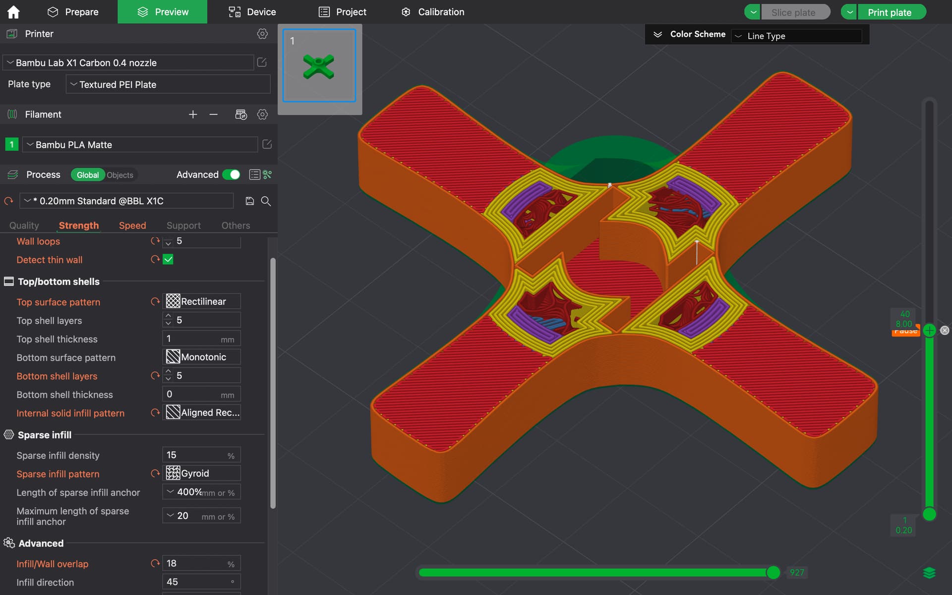

Thicken up the diameter surrounding the mounting hole, make it 4-5mm and set the print settings to like 8-12 perimeter layers. This should stop it from cracking open, but the plastic might still squish at the corners until its rounded.
If you’re going to order single tap from a metal printing service you’re gonna cry at the price :sob:. One offs going to be at least 80, if not hundreds. (You can look up metal printing on Pcbway or jlcpcb. Anything from Europe is going to be 300+; we’re really awful at manufacturing services.)
Would recommend reprinting or finding a replacement online. (I would be leaning towards replacement if it were me.)

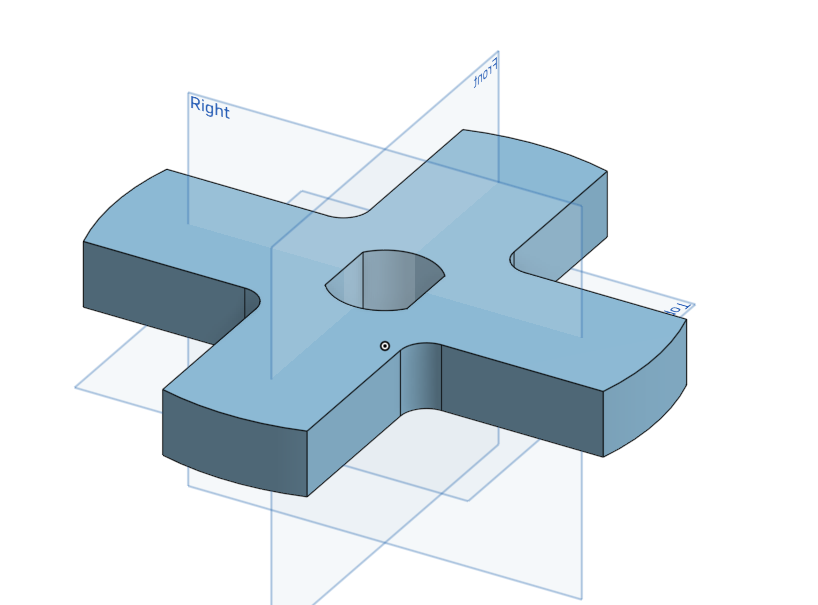

If you don’t need the clearance, you could simplify the part. It would increase the walls making it stronger in PLA and making it easier to manufacture. You could also laser cut, or CNC this from other materials.
Something like this where the hole goes all (or most of) the way through:

:thinking: what if try printing with polycarbonate and then press fit a metal insert?
As already mentioned…increase the diameter of the collar part and (depending on size) make the outer diameter 15 or 22mm to suit a compression olive for copper pipe. Print in PETG @ 100% Fill. Then press on the olive, which will stop it splitting. 100% fill will stop the tap part distorting the plastic within itself.Or if no olives, add decent 45 Degree buttresses and try that. Depending what it is (?an irreplaceable antique tap??) you can achieve a convincing metallic finish using a nickel electrical shielding spray. It stick very well (designed for shielding electronics in plastic boxes) and conducts well enough to electroplate the finished article.

My advice is introduce a clamping system the failure happen due to the push fit approach who will work fine with metal but will be weak with softer material (beware metal printing material might not be sufficient)
Like other have said increase the thickness or use Hugo idea and add something similar to a hose clamp clamp systems around a tap to help at DuckDuckGo

I re-designed and re-sliced the piece to include some of the suggestions. In particular, I added spaces and pause to include a metal insert. I will reprint and assess how/whre it distorts.
The additional clamp is also a great suggestion, as the piece -for context- would clamp on a manually-filed part of a cylindrical broken tap ending (that I usually open with a No.10 wrench).

Good setting to increase the wall number, little tips for strength Gyroid will be good for even surface pressure but less good at 15% on localized area even at higher infill it’s not that great for functional part from my experience. I’ll pick rectilinear pattern over 40% infill.
