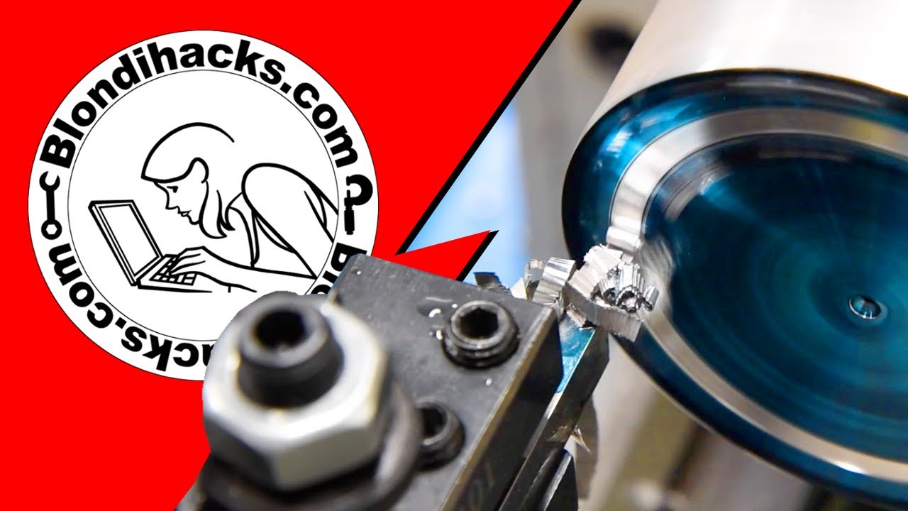

Trepanning might be the operation you are looking for? You’d need to make / buy a specific tool for it though:
Thanks for all the advice. Trepanning looks like a good idea. However, making the treppaning tool seems quite difficult. As for buying, they are expensive and there are a lot of different ones, so ti would be difficult to know which to buy.

Trapaning is the least wasteful in terms of stock, but it is also quite a tricky operation, usually not suggested for beginners.
You are welcome to try, but I would recommend extra caution, maybe do it when a tech is present to have another set of eyes on the workpiece.
Also, we don’t have a trapaning tool in our arsenal.
