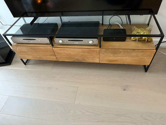

I want to make a small coffee table (55x55cm), and ideally it needs to coordinate well with my tv stand which is made from mango wood (please see attached).
I want to do this ASAP (within a few days), but sourcing planed mango wood is super difficult.
Does anyone know if I can pick any other hardwood and just stain it with something specific?

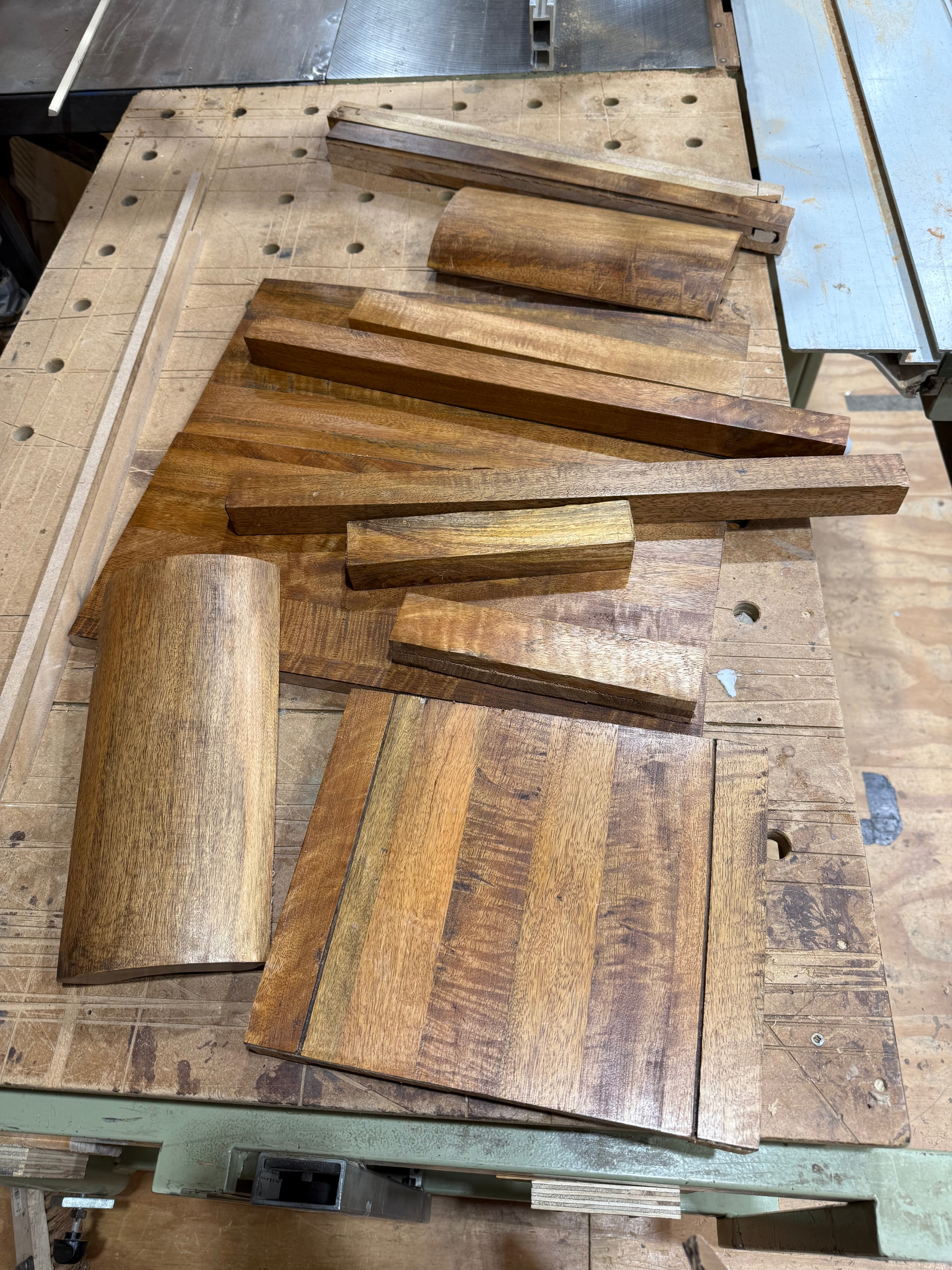

Update: mango veneer turned out to be a even rarer beast to find, but after my search I stumbled onto these bad boys made of mango wood on eBay:
Picked these up yesterday evening for about 1/5 of what timber would cost me :grinning_face_with_smiling_eyes:
Made a mistake of showing these to my girlfriend and now it looks like I absolutely have to save at least the little one :sweat_smile:
Will try to cut the big one along the black lines and see if I can quickly turn it into my own table!

Thanks! It turned out to be infested with nails though, so I had to use hand tools to dismantle it all the way! :sweat_smile:

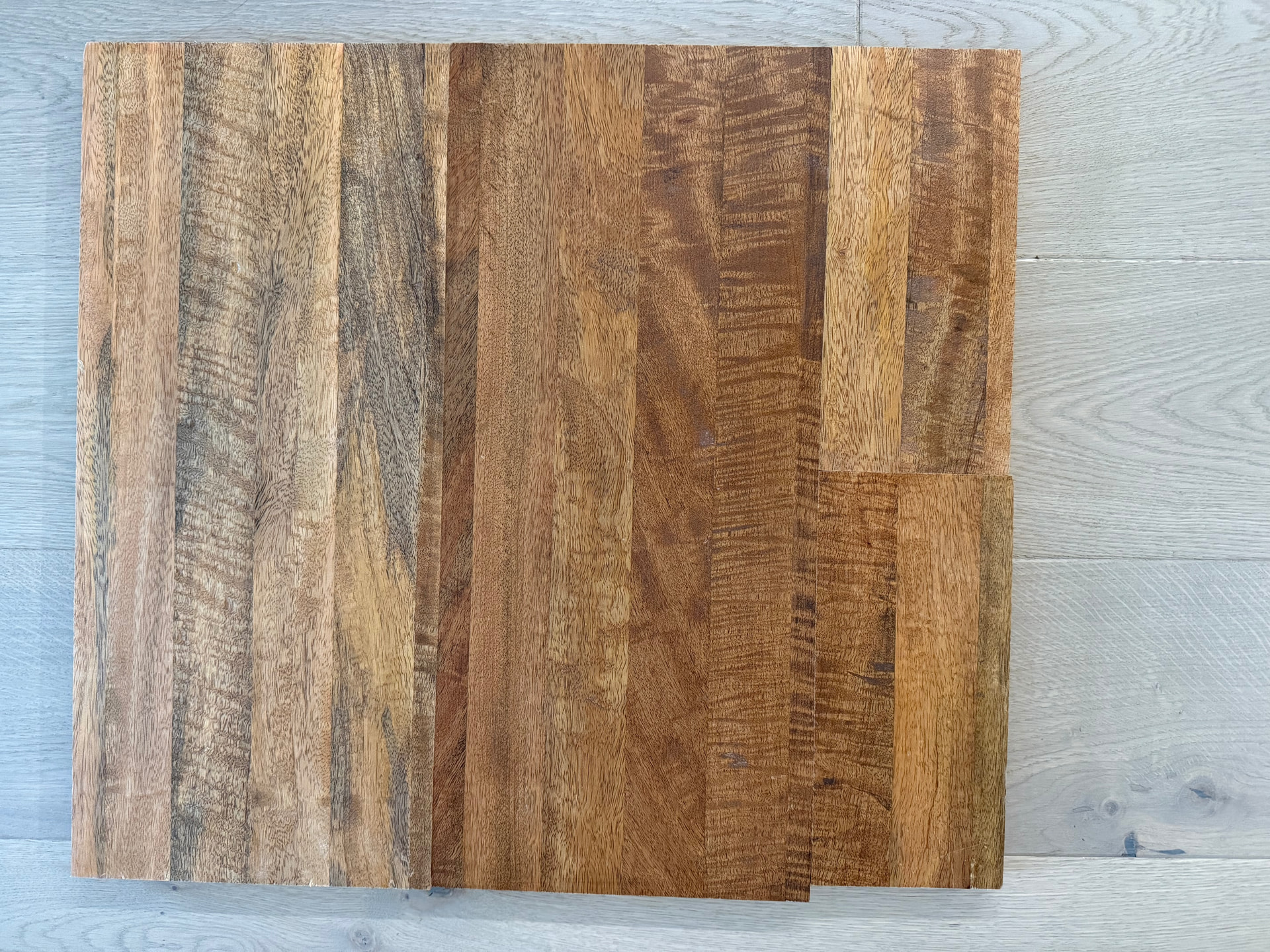

Got my glue-up sorted:

The top looks excellent!!
Thanks Paul! Yep, everything was scraped before I put it through the drum sander :slightly_smiling_face:

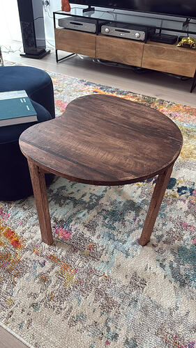

Now it looks like this:

That’s stunning, not going to lie, you’ve got me trailing eBay now
Thanks a lot Paul, you’re far too kind :grin:
