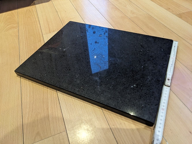

I have a Quartz (ie. man-made stone composite) offcut you can have. It’s from a sink cut out. The worktop company cut it square, put rubber feet and a nice bevel edge on it and told me it was a chopping board, but I am not pushing my knives against that
EDIT: I can drop it at the space Saturday afternoon.
Thanks Tom! What size is it? We need 400x400mm ideally.
That’s a lovely knife blunter! @Dorine ? I think good to have for now to get going.
Agree that should the job nicely for the bottom part
