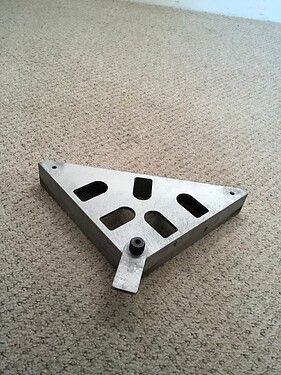

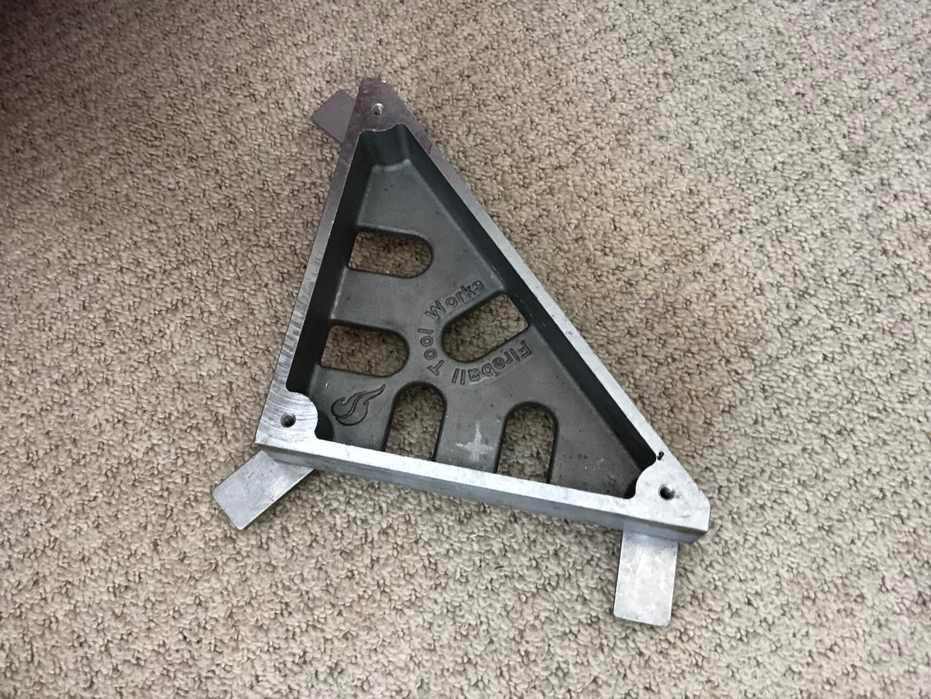

It can be quite hard to get a really good 90 degree angle and keep the frame flat in the other axis as well. There isn’t really anything in the space that’s flat enough to clamp to. I picked up a welding square that works nicely and you can do a pretty good frame even with only one of them. It’s threaded so you can srew tabs in, clamp to them and then you get squarness in three planes - couple of pictures to illustrate.
Let me know if you want to borrow it!
