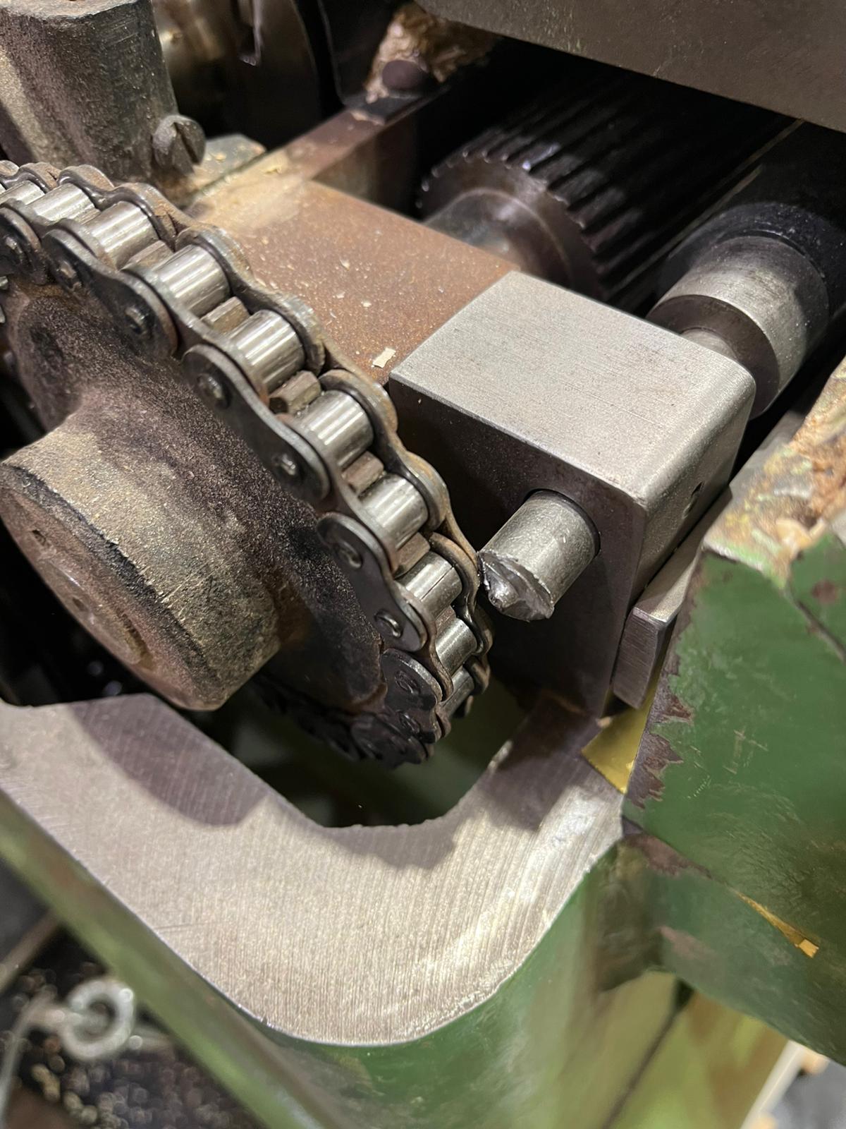

  • 2026: Repeat of roller bar fixing defect detected before it could progress to motor damage. Roller bar modified by tapping a hole in the back end and fitting a fixing as secondary retention. Loctite added to fixings to prevent loosening.
Roller bar interfering on the drive chain. A grub screw in the mounting block retains the bar in the correct position but works loose with time. The far end of the bar has been fitted with a screw for secondary retention.
