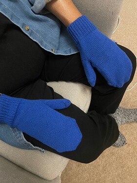

Here’s the finished mittens on their person:

They look great
Amazing work @jamesnwalker how long did it take?
I think each mitten took about three hours to knit and three hours to seam, but there were a lot of mistakes made along the way!
I’m hoping to adapt this pattern so it involves a bit less seaming, because that’s probably the most laborious part of it.
