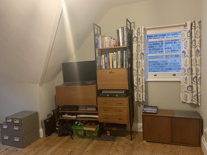

Thanks to @Calum_Nicoll & @Jonty_Bottomley for your welding guidance & help the other week. The Ladderax leg extensions are now all painted, installed and looking great! Some quick pics of how they turned out below. :smile:

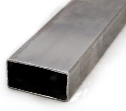

I had 3 attempts at ordering this steel, once I got 200mm instead of 200cm so look out for that one! The 2nd time I used this company via Amazon (they sent me circular by mistake but eventually sent the correct box version which was quite a nice snug fit:
19mm:
16mm:
