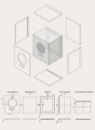

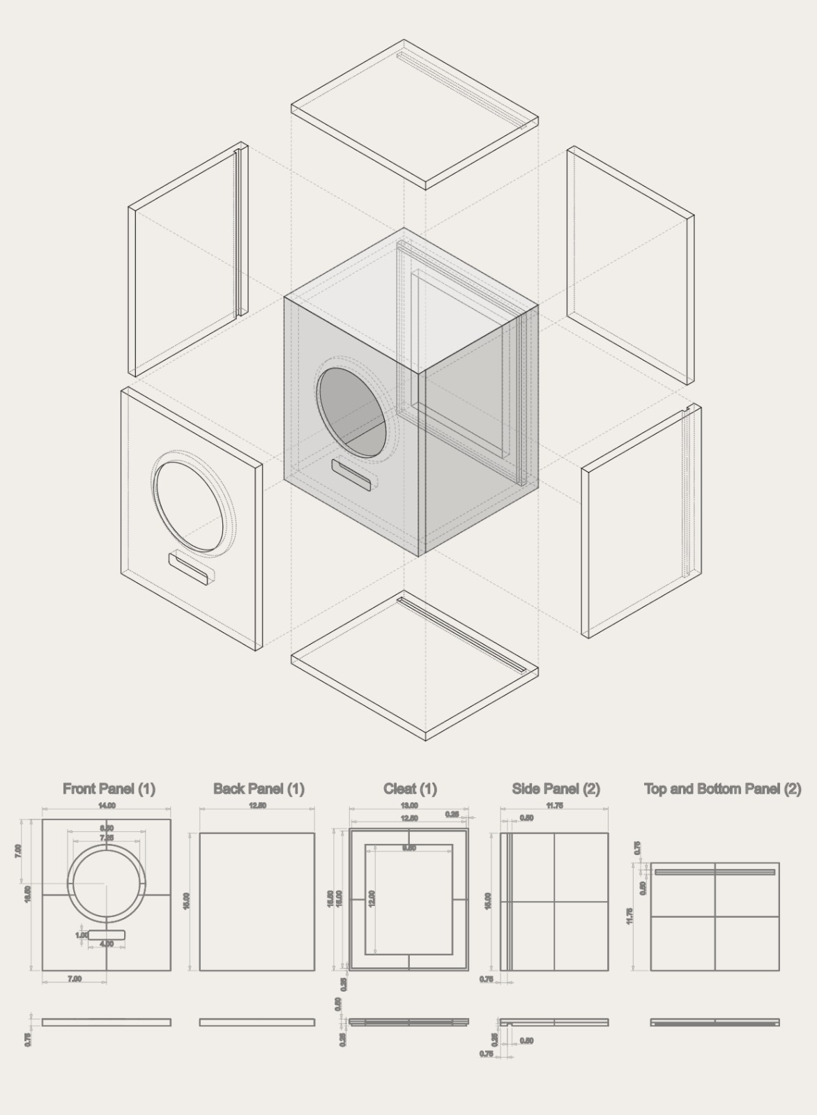

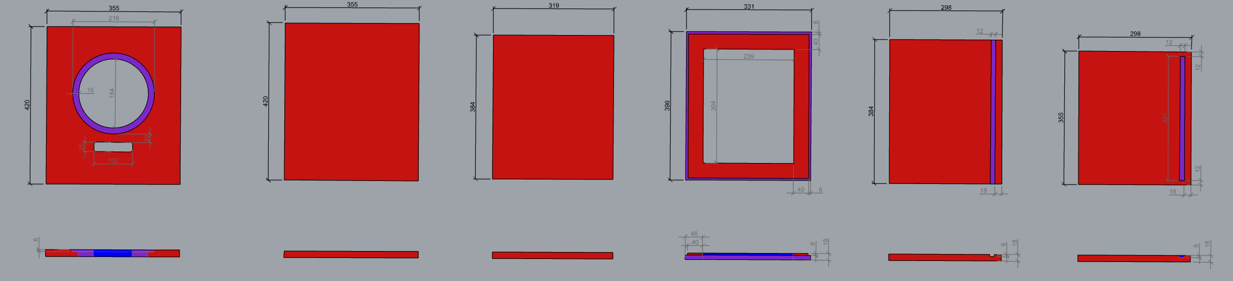

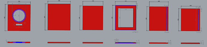

I was hoping someone might be able to help with with the routing (purple parts in elevation diagrams) and in return I’m more than happy to lend a hand on anything I can (I’m skilled in 3D modelling/grasshopper, but also happy if you need some manual labour ! )

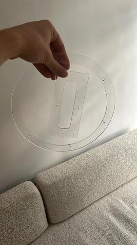

I’ve also laser cut some parts out of acrylic as a template, and can laser anything that might help speed up the routing process if you let me know!
And attached is a PDF with a more detailed piece by piece breakdown
Routing.pdf (211.3 KB)
If anyone has any advice on this, that would be much appreciated

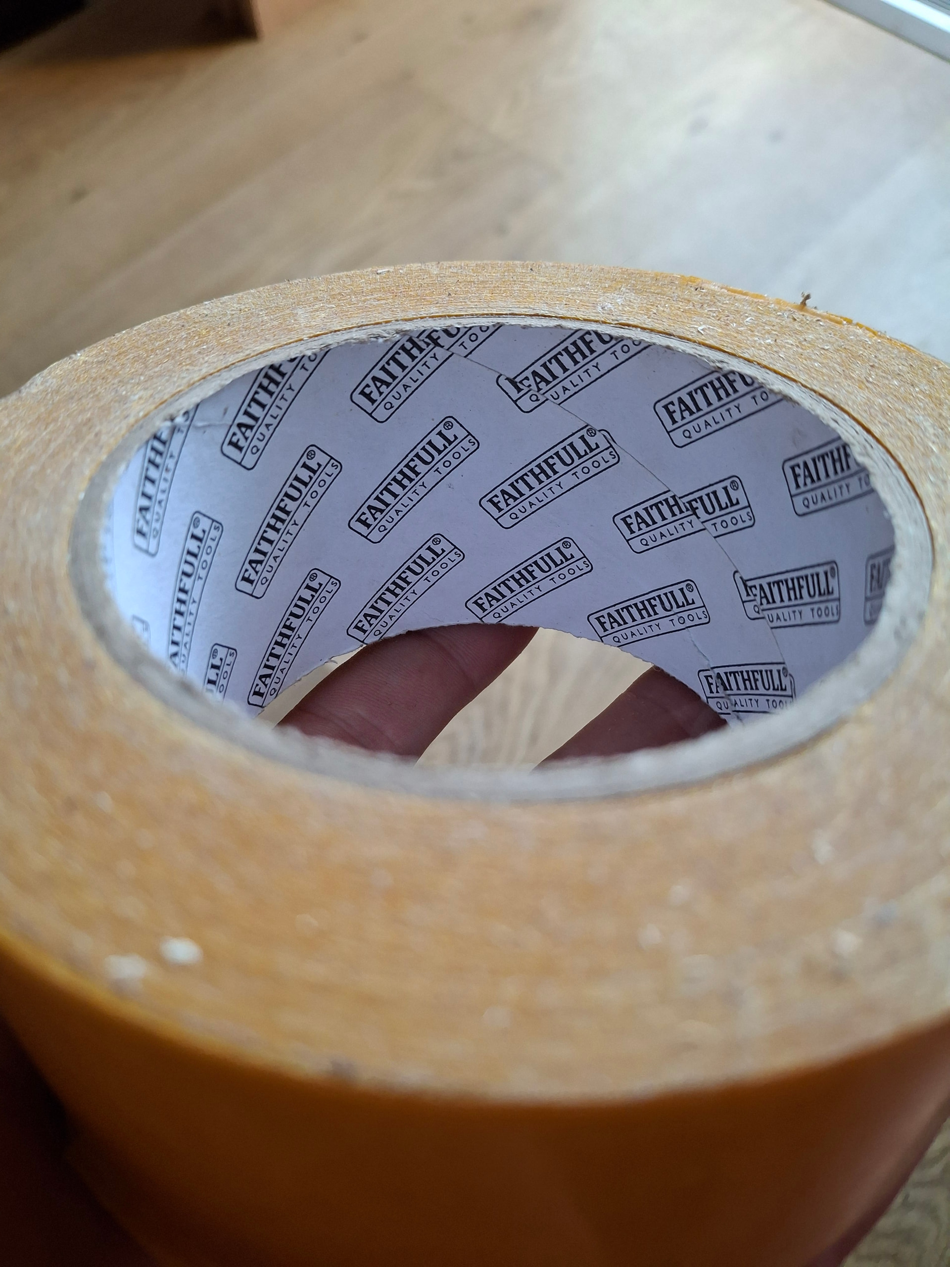

As you have the templates already, most of the work is done, just get some double side tape to keep them in place.
I highly recommend using this particular cloth double sided tape. Its by order from B&Q online only, not in store.
A few of us at MS were looking for the ideal tape and for me this is it. Some folk use the blue painters tape and super glue (cyanoacrylate) trick but I prefer the cloth tape.

It was I and few members trying to find good grip, easy to remove tape and this one is it.
