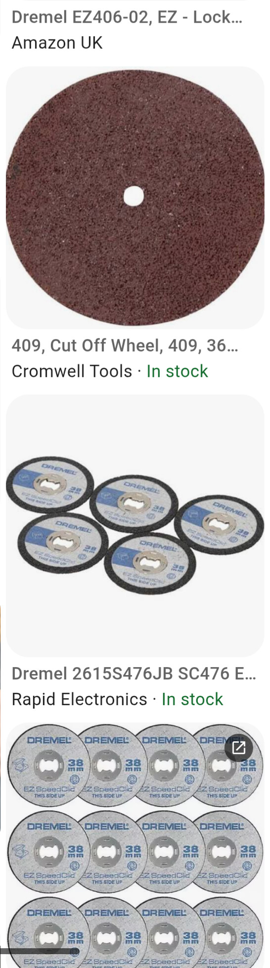

Regarding recommendations on the tools, any dreamed will do with those fibre wheels. Something like this.
The first model fit on a standard shank, the second and third fit on a proprietary shank from Dremel, I don’t know if we have any of those shanks lying around.
If you never used a tool like that, grab a piece of scrap metal and play with it, test a few cuts and get a feel for the tool!
