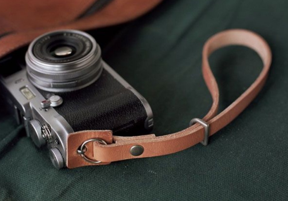

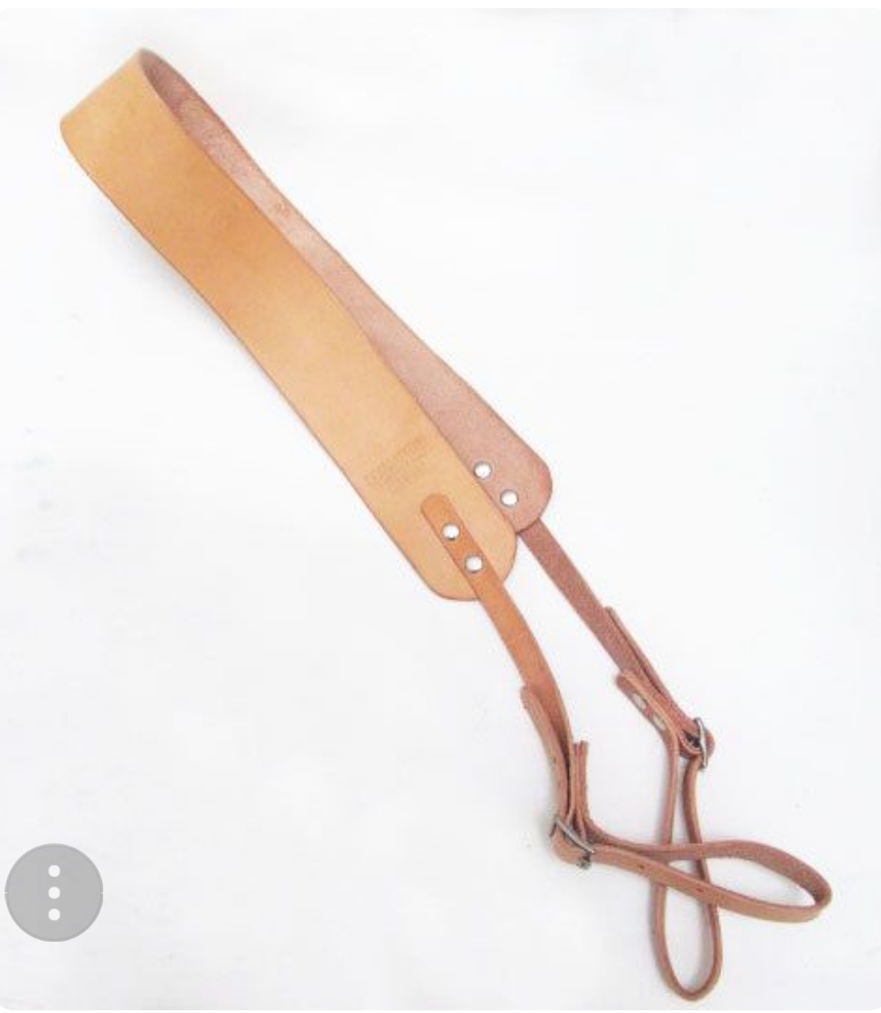

Without seeing the strap you are trying to replicate, I would say you can probably modify it and make a no sew version.
Some examples
