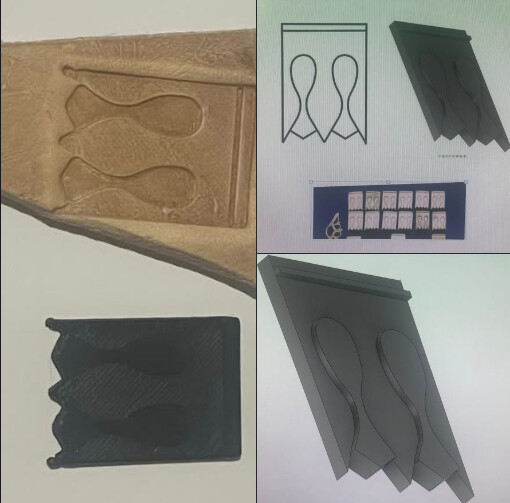

An alternative to laser etching, is embosibng with a 3d printed part.
Looks incredible, thanks @Dorine

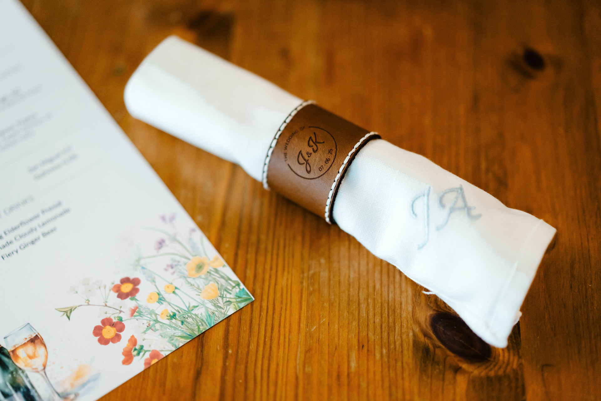

I made bespoke napkin rings for my wedding at the makerspace last year:
I used the laser cutter to engrave the wedding logo onto the middle, cut the stitching holes and the shape of the ring itself. It went really well and I had no real issues with it.
Tips from my experience:
  • I use undyed veg-tanned leather to avoid having to understand what dyes were laser-safe (then dyed afterwards)
  • I found slightly dampening the back of the leather helped keep it flat against the laser bed
  • Leather seems to lave more residue in the laser nozzle than wood, so made sure to keep an eye on it when cutting in bulk
