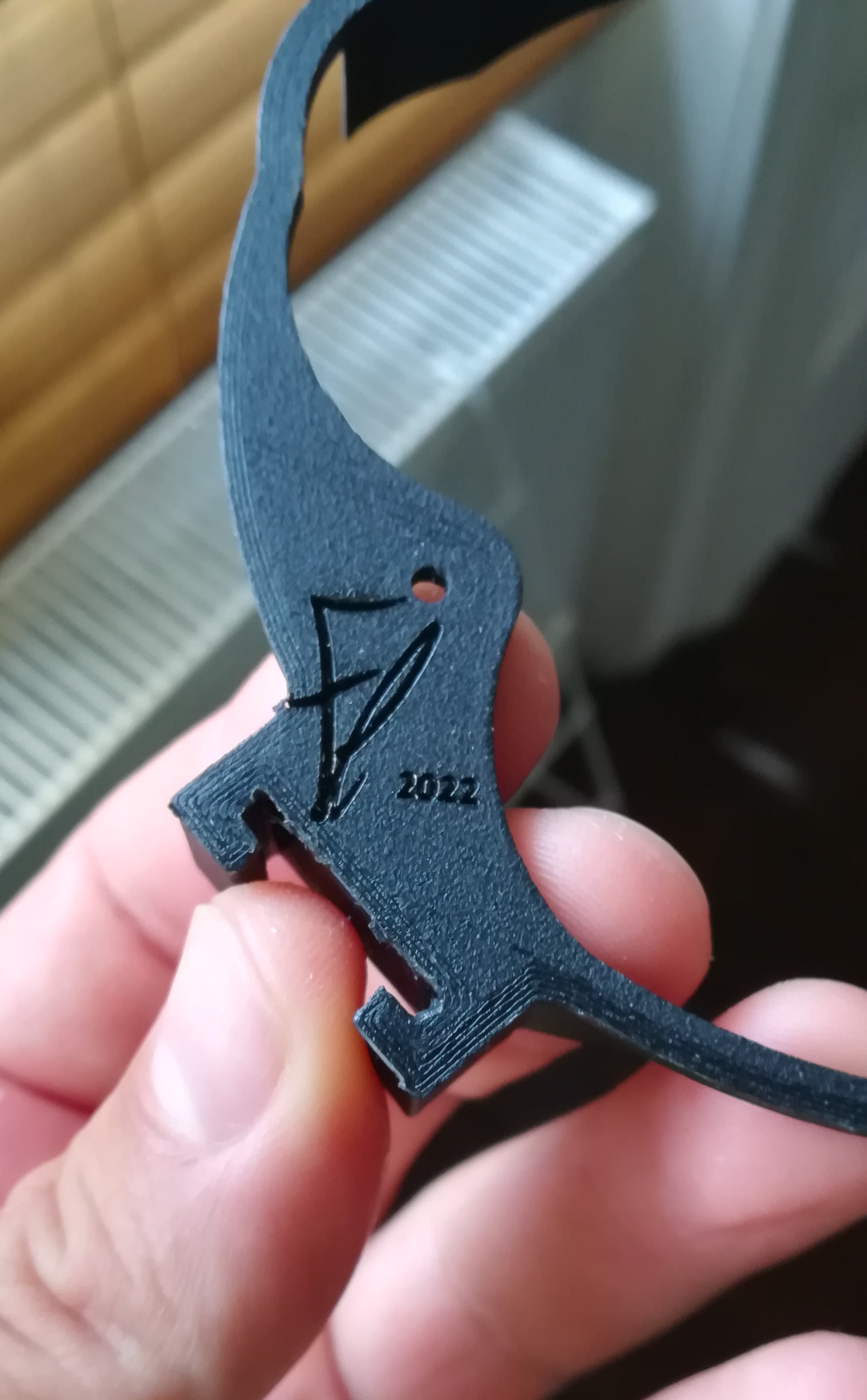

Hi guys,
I did some tests yesterday on PLA engraving and i saved the settings on Ruby if anybody needs them.
Engraving PLA is tougher that I thought i used higher settings that wood engraving but the results are really good.
Thanks
Federico
Can you share some pictures with us please? ![]()
Printing the component with the mark would not have the same quality.
Federico
Looks great! Good work - thanks for sharing!
That for your camera housing?
The engrave? No just testing. The PLA piece was, but it’s an old test. I’m printing the new pieces these days.
