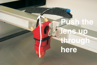

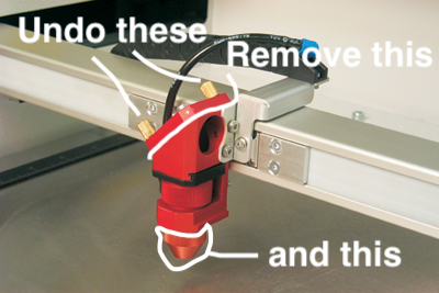

Hi does anyone know the knack to remove the laser cutter lens? as there are some members here waiting to use it but we cannot take it off for cleaning.
the ferrule unscrews but the plastic holder seems stuck in.
@Calum_Nicoll i think you were using it last today, did you notice anything when you cleaned the lens or used it?
No - it was stuck - I tried to remove it but did not want to go the pliers route - and then ran out of time and had to catch a train - intended to discourse it but you beat me to it, thanks.
My cutting was pretty light, maybe 5 mins of acrylic and ply total and lots of fiddling with position.
If someone has the file for the 3d printed version I am still up for milling a heavier duty version.
I’m by no means an expert, but if I was a betting man I’d say the plastic has melted a little, disfiguring it and meaning we can’t get it out. It wiggles, but will not slide out for love nor money. Think the whole unit will need unscrewing to get it out without damaging it (the unit, not the 3D printed lens housing)
Ok, if it is stuck it means the lens has moved in the plastic printed part. The lens is now hitting the underside of the piece that holds it. Removing the printed part in this way may scratch the surface of the lens. Pliers won’t help here.
It will have to be removed for the lens to be reseated. If someone tackles the job, use caution… I printed a spare holder to replace that one but the 3D printed parts where only supposed to be temporary anyways.
I can drop by to have a look but maybe only tomorrow morning/evening.
Thoughts?
@lewisss had most of it off and was trying various things with no joy. If any @lasertechs are around anytime soon they could always have a poke about to see if they can free it at all.
