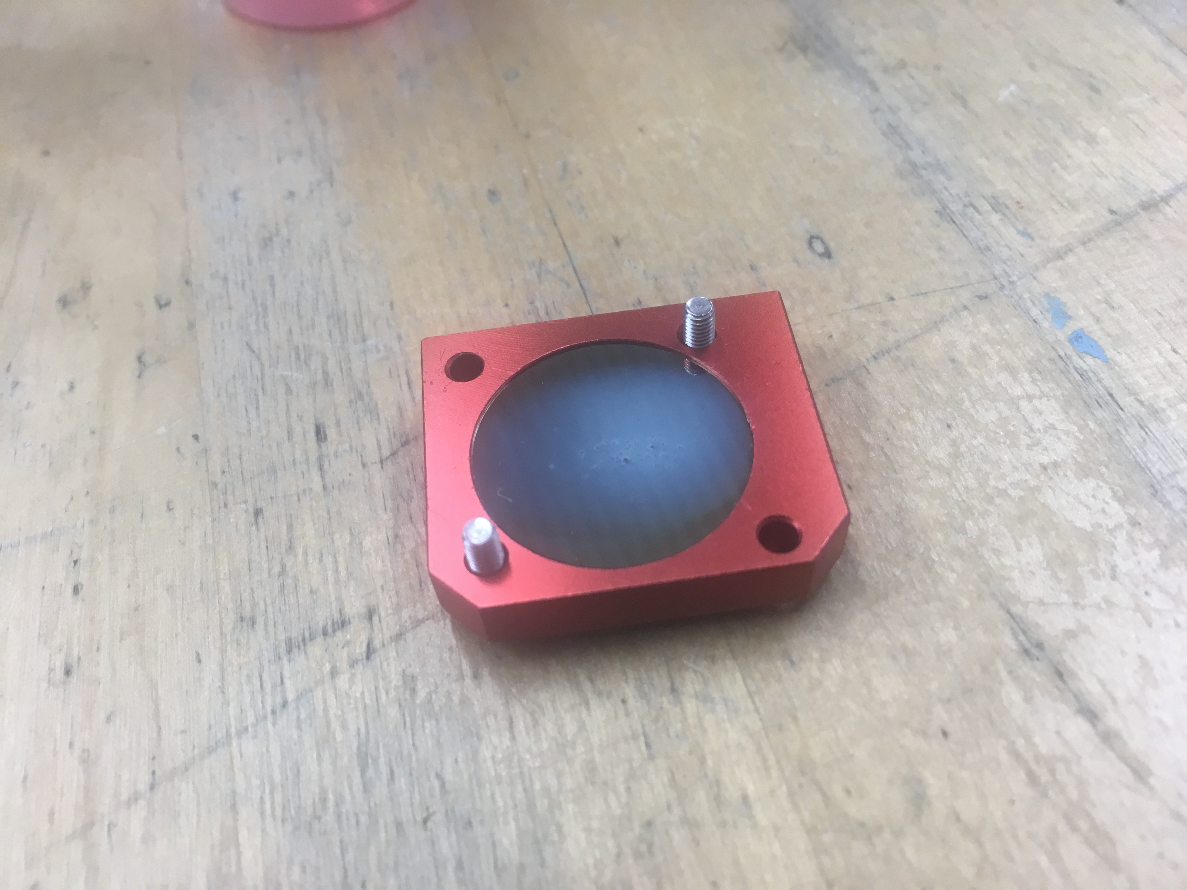

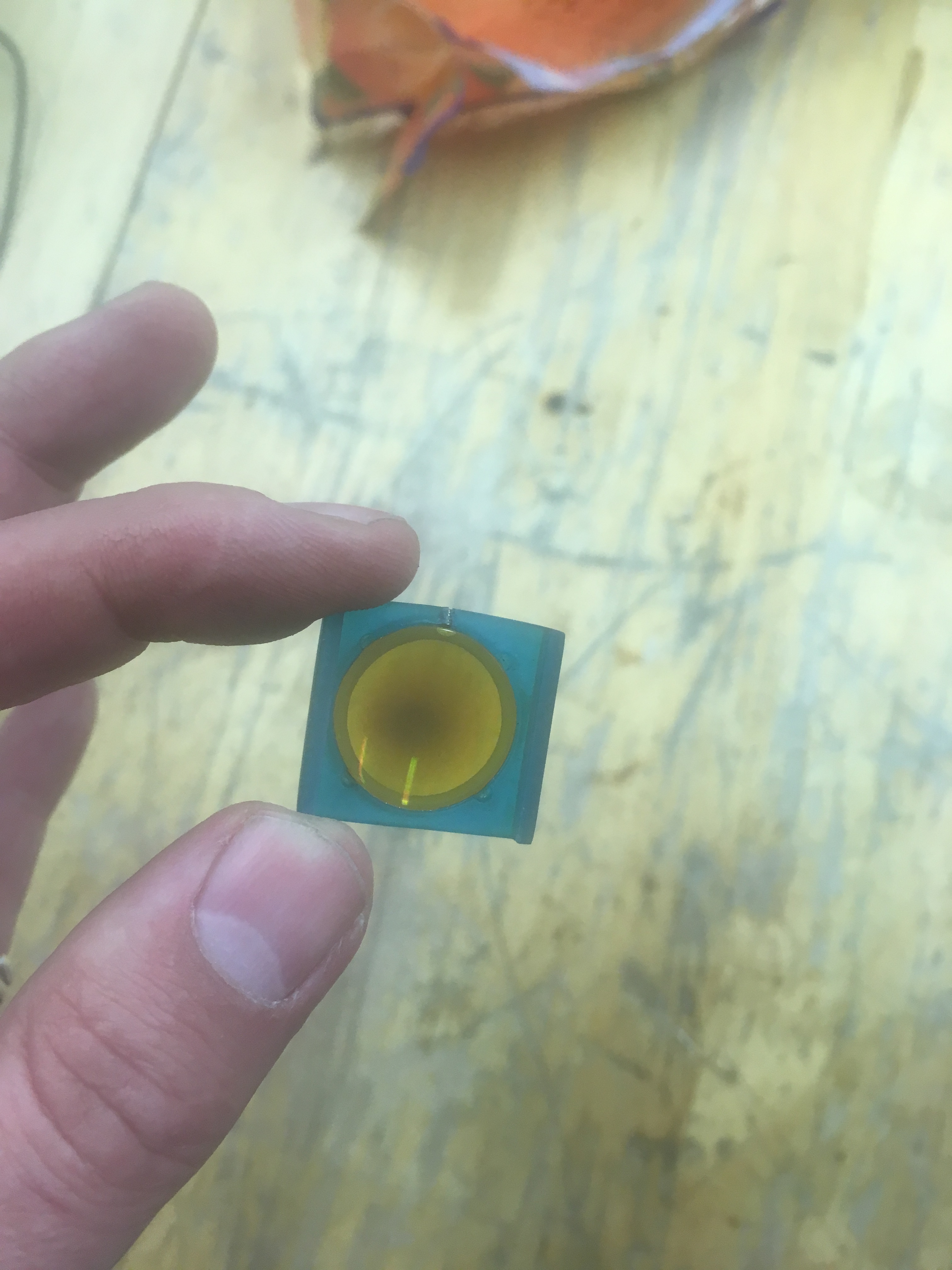

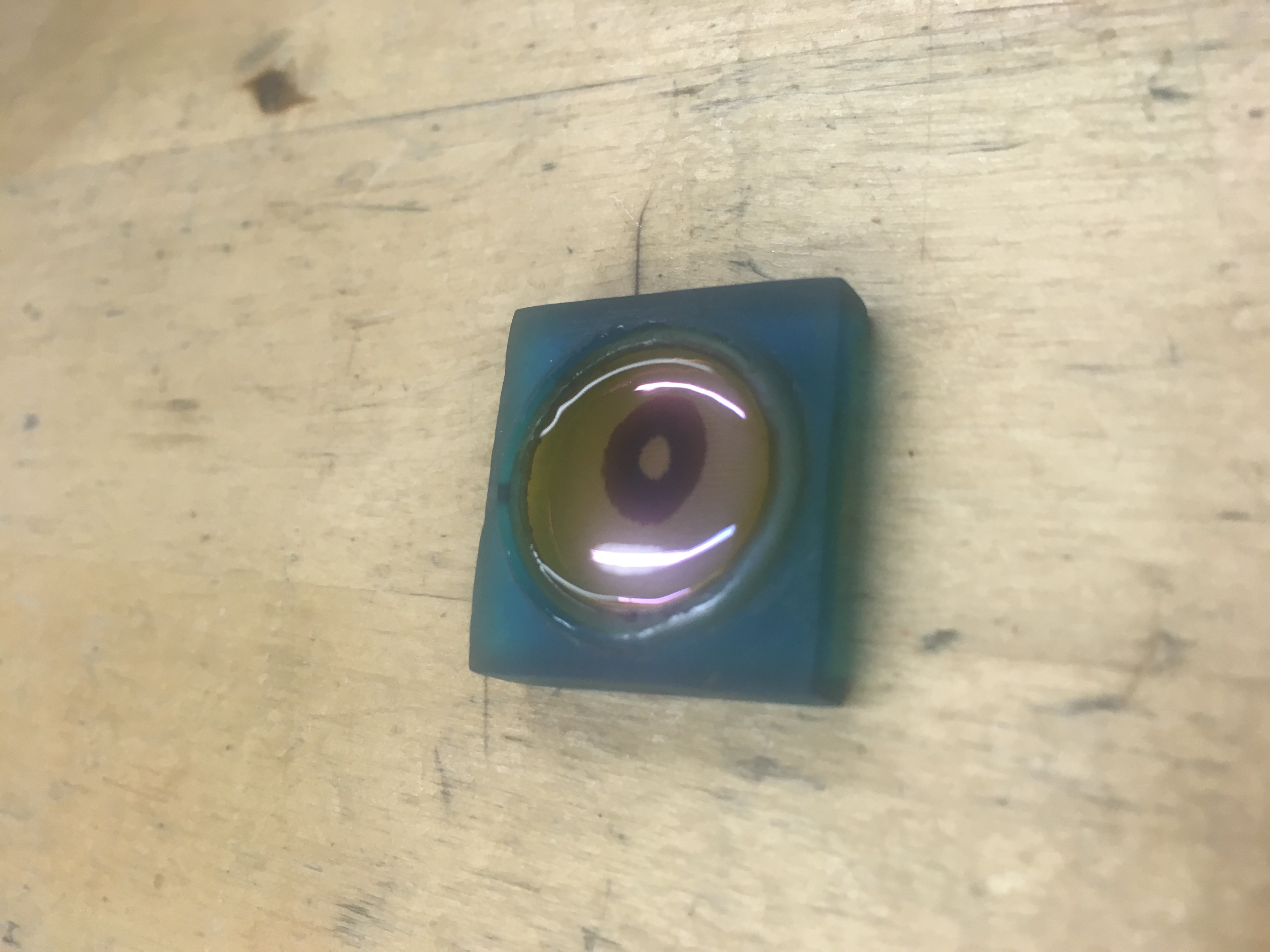

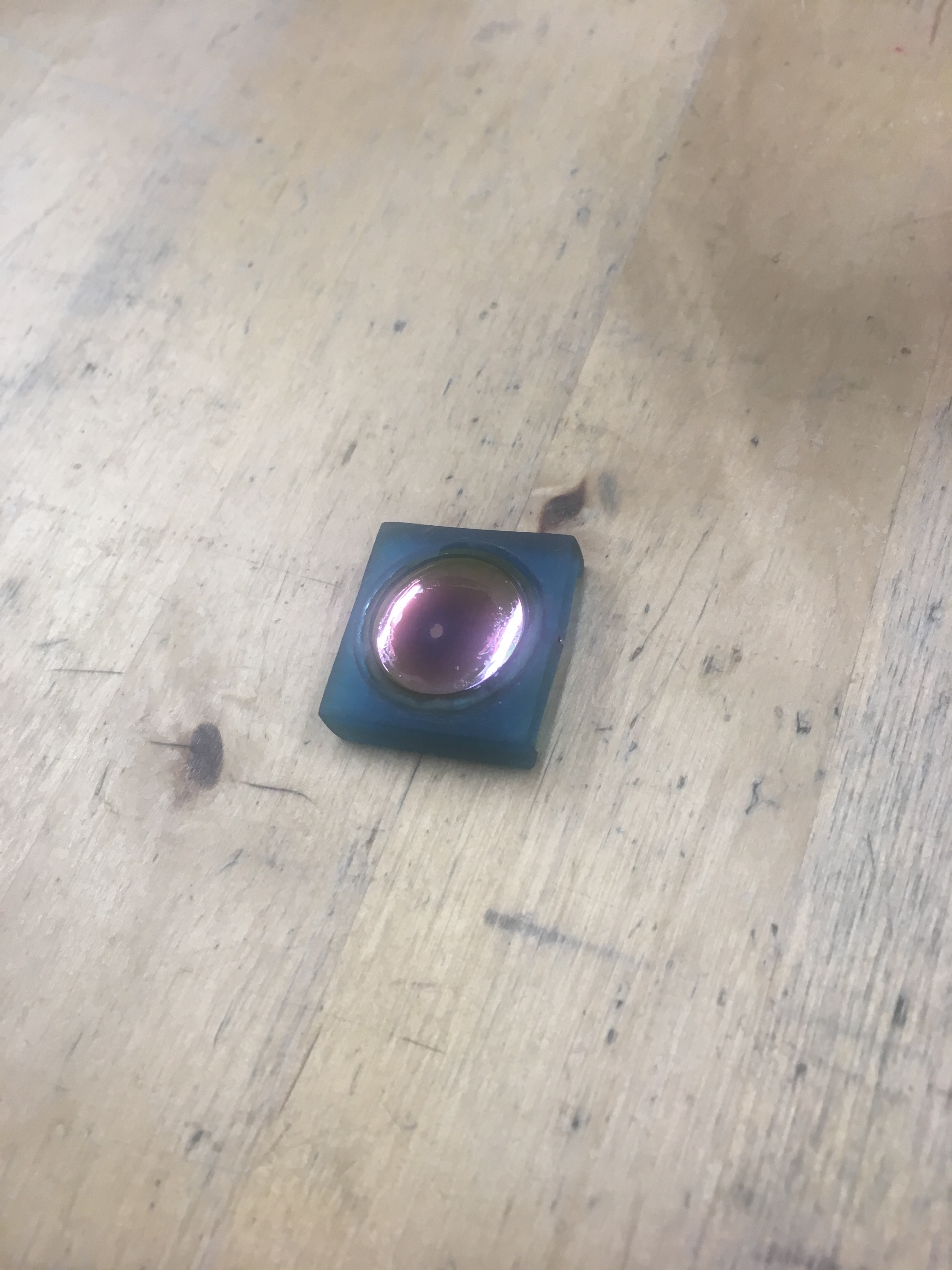

I came to use the machine this morning (Morning of Friday 7th June) and it has been left in very poor condition.
The nozzle was covered in black sticky stuff. The lens was coated in nasty sticky brown stuff, and the mirror was milky.
I’ve managed to clean the lens with multiple soakings and gentle cleaning with tissue over about 45 minutes - I have also cleaned the nozzle and the mirror.

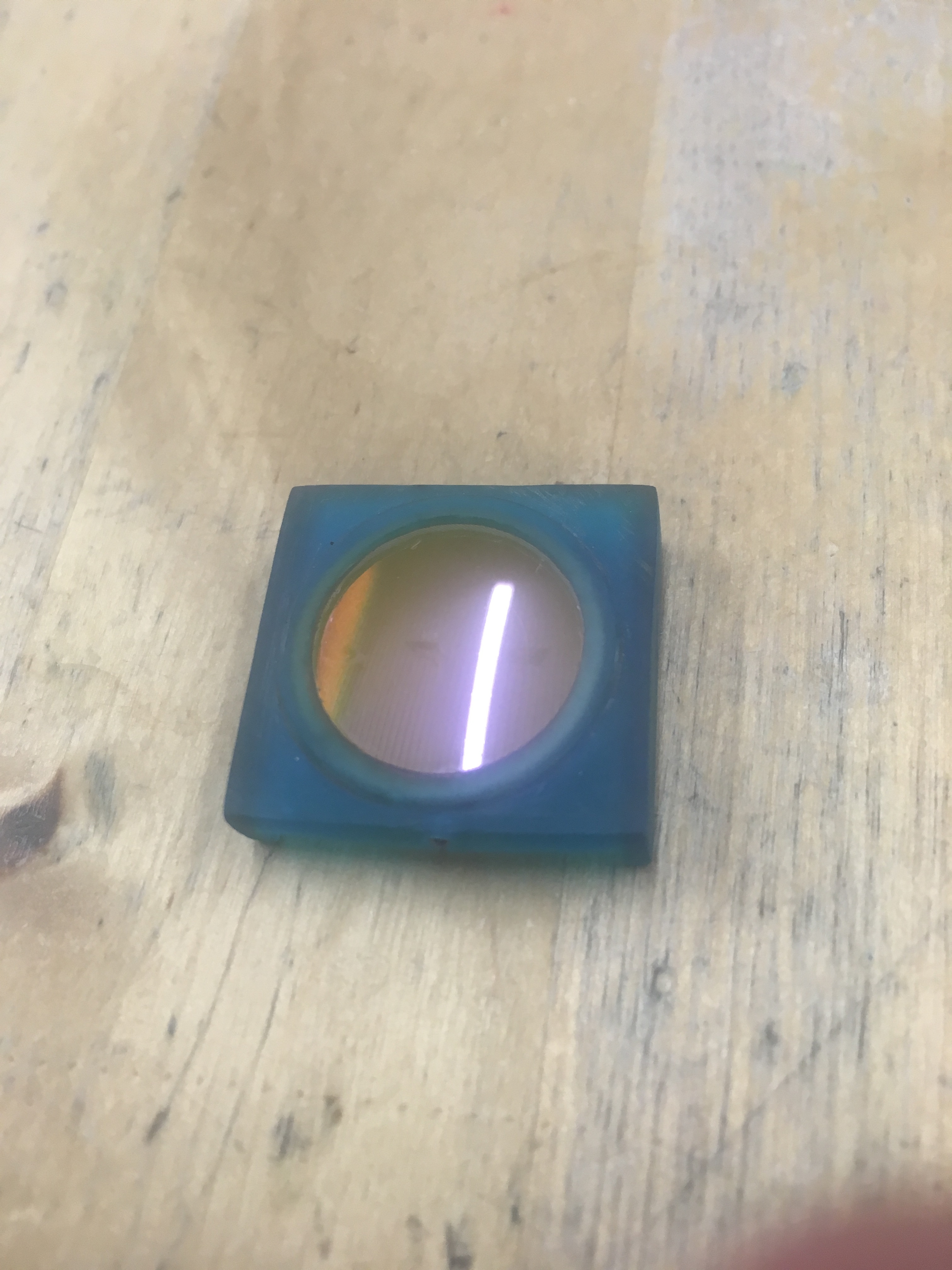

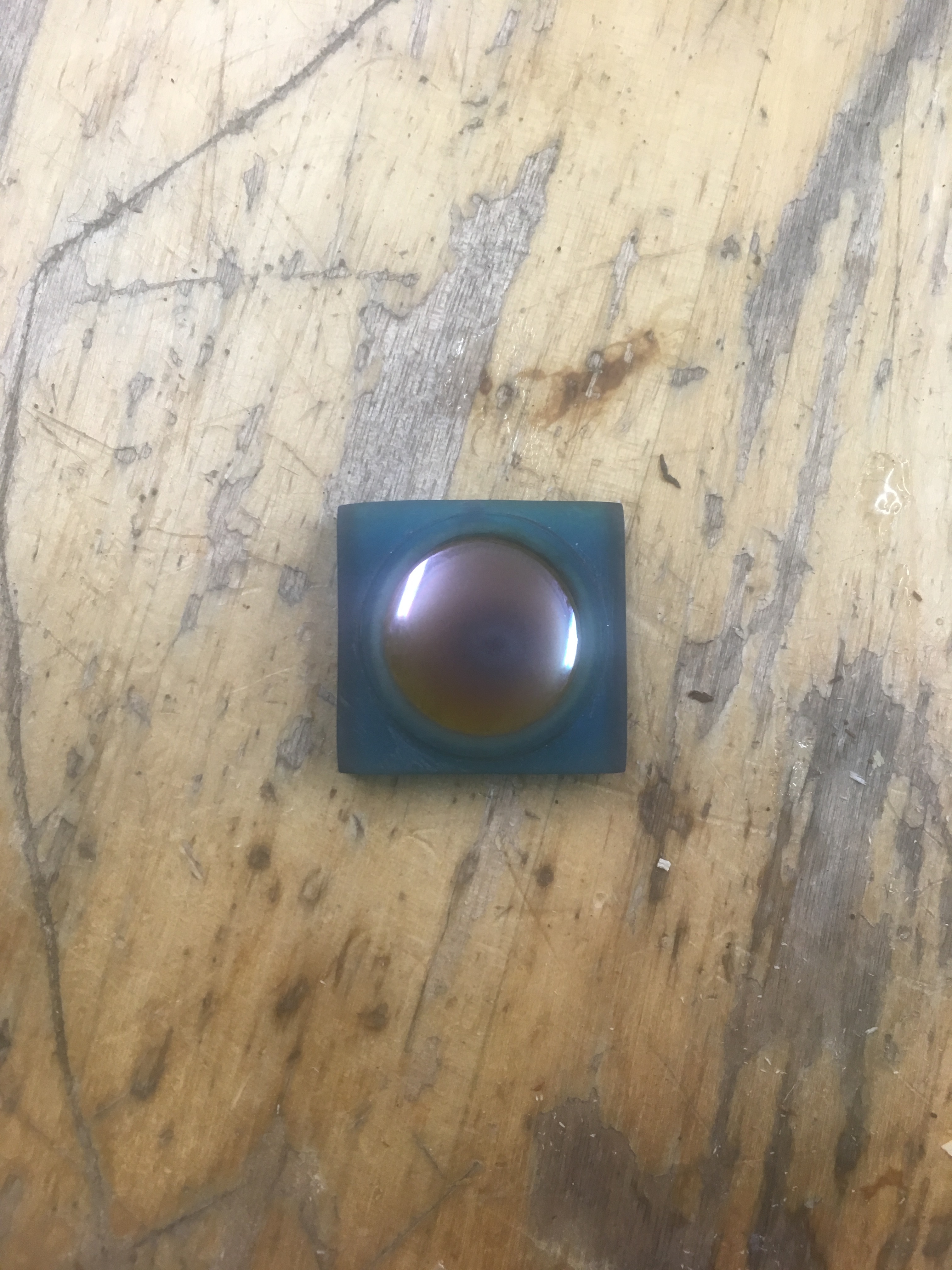

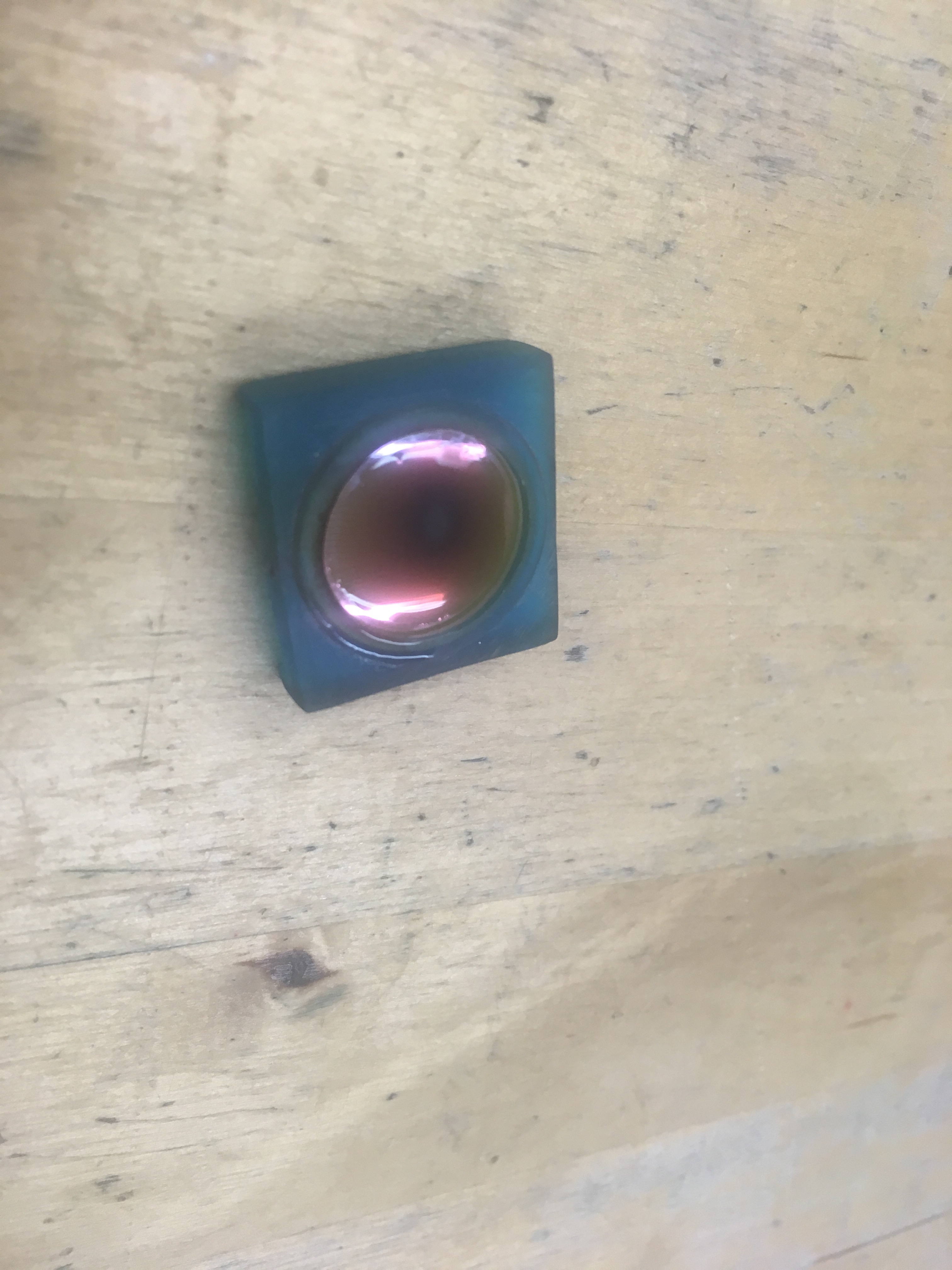

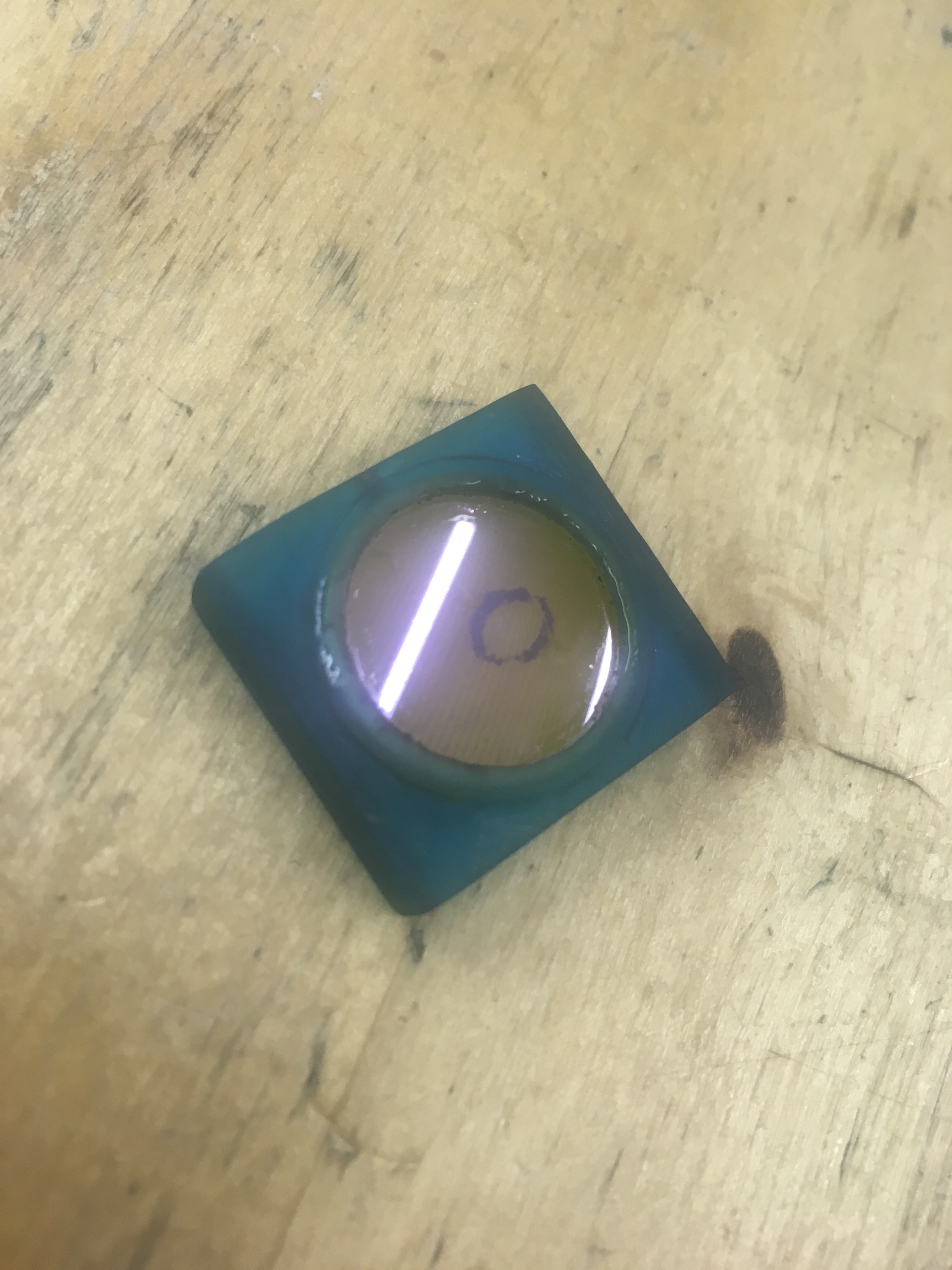

I’ve checked with @Dermot and we agreed that I can now use, however there is a slight variation in the coating on the lens now, so can I ask an @lasertechs to inspect when you are able. You can only see the variation when held up to the light.
Photos of the mirror and lens (in the wrong order…).
Thanks all!
Gawain
lens now post cleaning
I’ll admit to using the laser late yesterday evening, but checked the lens and mirror after use and they certainly didn’t look like that.
Wow that looked nasty! Thanks for your efforts to clean the lens and mirror, I will come inspect them this afternoon. More when I see the machine…

Thanks for the response firstly and it may/may not have have been you… what where you cutting/engraving?
I was cutting thin sheets of veneer (0.6mm). I had used it last weekend for the exact same job for several hours with no issue and used it again last night. the only difference was that last weekend I used laser ply under the veneer as a template which has now been lost and last night i used laser MDF. I was on it for about 2 hours last night and as I said I was cleaning the lens and mirror every 2-3 rounds and there wasn’t anything like what was on the pictures.
The veneer and the MDF are still at he space in the snug on the right, about half way down if you want to have a look at them.
@lasers was there anybody else using the laser last night?
I think I was the last one as I left after midnight
How many sheets have you cut yesterday?
Probably about 8 or 9 rounds
They were smaller/quicker than last weekend. so took between 6-8 minutes per round of actual cutting
I did use the pink lens cleaner about half way through my session last night. I hadn’t used this last weekend. I used this on the lens only. not the mirror.
Post assessment there is no real damage to the machine… going to cycle to a new lens just to be sure as existing one is a bit questionable with partial missing coating. @ZD86 I did see some of your veneer cuts in the scrap bin and think we can Optimise your settings as it looks like you have a high waste output…(lots of unused cuts in the bin).

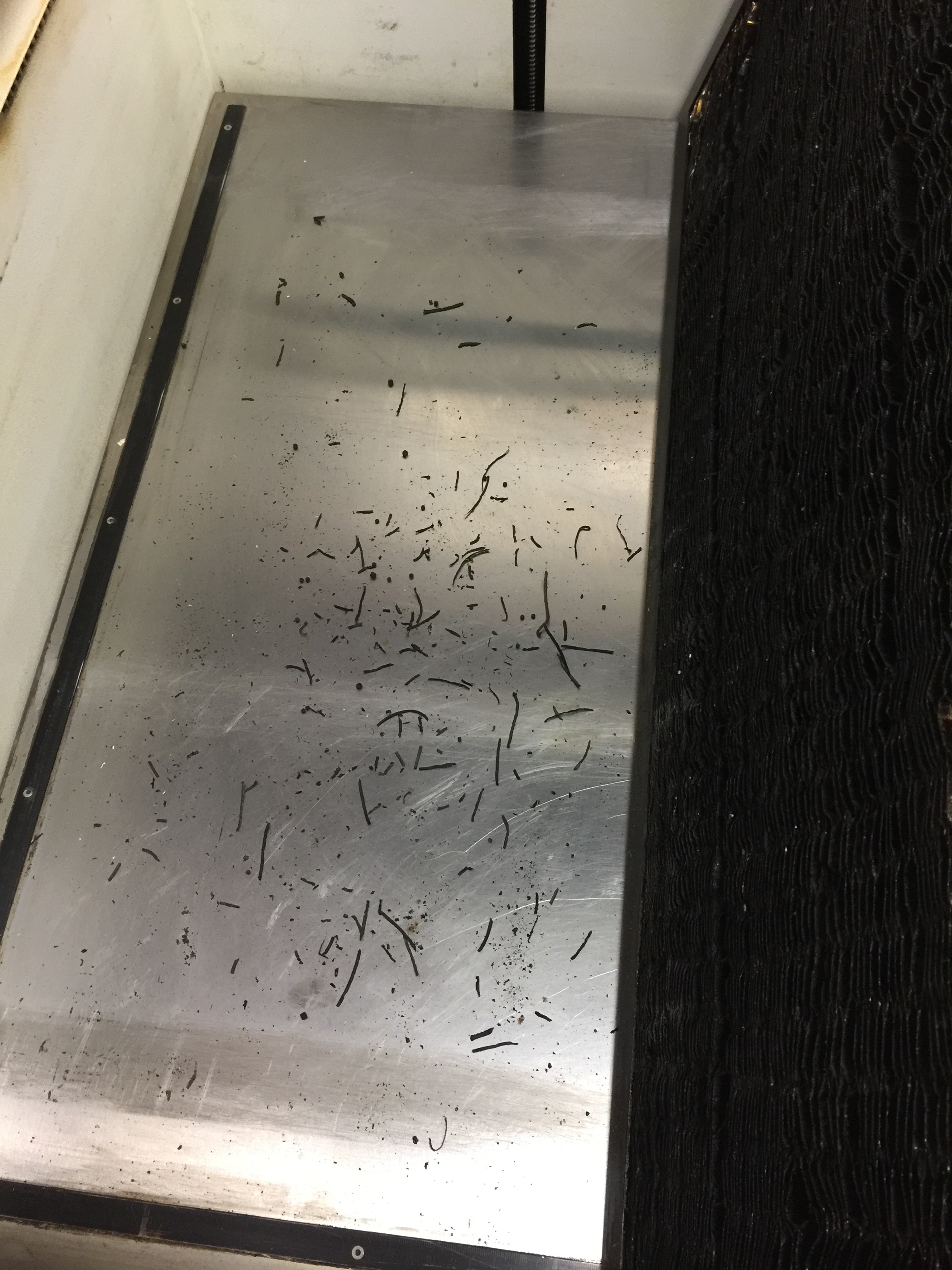

Come on @lasers ! I came in this morning and it looked as if someone ran out the door for a fire drill never to return.
Lots of debris on and under the honeycomb, lid completely open and 25 files open on the PC…
Please plan in some time to clean up after yourself so the next person doesn’t have to do it for you!
