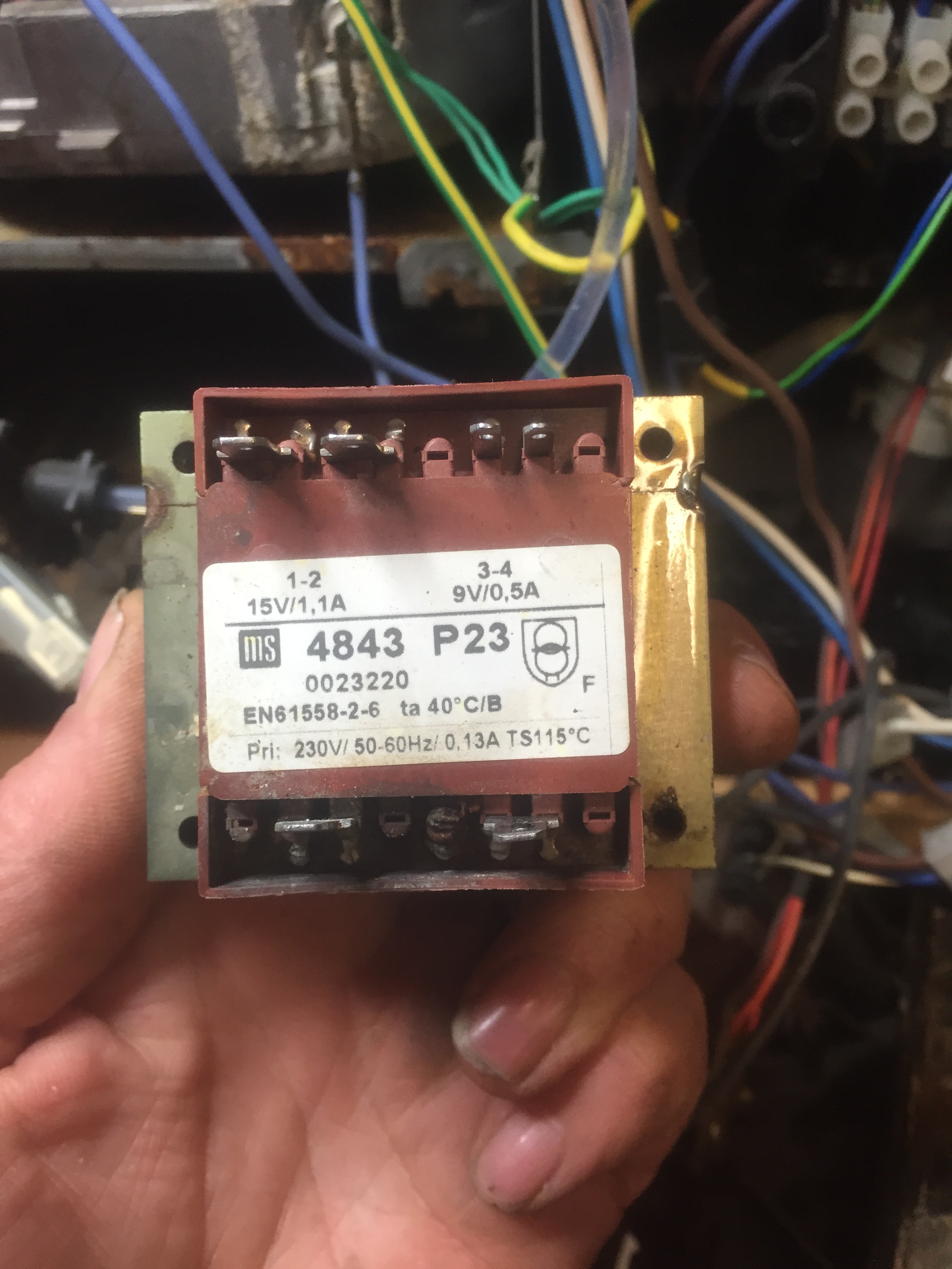

So after spending several hours this evening trying to fix the machine, we managed to isolate a fault (although not the root cause) down to a 12V supply within the machine that wasn’t supplying 12V. Uploading…
Also, a relay was knackered (possibly a cascade fault from the 12V supply breaking) which we replaced. By applying 12V from a lab supply we managed to make the motor move (yay!), However we need to work out what is at the end of that white lead which might be broken (probably another fault).
A task for another day!
Great stuff guys!
Traced the fault to a transformer buried deep inside the machine.

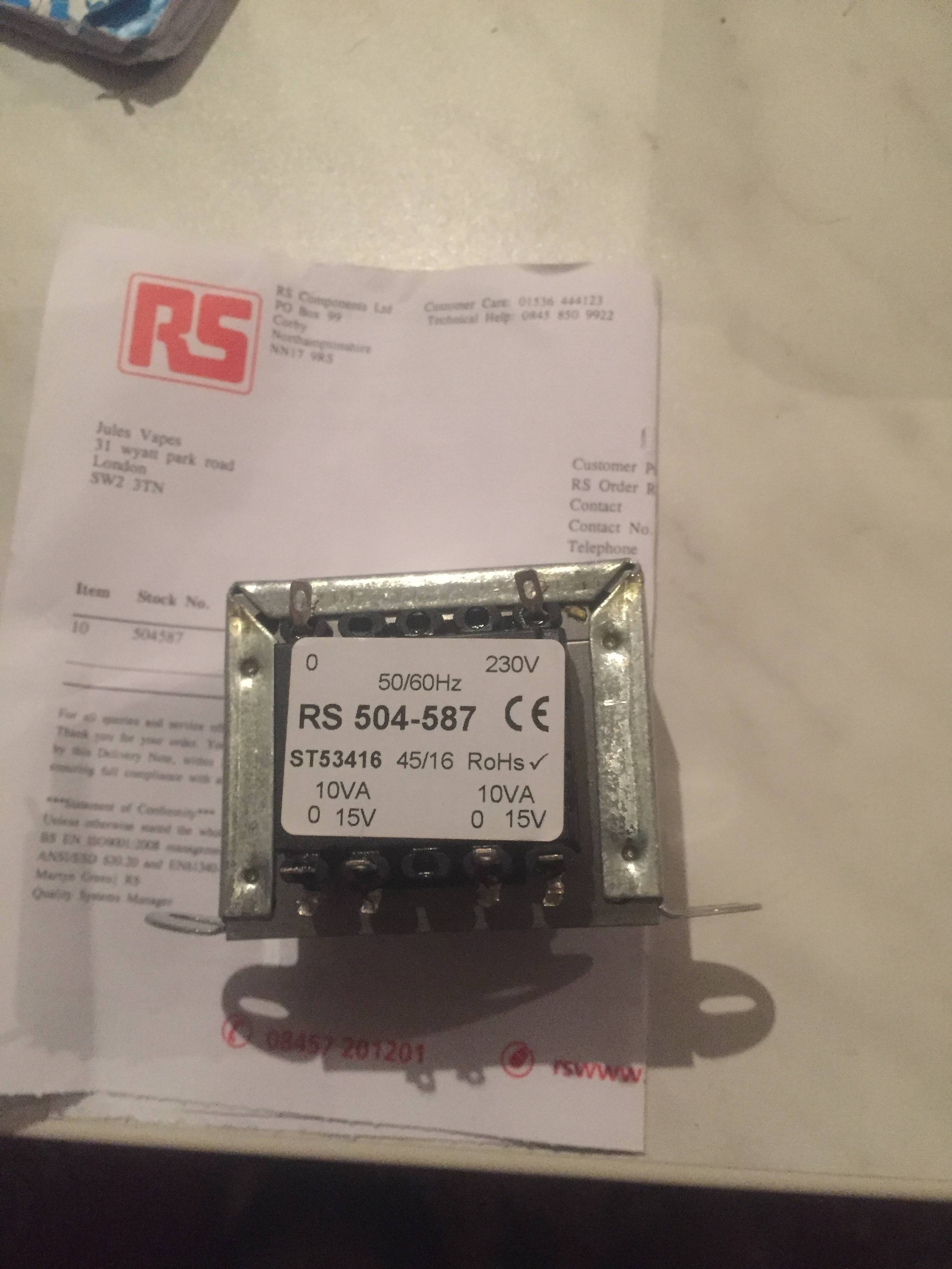

Don’t suppose if anyone knows if there is a 230v/15v 1.1A transformer kicking around in the space?
If you go down to the snug today, you’re in for a big surprise…
Or a big disappointment.
Worth a shot!
No luck at the space, but have ordered one from RS. Should get it Thursday… Have lathe induction that night so might tie in well together
