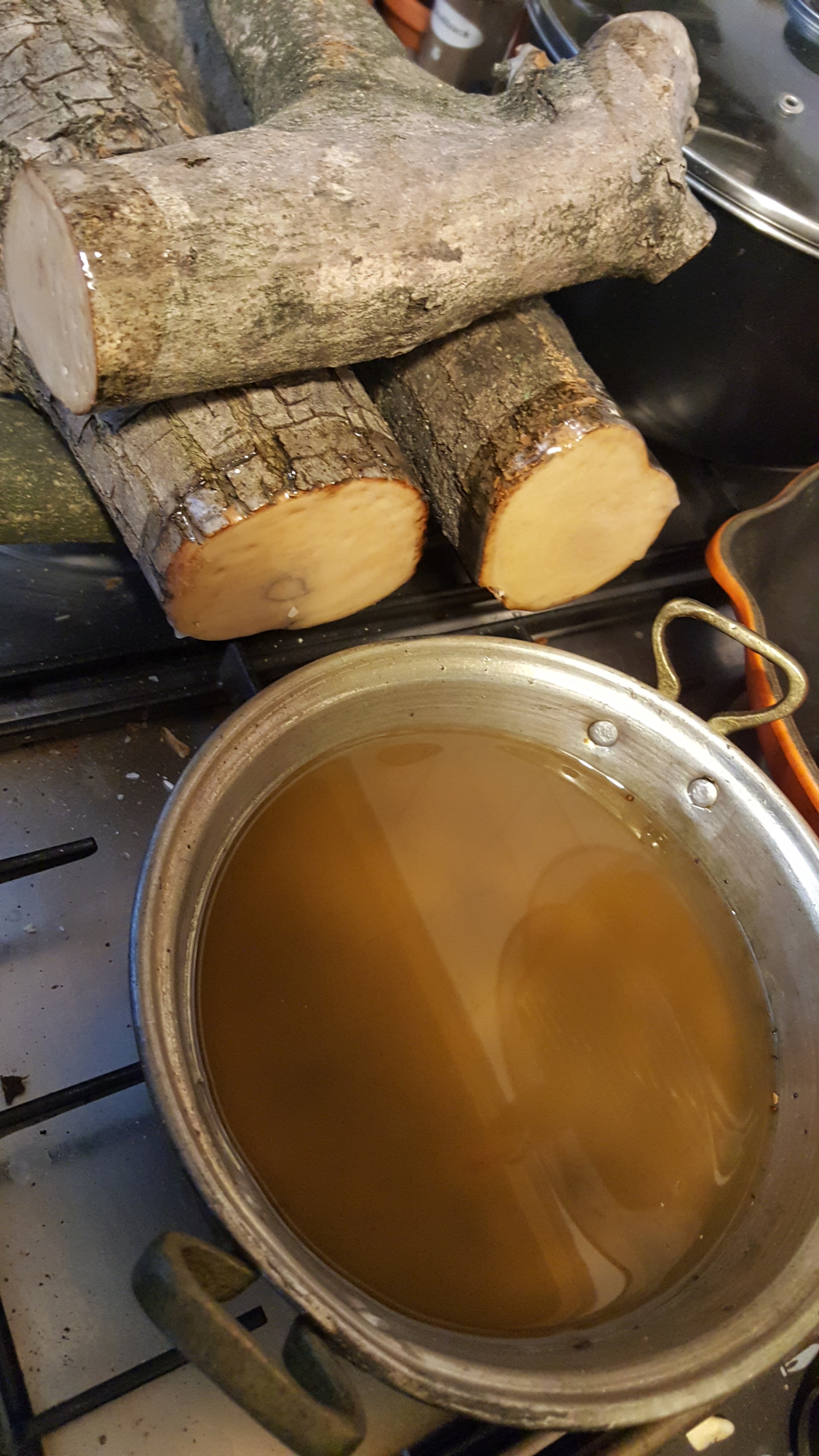

I wax dipped the olive @dermot dropped off at the space…more fun than painting and less clean up. No chickens were harmed.
Preformatted text
Looks good! Is that paraffin/bees/ some fancy wood sealing wax?
Nah, my girlfriend’s very old and grubby big IKEA candle! Enjoyed melting it! I leave it to cool in an old saucepan and it’s ready to heat up for next time.
…a bigger saucepan, placed on the floor…you could dip some big logs in that…any difficult to reach areas I spoon the wax in…other benefit is it dries in 2min, so no logs lying around the place waiting for painted ends to dry.
Once saucepan is cooled I lay come cling film or foil on top to keep dust and debris out, and store away for next time.
