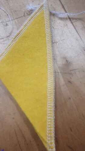

Ah one of the needles has been shattered. I had a look through the needle drawers and couldn’t see a HA-1SP needles, do you know if we have any?
HA-1SP are Janome-specific needles (all-rounders), but other brands will work too. Use the needle most suited to your fabric, and please change both needles so they match. As the overlocker is quite a fast machine, first turn the handwheel (towards you) manually. If the needles do not hit anything or bend, you should be good to go.
I replaced the needles.
