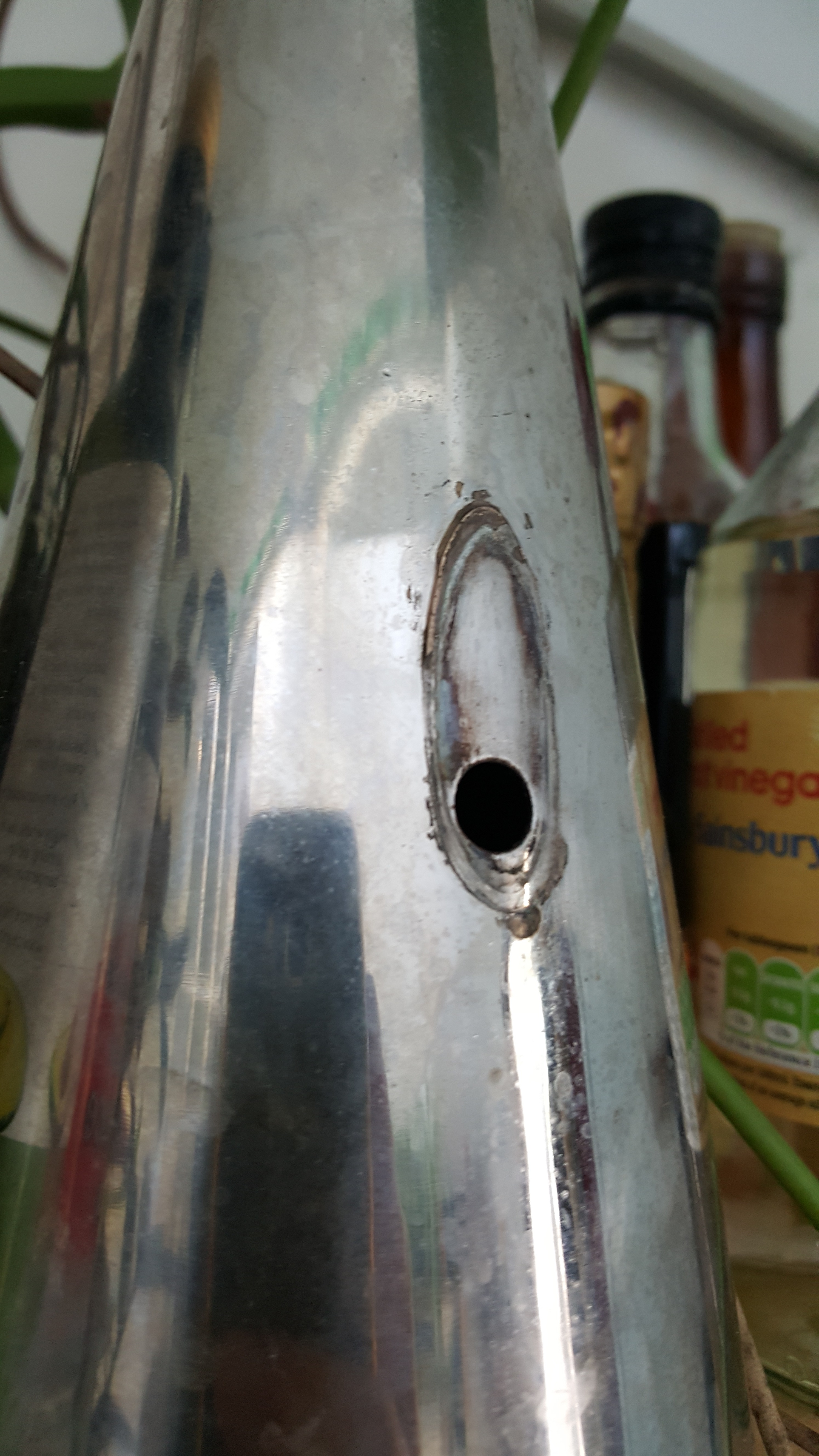

The spouts snapped off. Is the best way to attach it to weld it? Do we have a mini welder that could do the job?
It holds food oil. Tried glue super glue and it fell off.
If that’s what it looks like (v thin steel) it will be tricky to weld - do you know how thick it is?
Brazing might work and be easier but I don’t have much experience with it.

Maybe I’ll ask the metal fabricator a few arches down, he’ll probably have a brazer.
If you get stuck/find yourself in Hackney and fancy a couple of hours of experimenting with brazing - can try it at LHS - we don’t have rods, but we do have a brazing torch that would be fun to practise with…

I am a member and we can take guests in - have turned on the brazing hearth a couple of times but not actually done much brazing - but if you find some suitable wire/flux we can craic on with it - does it need to be food safe?
