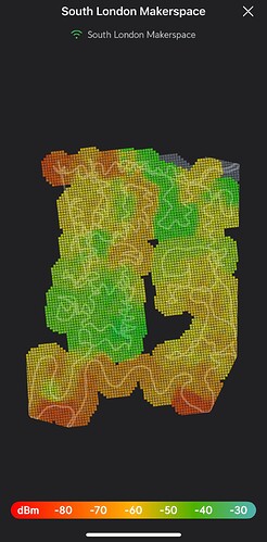

On a side note I a heat map I made of the Wi-Fi for both arches, the snug at the top, and the carpark at the front.

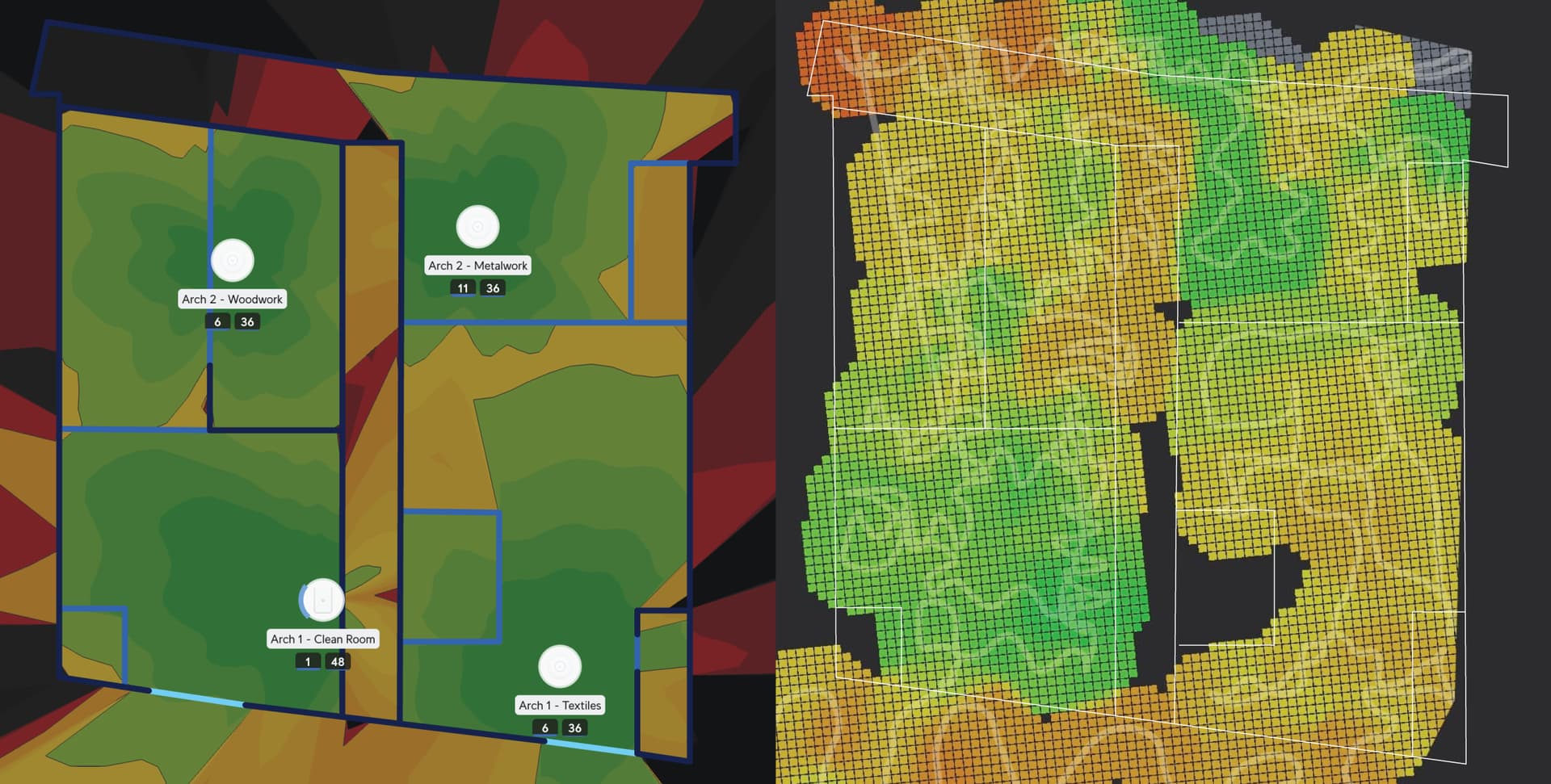

I did a quick wave of my phone in the Wi-Fi space but did avoid walking around that whole space.
Heres’ it with a rough sketch of the space on top, left is the prediction, right is the data from last night roughly matched to the space, bare in mind the SLAM algorithm isn’t perfect as I don’t have LiDAR on my phone so it’s using a camera and acc/gyro to estimate movement.
@trrh may have some spare wifi repeaters if its required?
We’ve been donated a new switch recently which I plan to put in Arch 2, replacing the smaller non-PoE switch.
That will clear up the infrastructure cabinet in there and leave a spare which can go over by metal work, from there I can run another AP through the snug (if I can find power for an injector).
That should sort out Arch 1 Snug’s dead zone, and then I need to look at setting up another AP out the front of Arch 1 which is a massive mission because of the bike area.
