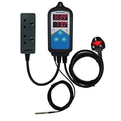

For some crazy reasons I will not anticipate yet I need to keep the temperature of a container with some liquid inside for 4 hours at 70°C , I already found the controller :
but I need the heating element, I have no experience in this , anyone can help me with that?
