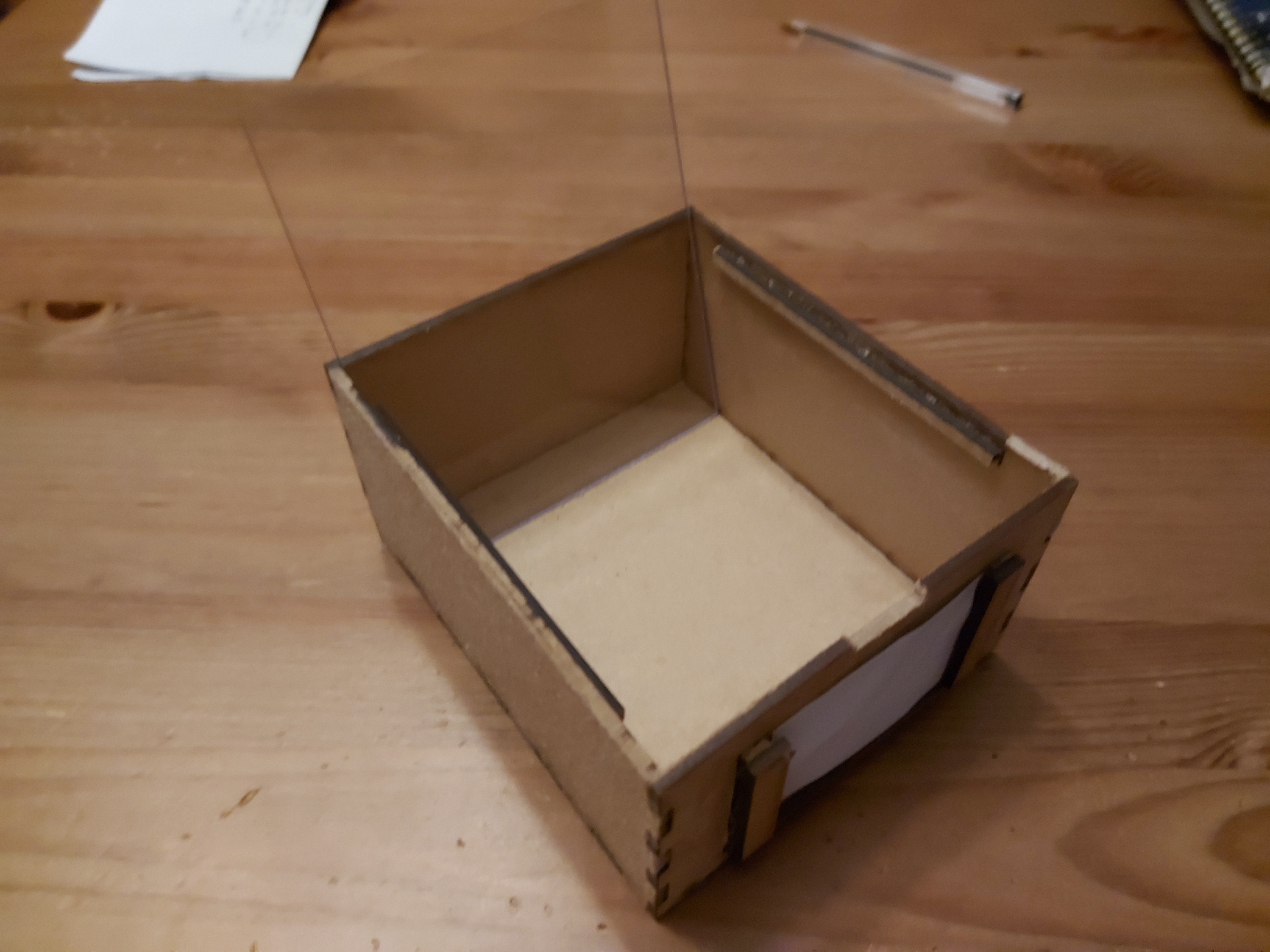

I’ve finished my first wooden box using 3mm hardboard.

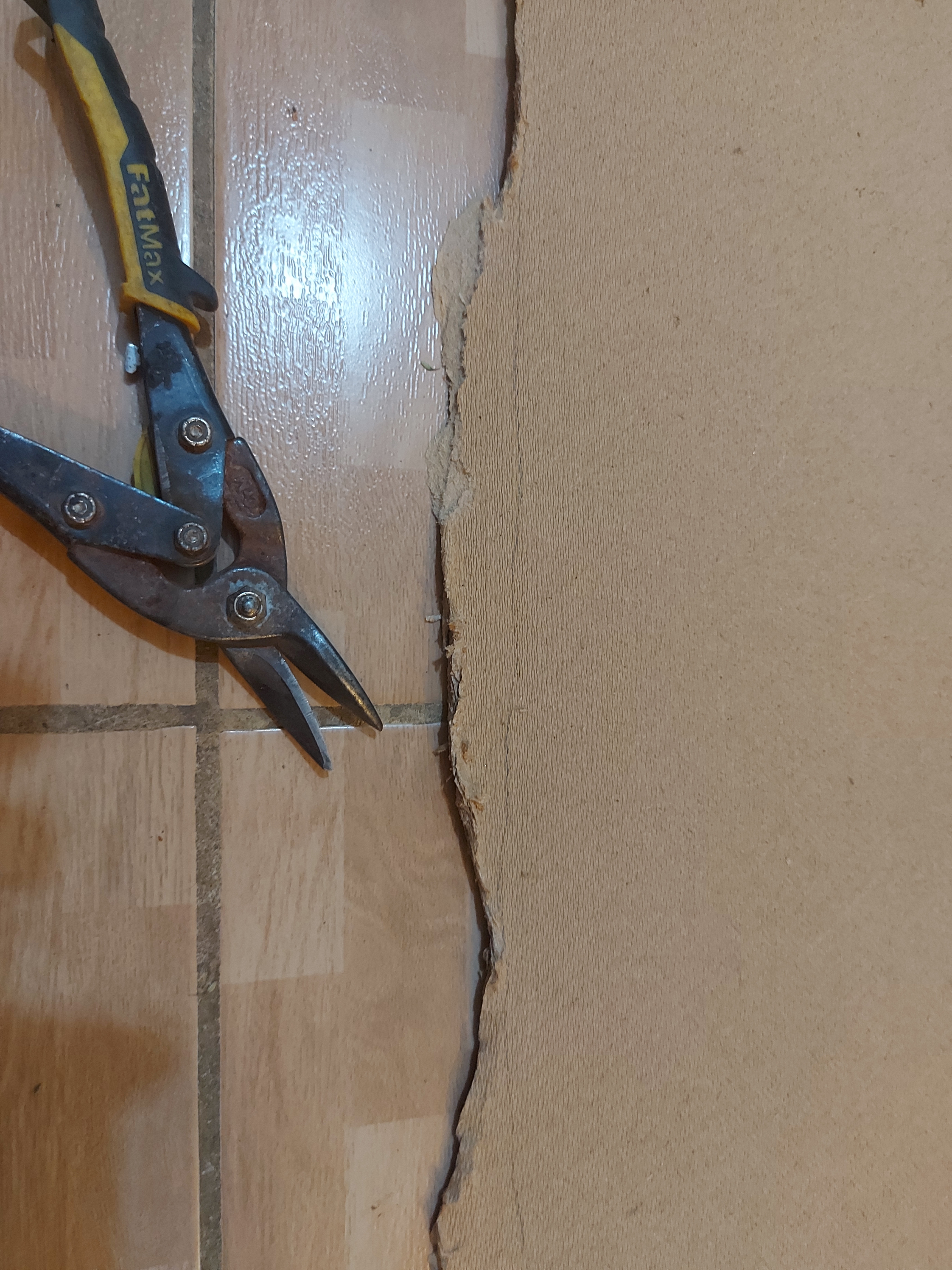

When I bought a sheet of hardboard to make this box, I had to cut the sheet in two smaller manageable chunks, and I’m not sure about the best way to do this.
I’m not talking about being in the SLMS or having power tools, but instead how would you cut a large sheet with manual tool just outside the shop to fit it in the car easily.
A hand saw could be possible (as long as the thickness of the blade does not increase), but requires more effort to cut through 1 metre and it’s not great without clamping.
I have used an old tin-snip, but it’s not great, it tends to curve the surface out of a plane and separate layers of the material.
I wonder if you have used a better type of tin snip or scissors or other tool that you would recommend for this task.
Thanks
