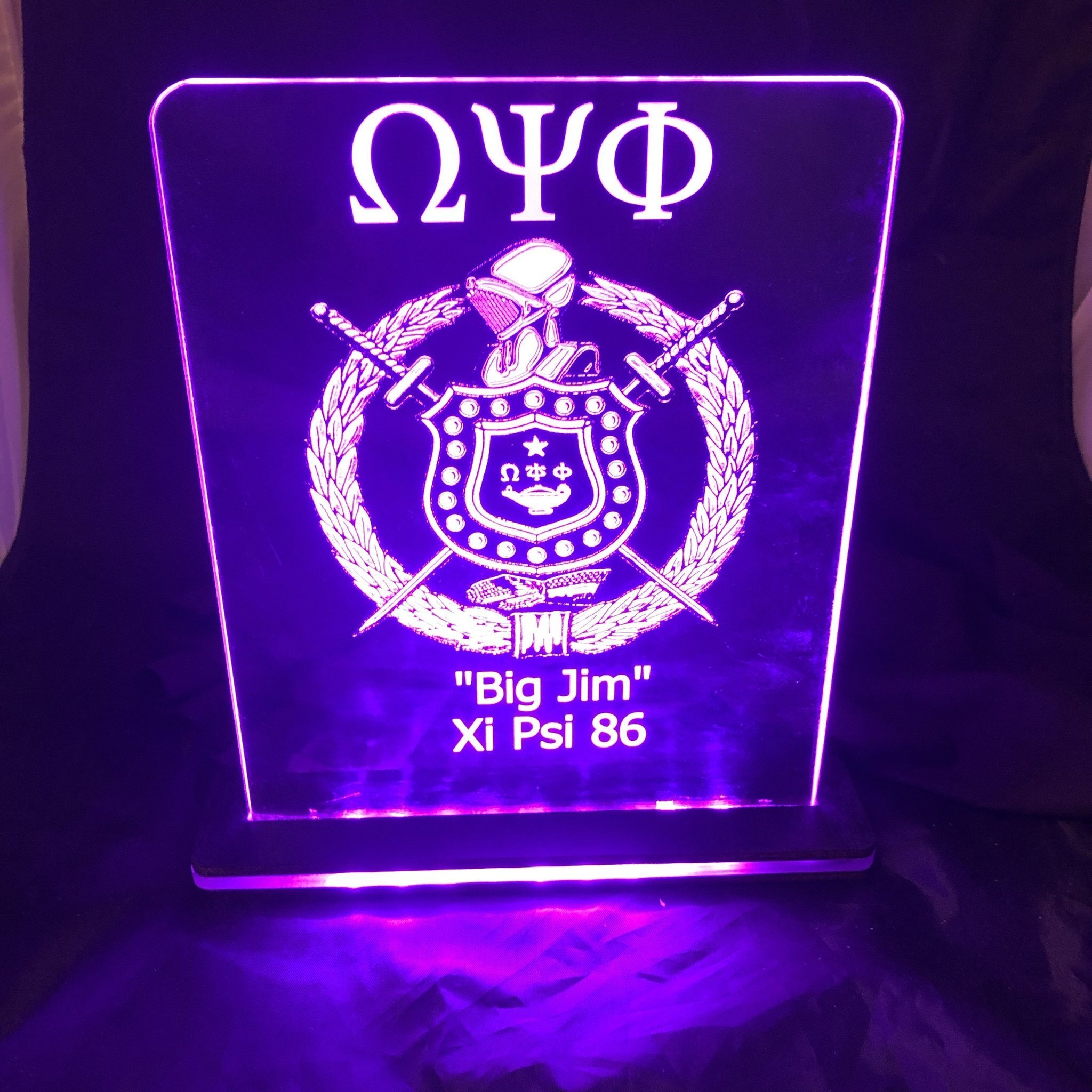

I’d like to make a case out of acrylic pieces. I plan to laser cut 3 pieces that can be stacked on top of each other to make the case. I however do not know how to bond them together (not sure if screws or glue is the right way, I’m open to either).
Anyone have experience creating cases for stuff? Here’s a sample of what I want to make (literally everything the same except the laser cut design for the part that lights up will be different).

However for extra strength you probably want to make sure there is some sort of physical tab/slot arrangement going on at the base if possible (work this into your cut/design) as this will be significantly stronger than sticking/gluing flat surfaces together.

You need this kind of bonding as any other kind won’t have sufficient strength. That 3M tape will not last long, in fact I’d be surprised if it worked at all when used on the end of a sheet.
In particular, with a large upright panel like that, you’ll get a fair amount of lever force working on the joint.
If you use a thicker sheet for your upright section, you’ll get a larger surface area to bond. You will see a commensurate increase in weight though.
You could cut a strip to be fixed to both the horizontal and vertical sheets, and affix it behind so it’s less obvious. You would really increase the surface area of the bond, and hence the strength.
