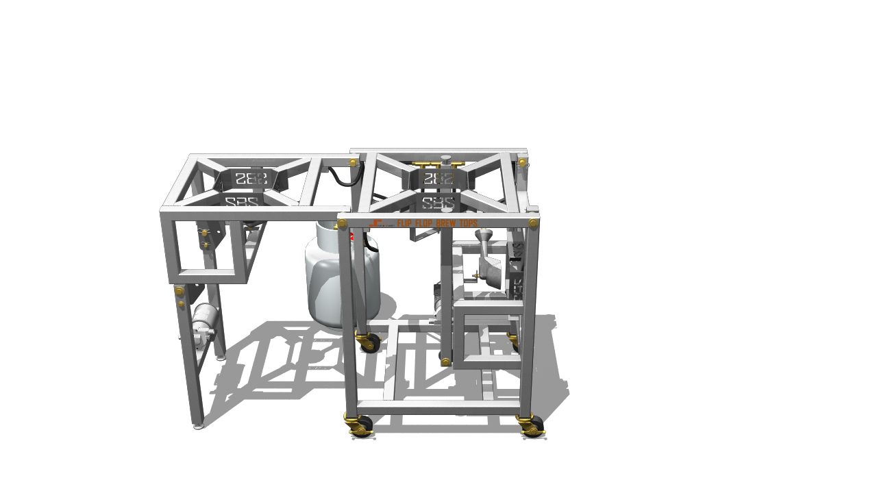

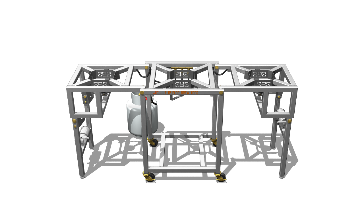

I saw in a few other topics that some folks around here might be homebrewers. I’m looking to build a new home brew stand for a single tier setup. Ideally it would look something like this. More likely it will be a wood and steel combo to help cut down on costs and make it a little more original.
Any input on the design would be really appreciated.

I previously had a tiered system but moved to a single tier to clean things up and in attempt make things a little easier to monitor. I have all the hardware (chugger pumps, quick releases, tubing, etc) for a good quality single tier. The design I found was perfect because its compact, all the hardware can be mounted onto it, and it’s fairly clean looking. I’m currently working from a HERMS setup so I don’t necessarily need the middle burner but I kept it for the stand in my previous design.
This type of metal might allow me to make a similar design to the one I showed at first but I think it risks being to flimsy if I want the collapsing design.
Kee clamps or pipe fittings might work for you. Plus they’re dead trendy for furniture at the moment!
This might be the prefect thing. If i can come up with a compact design using these pipes then I’m sold on the idea. I’ll probably draft something up tonight.
For those interested in the progress. I’ve decided to go the kee klamp route. Hope to have it completed this week with the pumps, filter, flow chiller and burners mounted. Then the beer can start flowing.
