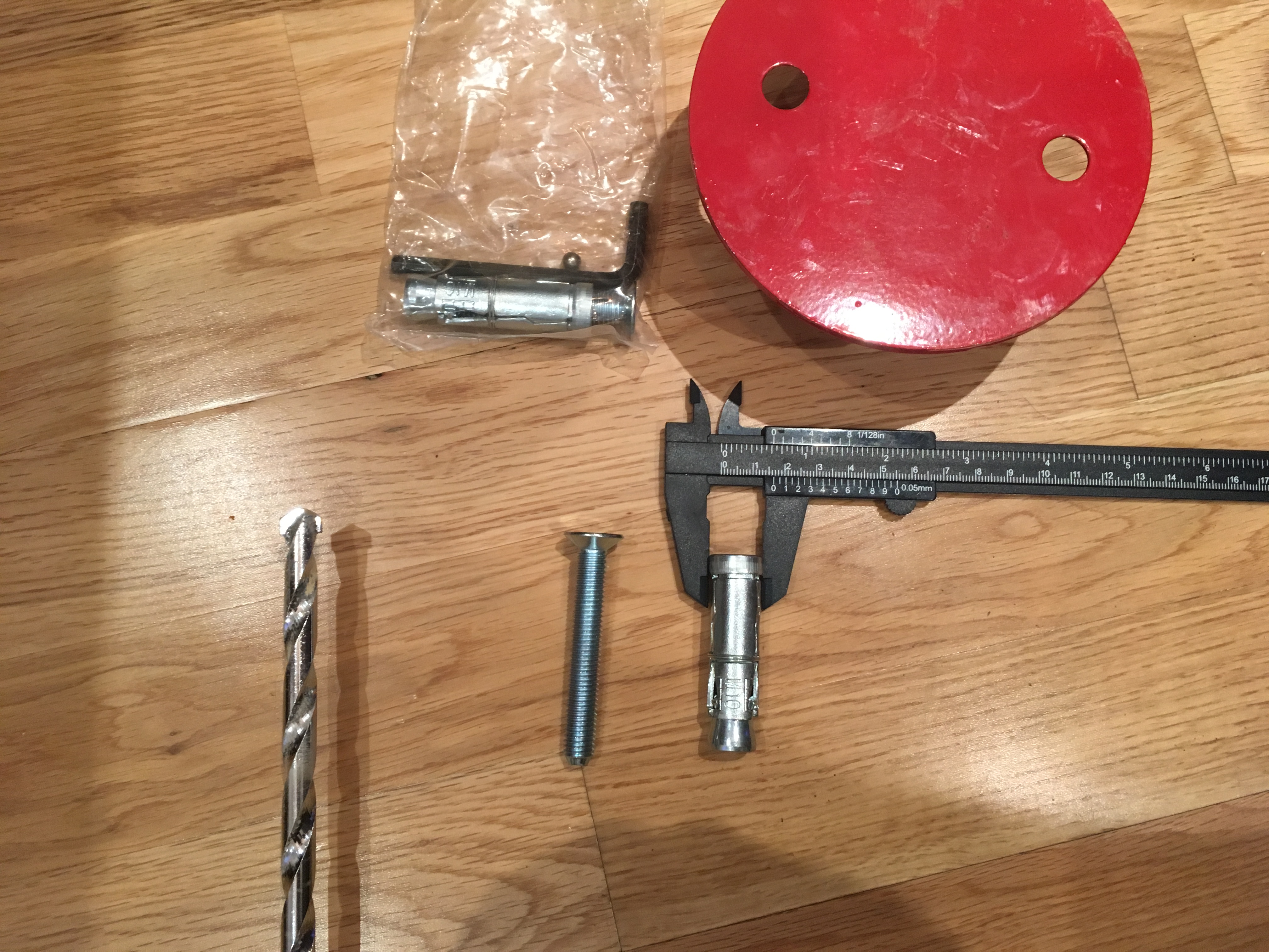

So I buy a ground anchor after about 5 years (yeah yeah), I dig out my BIG drill bits. It’s not big enough.
Does anyone have a (looks like I need a 16mm?!) masonary bit? A 15 might do. I need it for about 10 seconds to make my pilots bigger.
NB I have not used these bolts before so if someone wants to correct me then great news :slight_smile: it’s an M10 expanding bolt. (I thought that would be the hole size but my backup vernier tells me otherwise. How embarrassing).
Should be one in the box in the back
Measure the other end, usually that piece you have the vernier on sticks out and the other end goes in the hole and expands.
15 or 16 is right for M10 depending on manufacturer and the wall
