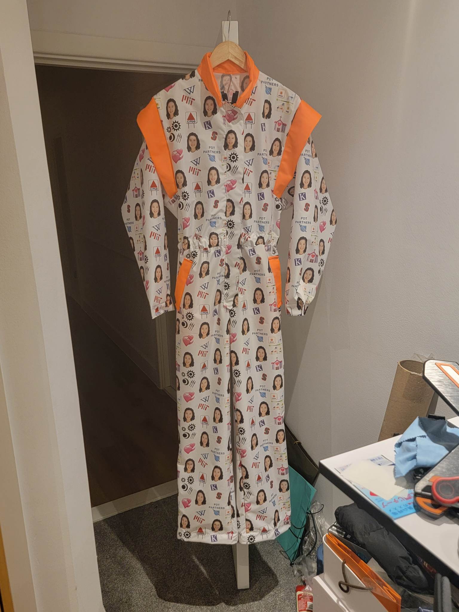

Small project update (thanks for the help!)
My test sew (in my own size) went well. My local fabric store sells some ripstop fabric which is great to know, and I ended up using Contrado for the final fabric.
It’s definitely not cheap (£29/sq meter) but paying £170 for the fabric is still better than paying £450 for a ski jumpsuit that isn’t even customized.
Contrado’s test prints were pretty cheap (just a couple pounds for each test on the fabric I wanted) and came really fast. The sample prints and my full four meter order all got shipped next day, which is fantastic.
I’m sewing it to fit over top of my friend’s existing ski gear so that if it starts to fail, he can just remove it and not waste the ski day. So I think I’ll possibly flat fell the seams but I’m not super stressed anymore about them being extra waterproof for this situation now. (And if my friend wants me to waterproof it fully or insulate it, I can take some seam rippers to it and do that afterwards)
Worked really well, successfully made my friend the center of attention on the slopes! If anyone in the future reading this wants to borrow the pattern LMK and I can share learnings.
Wow! Looks awesome. Very well done!!!
It looks brilliant
