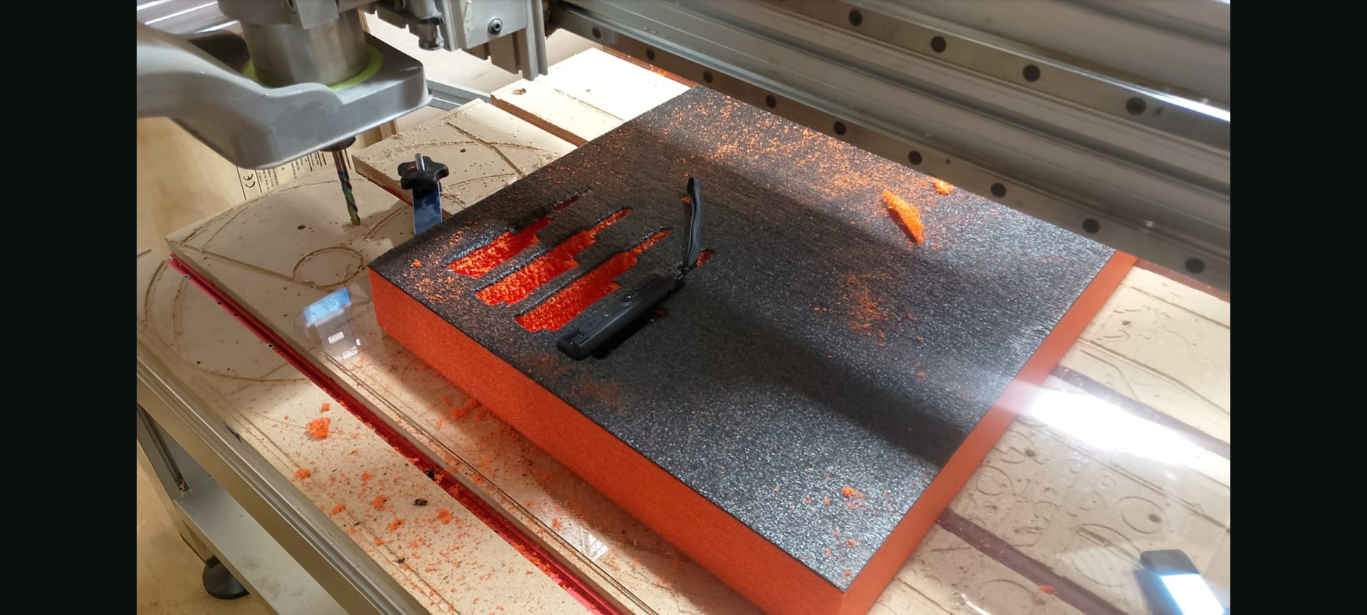

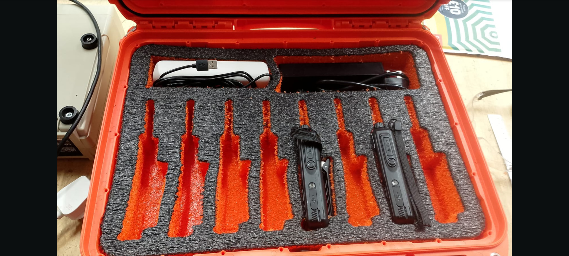

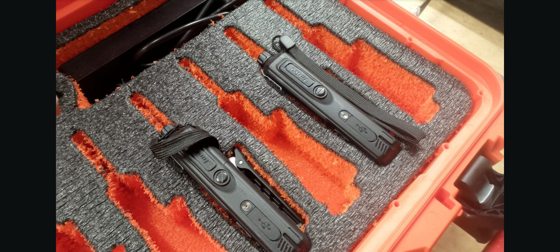

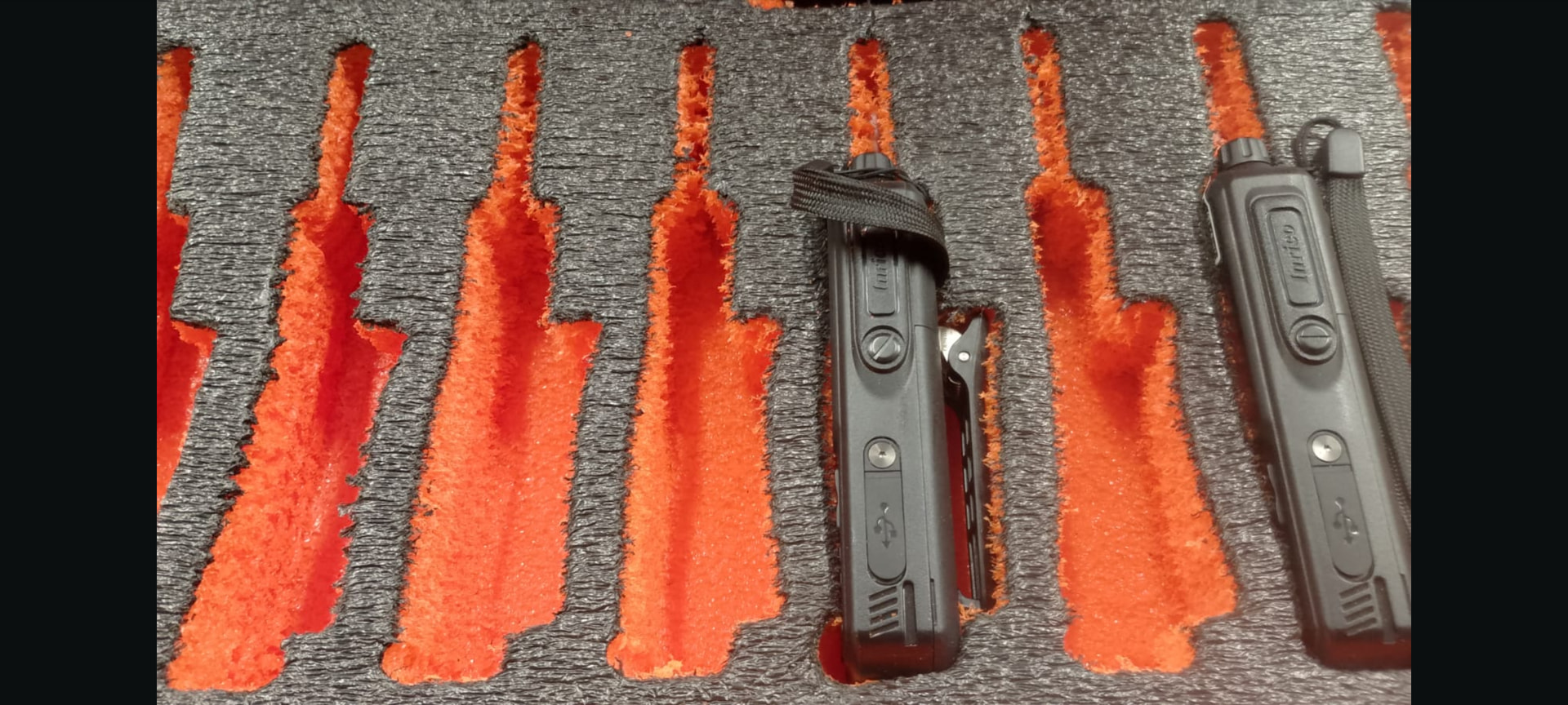

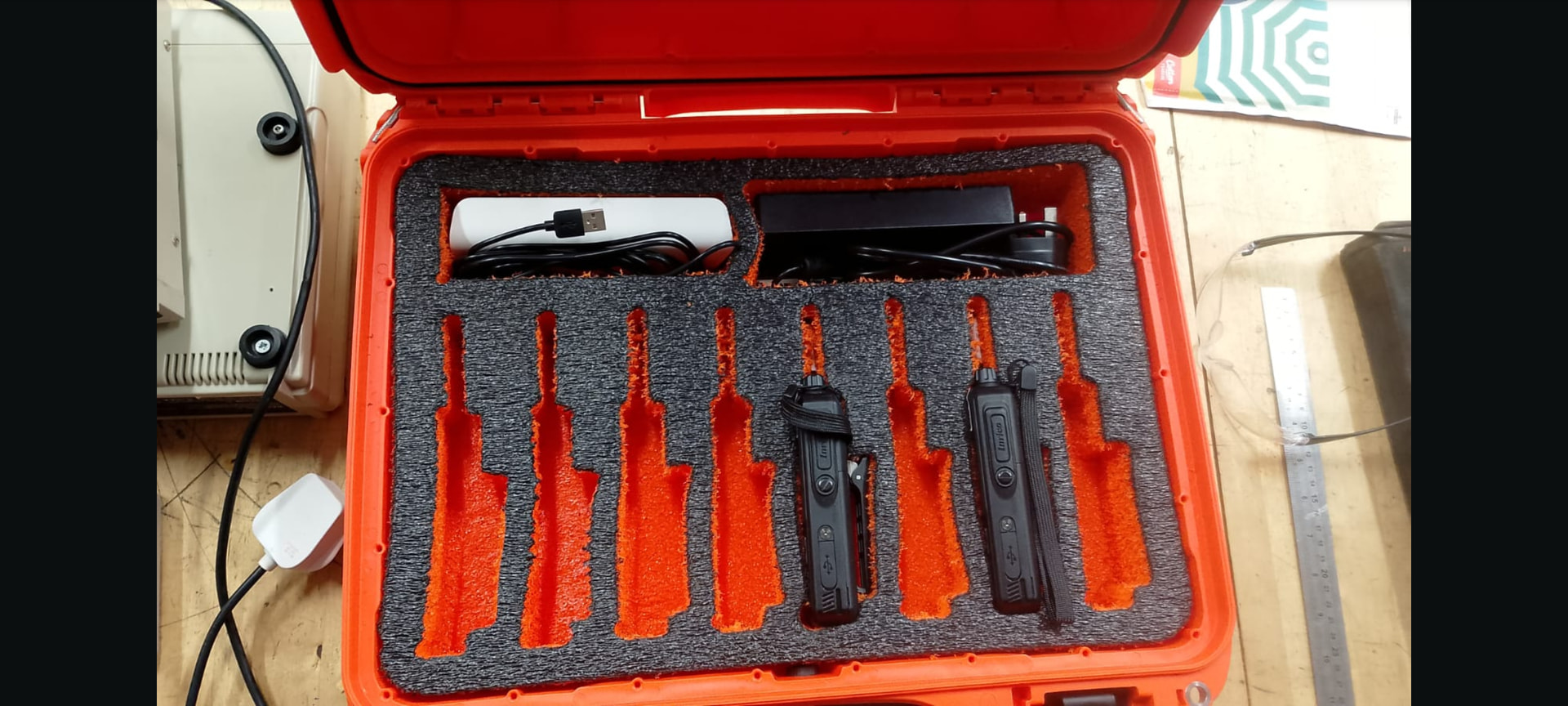

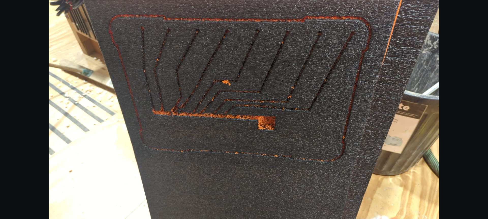

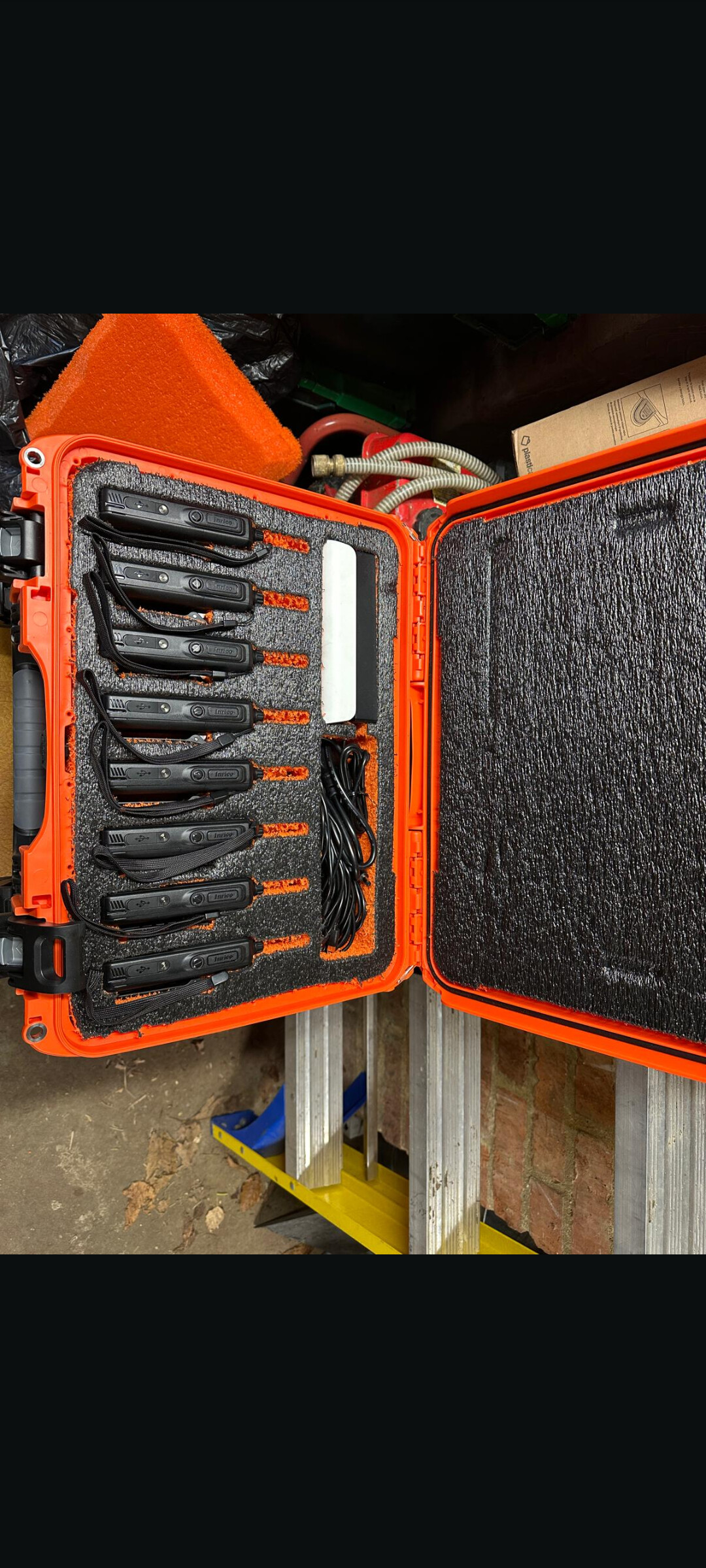

I have tried, and somewhat succeeded, although not perfect
CNC on shadow foad
Huge thanks to @Federico for the massive help even in remote assistance!
