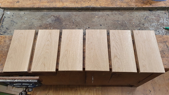

The planks as they were provided:
Cut into shorter planks:

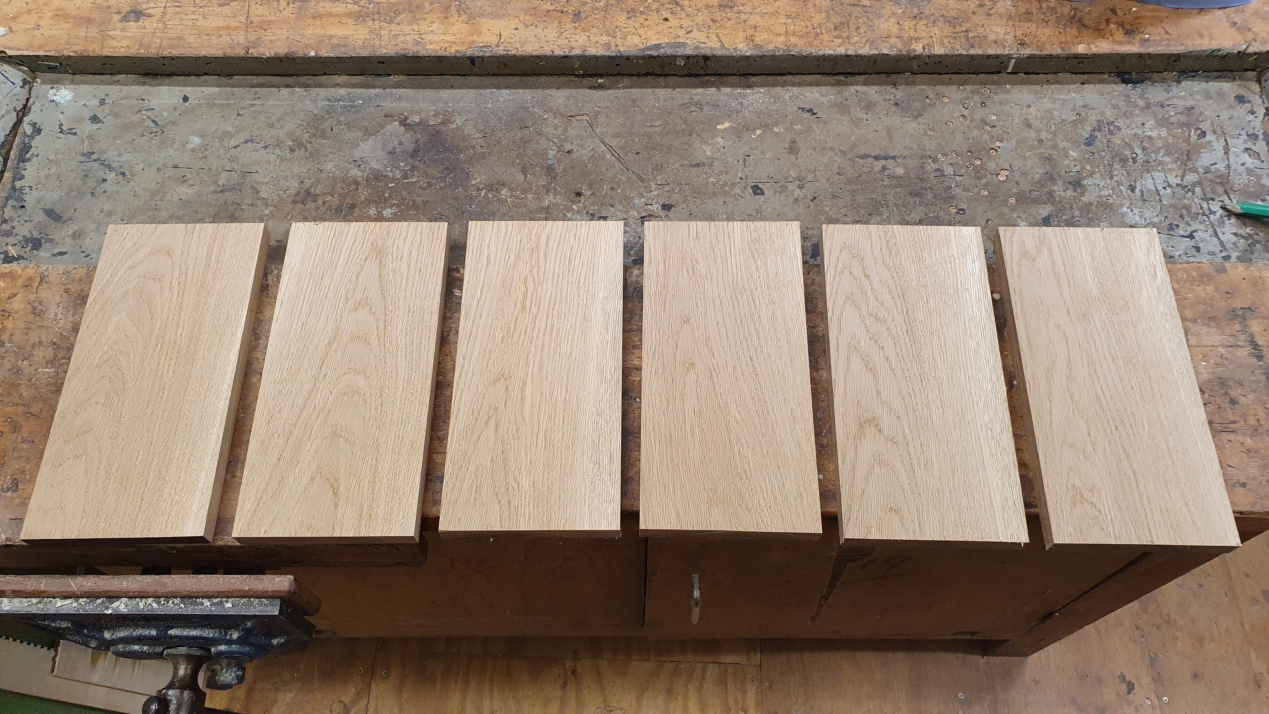

After havingdecided how the grain will look once jointed and creating the loose tongue and groove:
Allowing the glue to set:

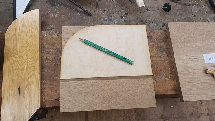

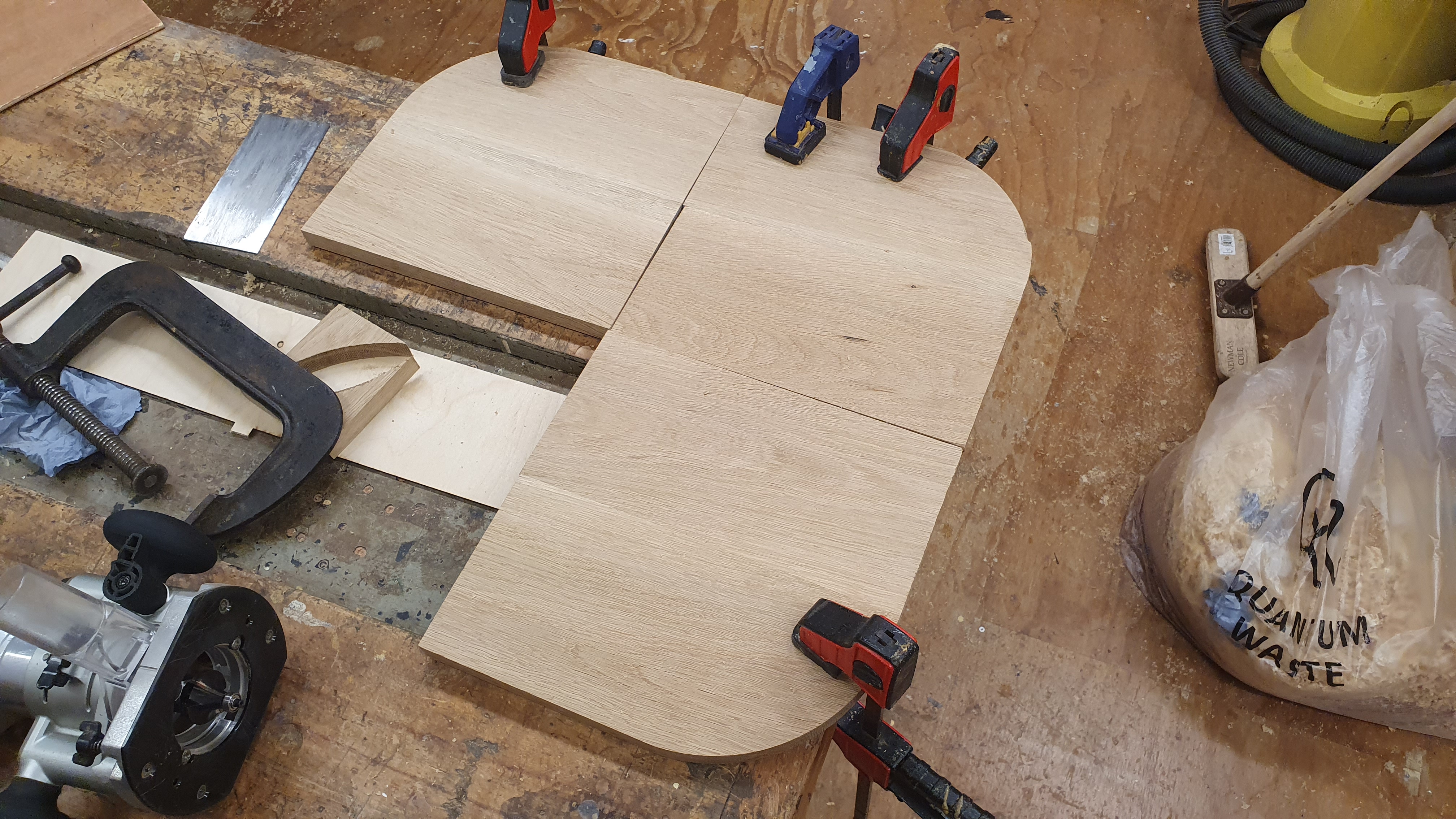

Using a lasercut jig to sketch out the perfect radius curve I was looking for:

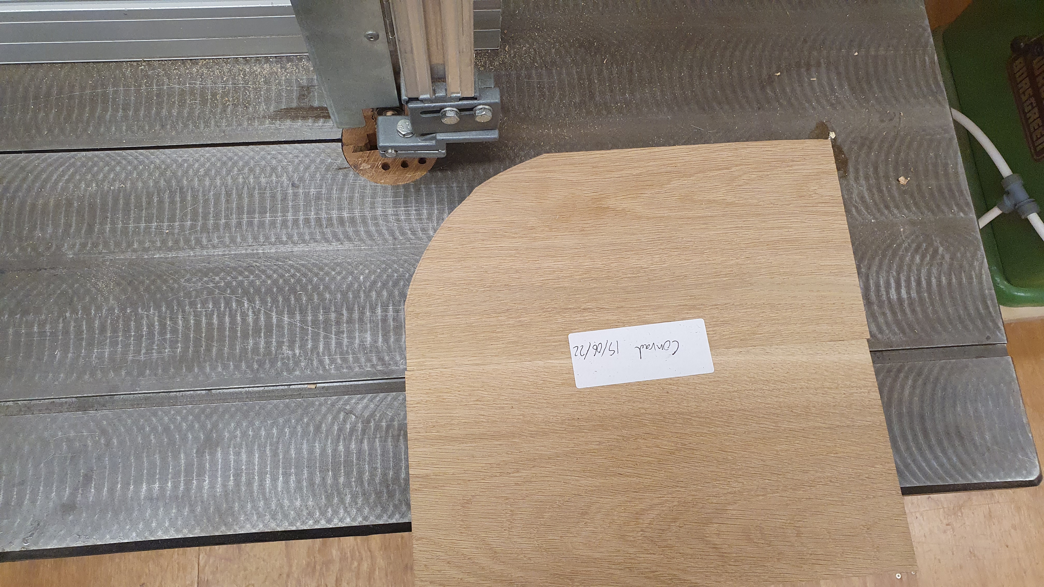

Rough cut on the bandsaw to remove excess wood:

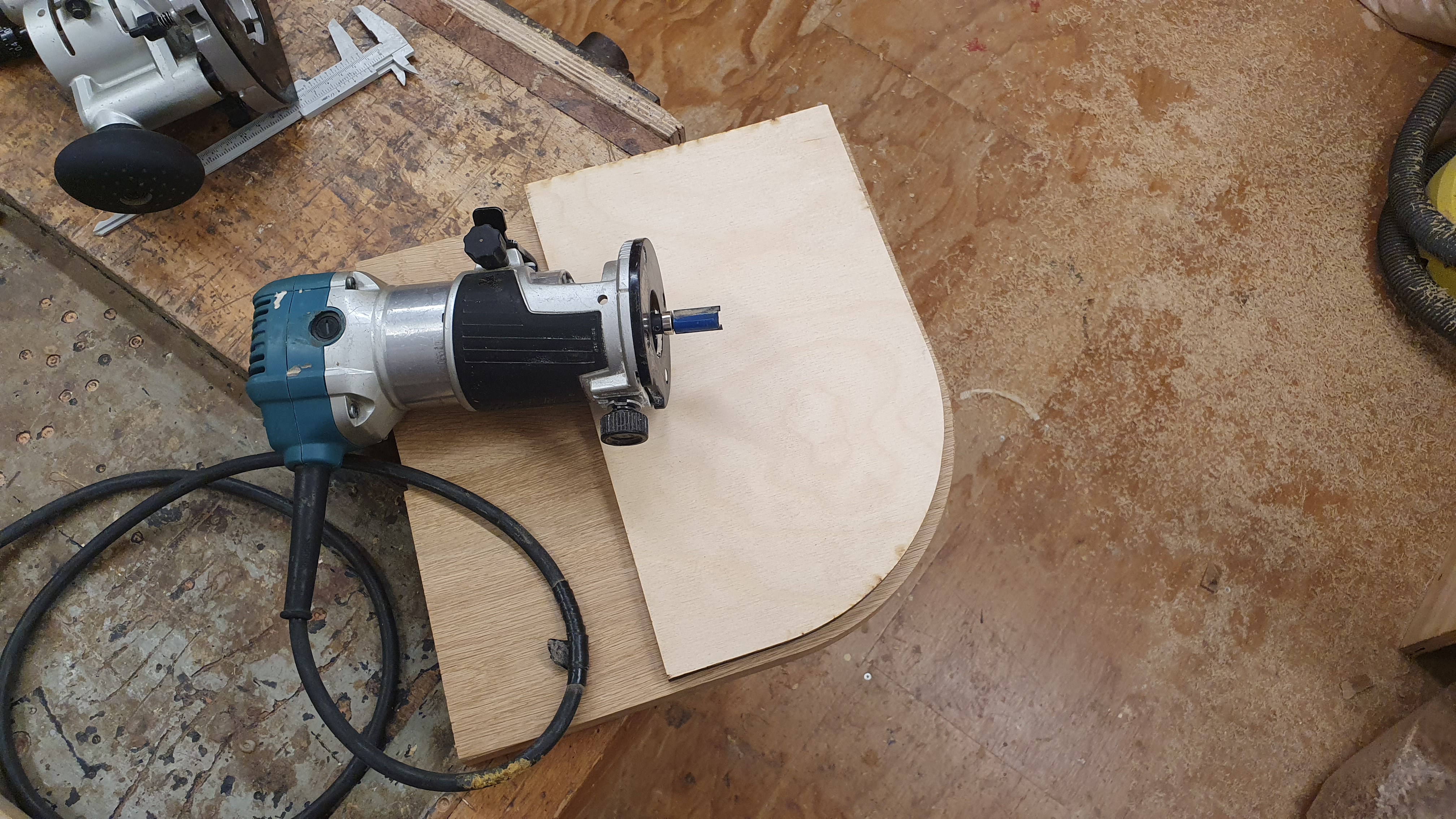

Cleaning edge with the router:

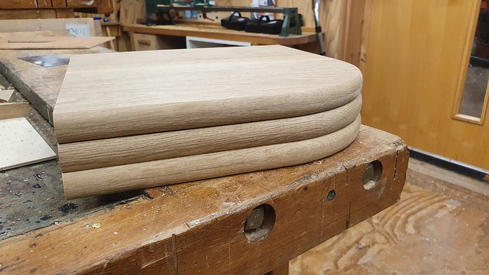

Second pass on all edges top/bottom with an ogee router bit (wish I had taken a photo of the actual process):
End result of gentle rounded edge on all three shelves:

Hi Conrad, I’m planning on making a floating shelf too once I get inducted to the basic woodwork.
How did you make the rounded edges?
