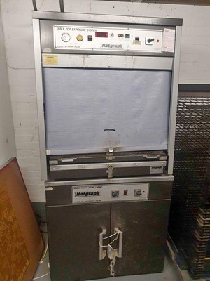

Was looking at stuff like this…
@silkscreentechs? Look good, maybe we start the pledge drive…
What Sam is offering is a size of UV tubes that would correlate with the size of our biggest screen. Just last year when I looked I to it with @jackL there was a full sized natgraph for £500, we can wait this out OR build one. But up to screentechs I suppose. I am just a humble turner.
Yeah I think we need 500-700 for a good used unit. Even building one would cost a few hundred at least and take a long time. If we ever want to sell it, the Natgraph type unit will keep its value, a DIY one will be next to worthless…
I think we should buy one…
