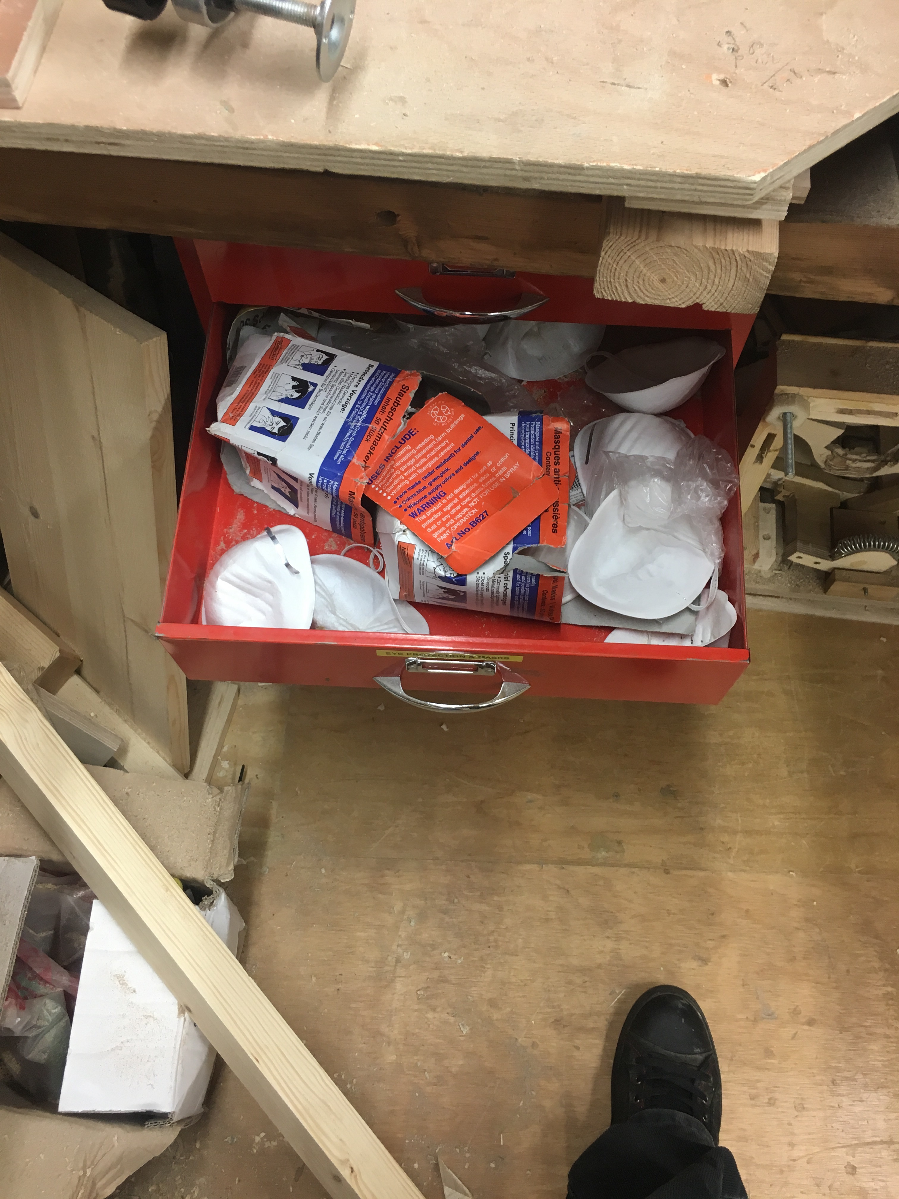

Dust masks
Dust masks kept in draw with dust in it
There were none that didn’t have dust in them.
There all in the bin.
We don’t have any dust masks now
Couldn’t clean them? Was it that bad?
If they are not salvageable at all I’ll place an order
We should have a sturdy sealable bag to keep them in maybe?
Should we keep the dust masks outside the woodshop? In a box on the wall by the door for example?
For the record, none of these are dust masks: they are irritation masks, good for keeping grass cuttings out your mouth and that’s about it. It has been on my mind to consider getting some IP2/3 masks in to the shop for a while, although in the intro woodworking session we encourage members who are doing lots of sanding to bring their own. Point well raised and I will look at getting more ordered so there is a supply in the shop.
FFP3 are the only ones actually suitable for MDF on occasional use
There where only a few masks in the boxes, most where out in the draw. But the draws full of dust and there was dust inside all the masks.
Didn’t seem possible to clean.

The ones you photographed are kind of single use, but sounds like they were FFP1/2.
