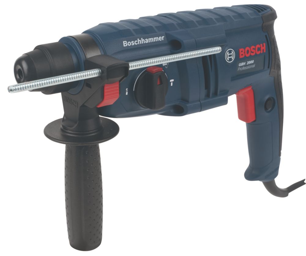

I’ve got one of them it’s a complete Beast, is probably a bit much for most jobs
This Bosch is a more sensible size
I haven’t checked those 2 but consider getting one with the feature to disable the rotary action, which is useful for demolition work.
I’ve found Bosch products are usually of good quality but Silverline/Silverstorm(?) make something similar for less debt notes.
