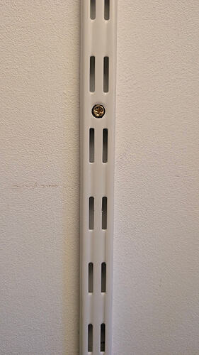

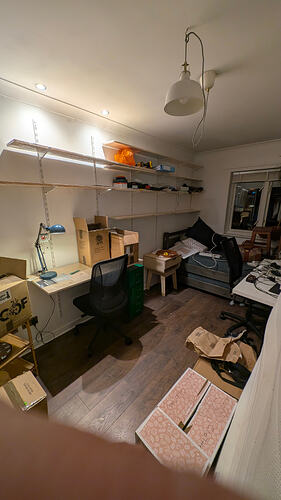

My goal is to put these twin slot shelving units up on my wall, they’ll hold a lot of books and hopefully a desk so about as much weight as you’d expect to put on these things, + cylical loading / unloading of someone leaning on the desk perhaps.

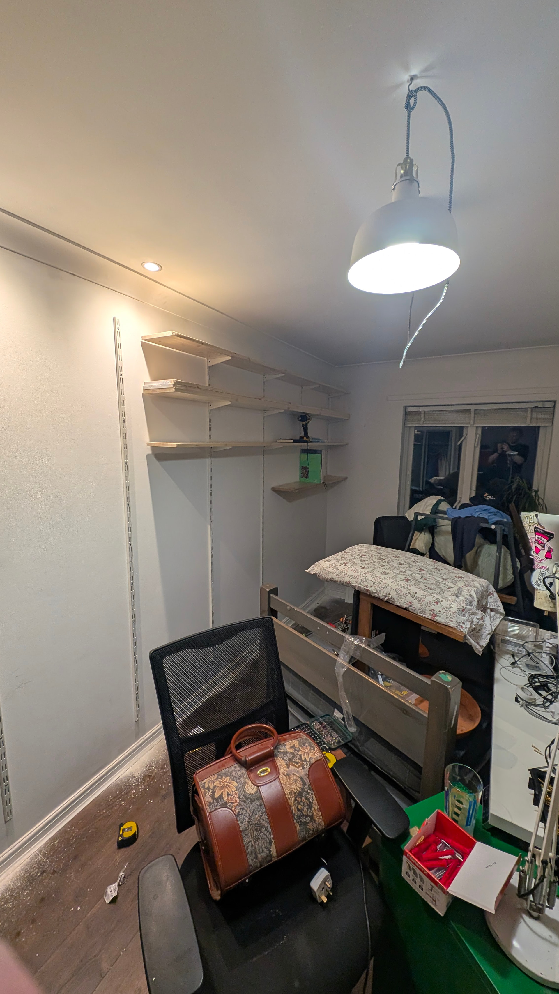

I had assumed (wrongly) that this wall would have wooden battens, and approached it with that mindset. I did purchase a stud detector, which I’ve since learned is more of a density detector. I tried to find the studs, but they seemed inconsistently placed, of varying thicknesses and the detector didn’t find a continous stud vertically… I put lots of holes in the wall anyway though, as I wanted to progress the job.
Something wasn’t sitting right however, as none of the dust had any wood particles, a number of the drill sights went through the inital plasterboard then immedaitely gave way suggesting a cavity rather than the batton the detector told me was there. As the wall is exterior, in a 92 build house I learned from chatGPT it’s most likely to be DottAndDab.

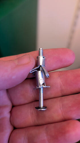

That’s okay i thought, i have plenty of fixings, i ordered some dott+dab specific fixings, put two in per batton (50kg rating each) and a number of the other metal splay fixings that you pull out with a gun.
however, with the added depth+cavity of the metal batton (a U shape with the two arms of the U pointing at the wall) the action of tighenting the screw has pulled some of these fixings out until it hit the bottom of the U and only then do they stiffen up while tightening.
Some of the fixings as well just don’t seem to have worked, as the screw definetely threads, i can feel the resistance and I can’t pull the screw out the wall with plyers, but it never stiffens or tightens, just constantly spinning.
Some of the fixings have worked as I expected them too, and become very tight.
How many do you think I can get away with that have potentially failed? Have the ones where the screw is spinning definetely failed? Is this project too risky to put on a DottNDab wall to begin with, even with good fixings?

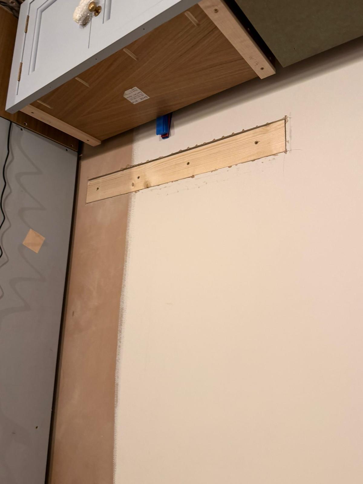

  • Fix a patress to the solid blockwork behind - cut back the plasterboard the width of the U shaped upright, fix a solid timber or ply patress to the blockwork, then use this as a solid fixing point for your screws - effectively eliminating the void behind the plasterboard (pic below for reference)
With regards to moving this shelving set up to a more solid wall, this would of course be the most secure and safest way - it’s easy enough to refill, sand and paint the dot and dab wall you’ve drilled into. But if you’re set on using the dot and dab wall and willing to spend the time and effort reinforcing the fixing points where the screws are going, it’ll still be a solid construction.
