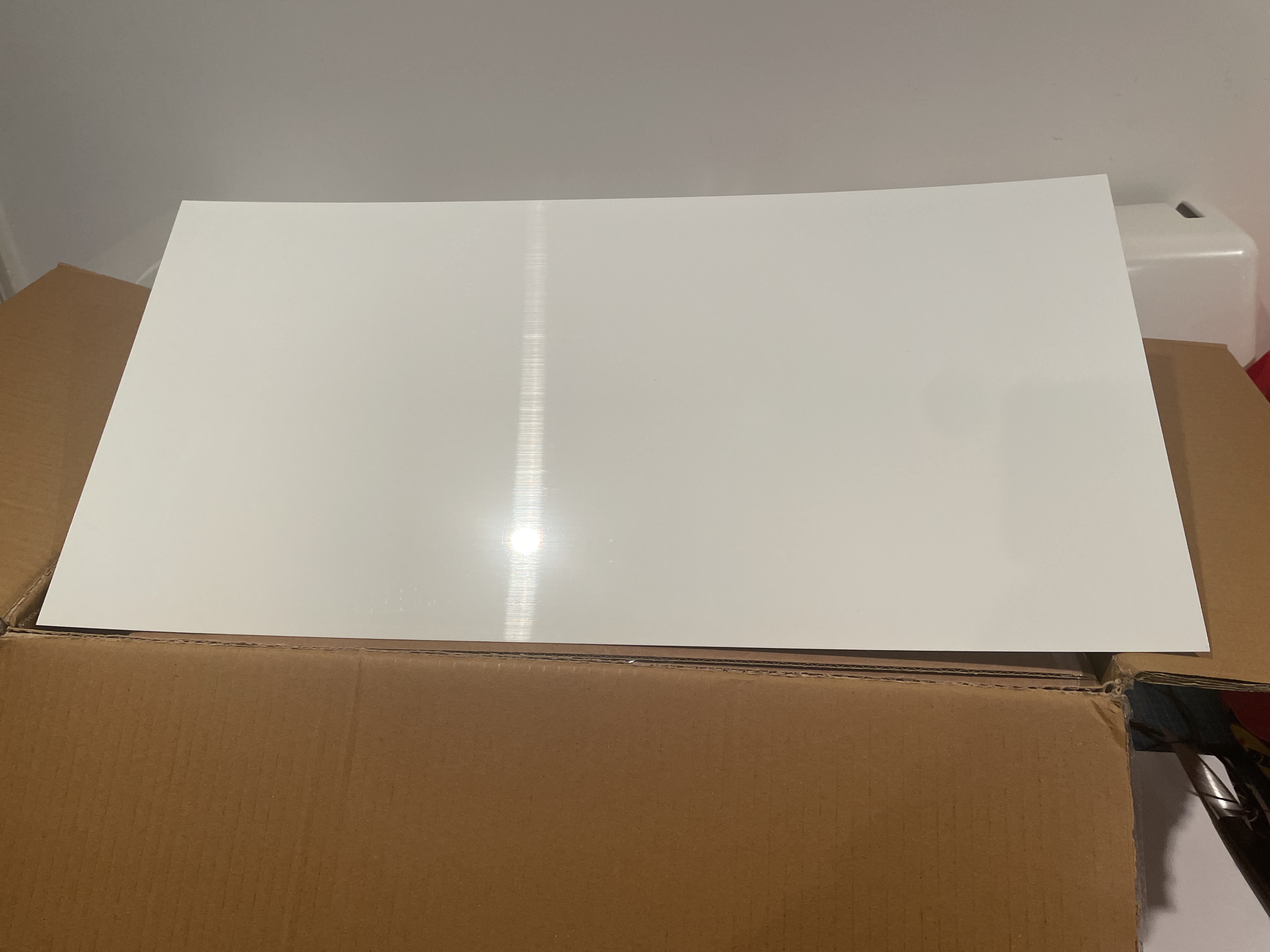

@metaltechs do we have a tool that can cut thin sheet metal? I have an aluminum sheet 610x300mm 0.5mm thick that won’t fit in the small CNC and I need to cut it down in a way that will keep it pancake flat as the white part is to be sublimated onto with the heat press, so I cant use sheers. Any suggestions?

what is that white finish? If it’s a protective adhesive film, then either nibbler might clog a bit if you don’t remove it first.
If it’s a ‘paint’ of some kind, probably ok. Proper ‘aviation snips’ (shears) leave one side of the cut flat, depending whether ‘left’ or ‘right’ version is used. Do we have any of those? (I lent mine to someone a few years ago and haven’t seen them since!).
